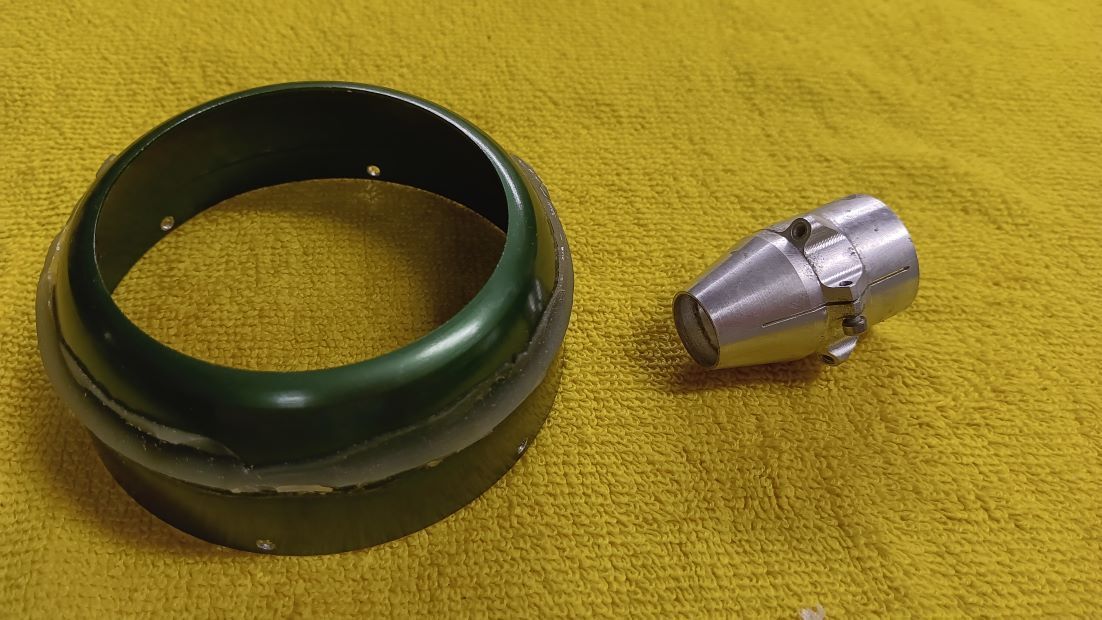

I found an electric jet starting motor with bendix attached already at DreamWorks RC, I'll just make a new nose housing that I can mount the start motor on to and integrate a FOD screen. Honestly, in the very little time the motor has operated the compressor has visible discoloration on the leading edges, presumably from whatever dirt and grime is in the air. These screens are clearly advised.
Ted

Thank you for the info (I had no idea its an MW54 knockoff) and the offer. I'm mostly done designing in CAD a new motor cap and starter motor holder, so if it doesn't work out and I give up (rather possible) I will take you up on that offer, it is truly generous of you. If its an MW54 clone, my understanding was the MW54 had multiple compressor options. I wonder if a simple compressor update would net me some extra thrust....
Ted

Good news, bad news. I have the starter mount & the front cowl but not the mounting legs.
The Wren 54 mounts the starter to the inner cowl section, the Wren 44 to the front cowl (as I have one of those)
but this cowl has no holes where it would have mounted.
The legs appear to be machined from one piece of aluminium with a male thread to screw into the starter holder
at the top & threaded holes in the other end for the mounting screws.
Let me know if you need it, another reader has PM'd me to say he will take it if you don't.
