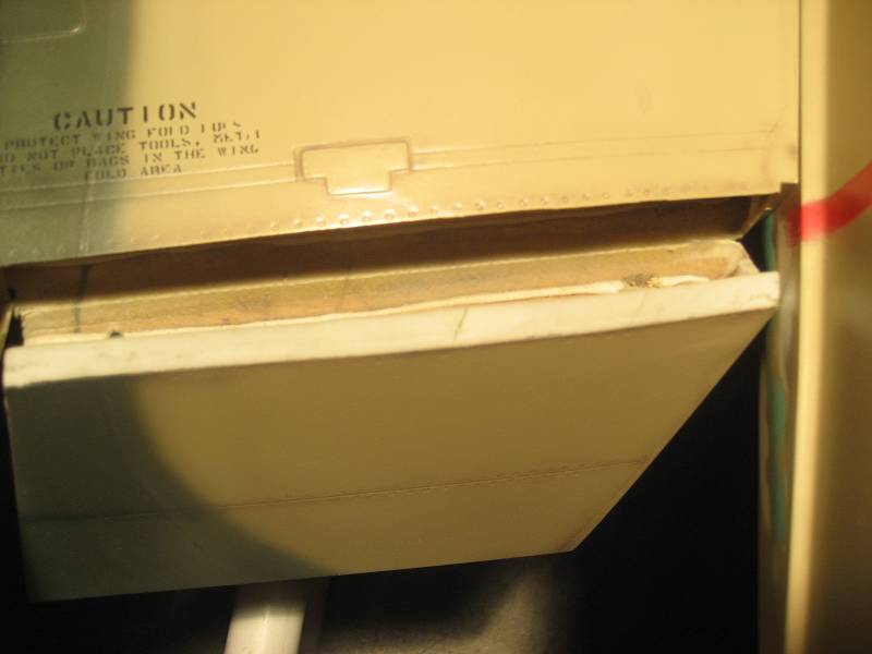

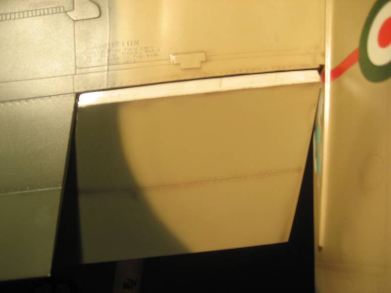

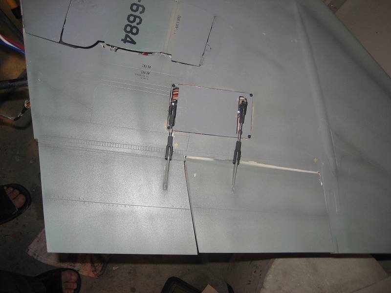

Hi everyone,
Regarding the flap movement issue, I did replace my control horn with one cutout of .125 CF plate and its rigid as can be. However it didnt fix the problem. When I investigated more, I realized that the movement has nothing to do with the servo arm or servo issue, It is actually the hinge surface at the hinge line. The hinge line is on the servo side, opposite of the aileron which is away from the servo side it can result in hinge line surface to flex. I can easily move my flaps as far as 1 inch up and down (total) with exerting about 4-5 lbs of force.
I have not maiden the jet yet and wanna make sure I dont crash it. IF anybody else has seen this issue on their SM F4, could you please let me know if its common and could it cause a problem. I have attached some photos so you can see the hinge line on the flap. Maybe Anton or Li can comment on this. If there is a way to reinforce the hinge line, can you make some suggestions if its necessary.
BTW, on the throws, I am only getting about 45mm total travel on the elevator. Its not possible to 60mm each direction. plate intereference. (which is about 13 degrees up and down)
Jason

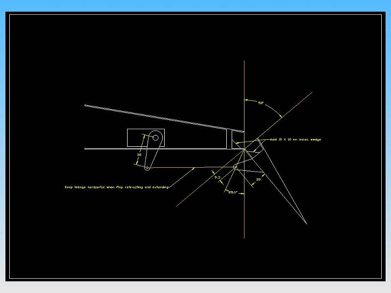

Old 01-27-2008 | 01:35 PM
  #658
My Feedback: (55)
Joined: Mar 2005
Posts: 174
From: Mission Viejo, CA
Default RE: Skymaster F-4E phantom
Here is the response I recieved from Mr. Li Kai which demonstrates the solution for this issue if any one you having this problem. I thought its an elegant solution and I should post it for all the SM F4 pilots to see. Thanks againg for speedy support from Skymaster crew, and Mr. Li kai.
I will make the modification and will update you guys as to the performance improvement.
Jason

Hi Jason, I recently built a BVM King Cat and the diagram as you posted is exactly what BVM has you do on the elevator of the King Cat. Seems to work well and I have not had any problems. Thanks for this post, I should be getting My SM F4 in 3 weeks, after their new year.
Kevin Marks

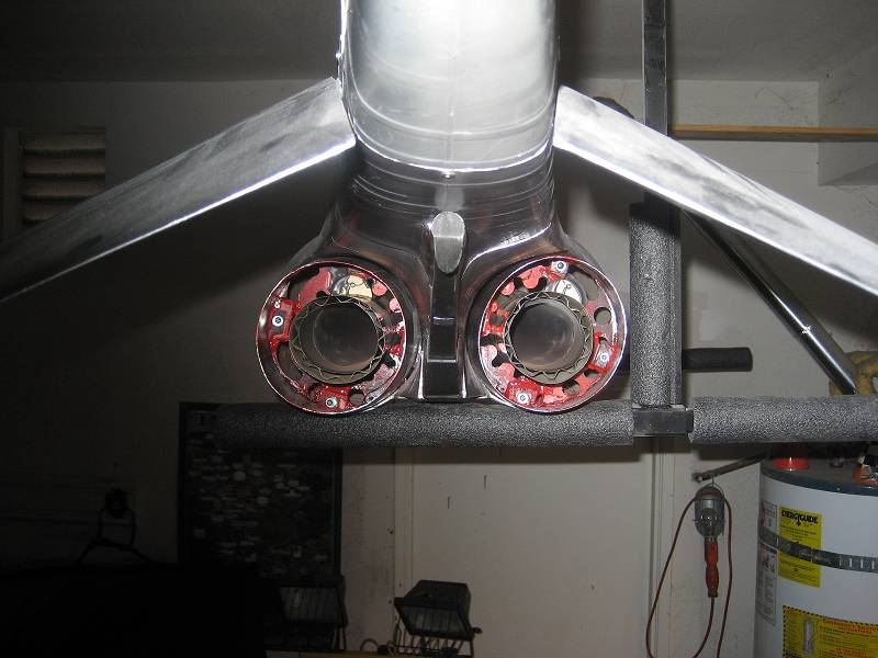

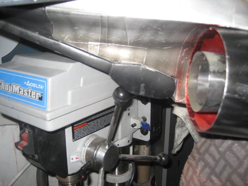

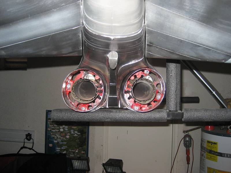

Gentlemen,
I have attached pictures of how my exhaust nozzle looks like. I am still in doubt if this is ok. I have started and reved up the turbine a couple of times, when its back to idle, the under tail and stabs do get warm. you can still touch it. probably about 80-90degF. However I have not maidened this jet yet and dont know how hot it gets in flight or will it be cooler. I am wondering if all you guys can check this photo and compare to your plane and let me know if you think it is ok or I shouldnt maiden it. What would be the fix if needs be. I am thinkin of removing some of the Plywood flange in the bottom and drop the nozzle down abit.
Also notice from the picture, thats the max up stabilator I am getting. If it turns out not enough, what is the best way to increase the travel, remove material on tail or somebody has better suggestion?
thanks for the help,
Jason

Hi Jason
your pipe looks OK don't give it any more down thrust as it will make it very unstable in the air with power on and you would run out of elevator, dont worry about the heat it is not an isue as for elevator travel you can dremel out a bit to give it abit more travel
around 50 mm each way is fine
what turbine are you using make sure you have 30lb plus hope this of some help to you
regards

Jason,
You don't need anymore elevator throw if the plane is balanced as per my measurements. I put over 50 flights on that plane and never ran out of elevator on the flare and had plenty to pull it around the turns even at full throttle.
David Searles

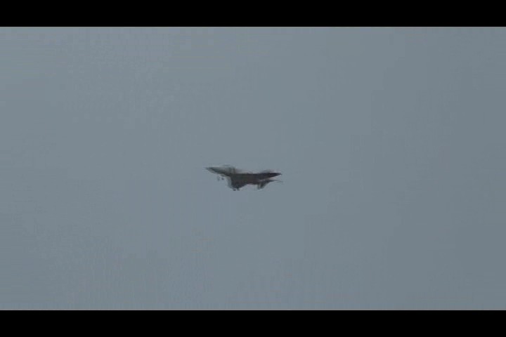

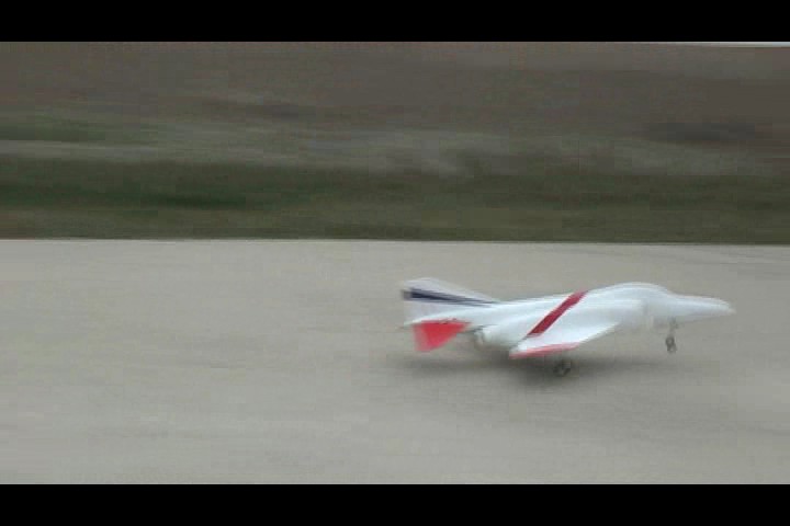

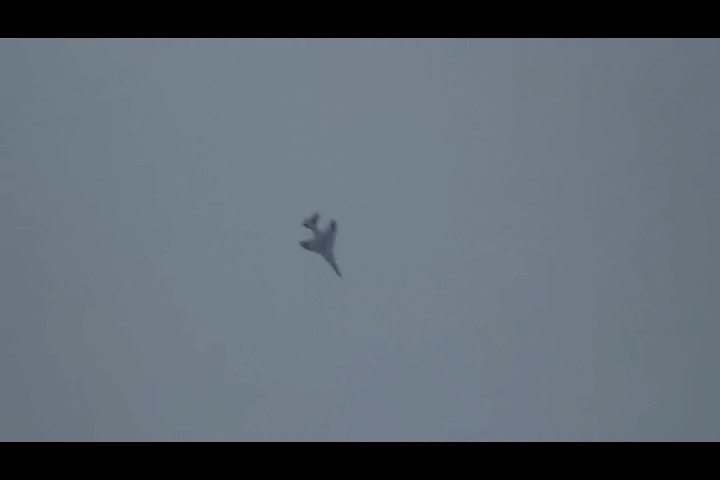

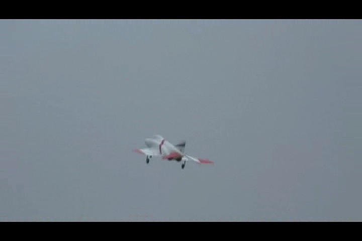

Hi, The F-4 1/9 prototype already finished the test flight on last month,
here are some pictures for maiden flight,
about the release time should be July of 2008,
Best regards
Anton
