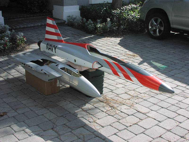

I'm just about done with my Lighning. Waiting on the gear which should be here next week according to UPS. Here is a pic of mine next to a Yellow F15 (approximately same size as Avonds) for scale comparison.
The fin is almost the same size as the F15 wing.
I own 5 jetcats and love them, but went with a Rhino for this one. It is the same weight as a Titan but I watched it put out 37.4 pounds of thrust on the Dyno.

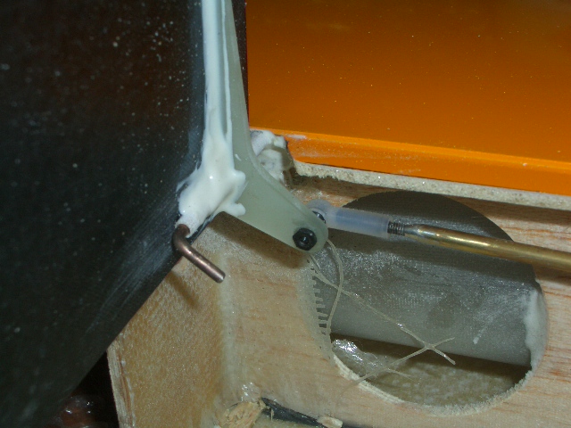

Looking good Mark. I have a modification to the main gear door hinge system. Attached are a couple of photos showing the mod....

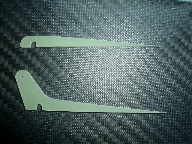

proof, if any were needed
ID:	522886   Click image for larger version

Looks like the stab has sheared at both sides of the fuselage from the photograph. Maybe a defective stab or a basic design flaw, surprised to hear the spar is balsa. I suppose the stabs on this size of model are getting on to be the size of a wing on a Savex L39 and subject to similiar loadings.
Commiserations to Rob on the loss of his Lightning so early in it's career.
