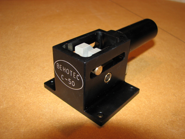

I just received a set of Behotec C-50's with struts for my new project and am very impressed . By far the nicest and most robust units I've owned . They make the Robarts look like they were made with a hacksaw and file. The main body of the retract is machined out of one block of aluminum . The action of the retracts and struts are buttery smooth with no slop. The struts are also damped as well as sprung.
Marc

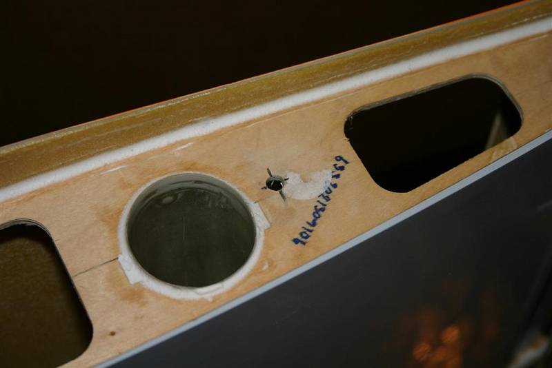

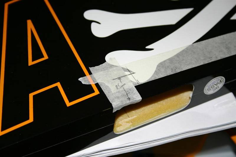

Got a couple of hours in at last on my Lightning. Started with some easy bits, well it's all pretty easy, so these are the really easy bits
Aileron mounts. This is a pretty cool idea. The aileron mounts are bolted to pre-installed mounts in the wings. Three bolts and you can whip the hole thing out! All you need do is cut the ply parts from the sheet and cyano them together. Be sure to make a left and a right!!! Then run a fillet of epoxy or Hysol along the joints to strengthen the structure. Simple as! Done!
Rgds,

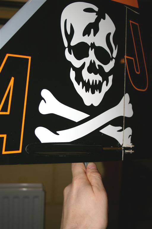

Finished off the fin and rudder too - this is dead easy too!! The only 'building' required here is to cut a slot in the fin for the rudder linkage! With an 8511 and a SWB metal arm, I found the centre line of this slot to be 25mm from the base of the fin. If you start there and open the slot up bit by bit you shouldn't go too wrong! The linkage was setup and then the supplied fairing simply glued in place with some 10min contact adhesive I use for my foamies.

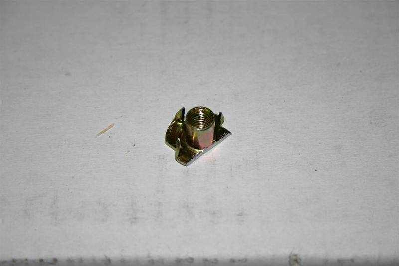

Also, got the wing bolts in place. It is very important that you drill the initial hole in the ply wing root where it says in the manual. It may seem odd at first but if you don't you will not be able to get the wing bolt, door ram and wheels all in place so make sure you follow the instructions! You may find that in order for the captive nut to sit flush on the ply plate you need to cut off the front part but this is probably the most 'fiddly' thing to do in the whole build
Standard process really. Drill the root rib hole 6mm. Slide the wing on the tube, mark the centre point on the fuselage, remove the wing, drill the hole in the fuse 7.5mm, refit the wing and use the bolt to pull the captive nut into the ply a little before removing everything. Now, simply pull the captive nut into place using the wing bolt and some strength! I found that two large fender washers were ideal for 'pulling' the captive nut into the ply plate inside the fuse.
When you're happy with the position of everything, run some epoxy over the captive nuts to hold them securely in place. Avoid getting any glue in the thread of course!
Rgds,
