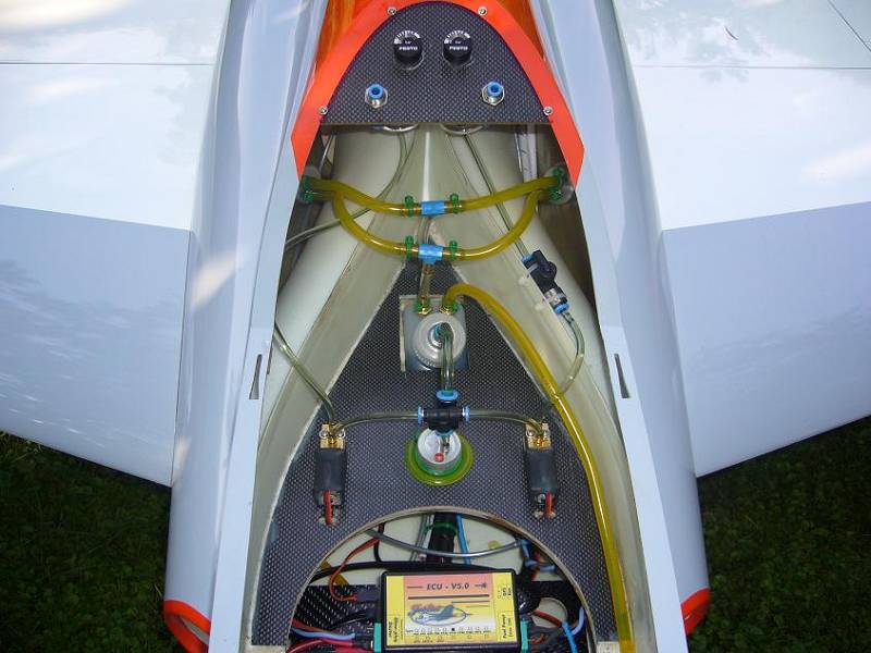

staale, someone else will answer that question i am sure. a friend came up with the pictures. i have lots of other pics comeing will post soon.
