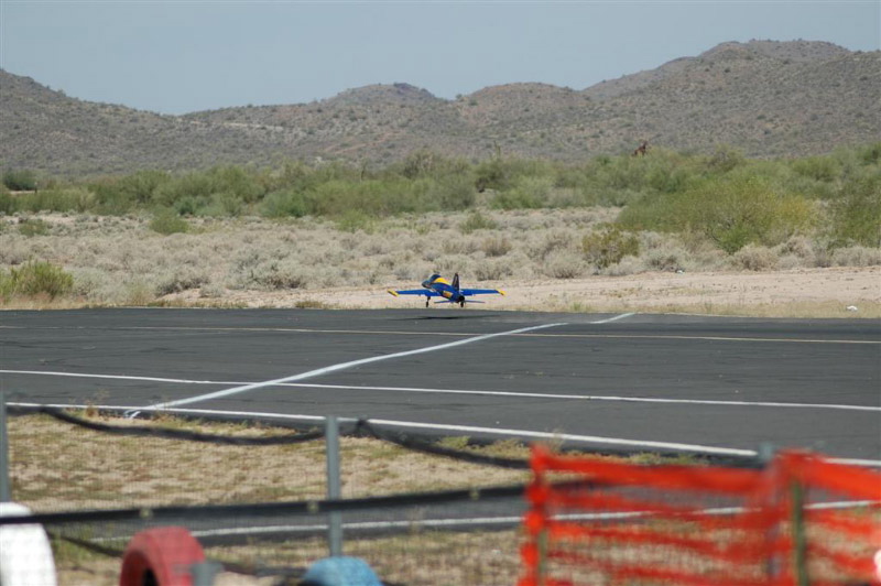

As for my Flash, it's got a P80 in it, and I get around 8 minutes with about 1/2 inch of fuel left in the fuse tank and the stock hopper is full sitting next to a BVM UAT that is also full. So, even with 8 minutes (more than enough for me) you've still got enough fuel for a few go-arounds. I thought about buying the wing tank, but honestly I just don't need it.
Also, with my P80 and 100 degree Phoenix AZ weather, I use about 300 feet to take off with half flaps. I could probably get it in the air earlier, but it looks more realistic with the steady TO.

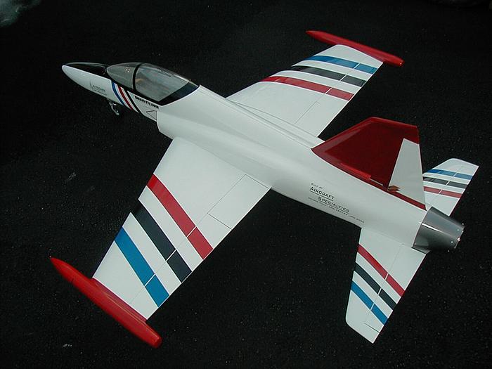

I used LIPOS and made a removable shelf that fits way up front + still have room for the air tank, only needed 4 oz to get it to balanced... using a WREN SuperSport, flies GREAT overall weight is 18 lb!!
That's light, do you have the wing tank fitted, and are you useing the behotec retracts.

If your field is grass, you will be happy with the JETA1 gear, the BEHOTEC ones from CARF have a habit of snapping the 6mm pins on anything that is slightly rough like most grass fields. I have a set of trailing link struts on mine that really cured this problem!

I don't have the wing tank fitted .. the SS is not a thirsty engine I get 8-9 min flights + I removed the brakes to save weight + I'm using all Lipos for power that also saves weight My plane stops quite quickly on our grass fieid

oopps forgot, yes using the behotec retracts but not the behotec struts, I have dreamworks training link struts with 6.3mm pins ( 1/4")

Great looking jet, geh3!!!

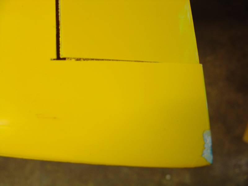

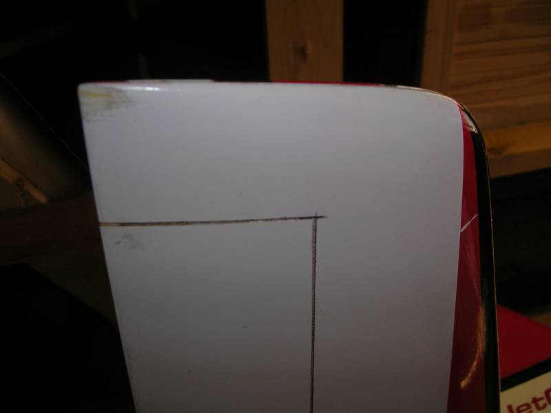

I have noticed that when I come into land WITH THE NOSE WELL UP I scrach the tail plane!

I NOSE what you mean Fred!!!

BVM makes some neat little clips for this purpose, go to the BVM website and search under "accessories"

Learn to land properly guys
or alternatively buy a couple of these wing skids -
http://www.ripmax.com/CAT2006/2006-252.pdf
http://www.flairmodels.co.uk/Accesso...tive/skids.htm
Cut of the two 'prongs' and attach to the bottom of the tailplane with servo tape.
