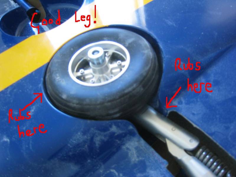

I'm trying to fit the Jet 1A gear and am having a few problems and would be grateful for any tips from those that have already done it.
I enlarged the retract mount gap to fit the units but then when I put the retracts in place the wheel is almost 1/2 inch too far back. To correct this I have enlarged the retract bay a bit more so I can mount the retract 'off line' so that the wheel lines up with the well. Does this sound right? I am a bit worried that the wheel will no longer be straight when the gear is down. I can't see another way to get everything to line up.
As well as removing a bit of the 'lip' of the gear opening I have also had to remove some of the material where the wheel well meets the gear opening. Has anyone else had to do this?
Has anyone got any good pics of the finished installation (without the well covers fitted)?

Here are pics of my 'drop-in' Jet 1A retracts.
I would be interested to see other people installation as I can't really get them to fit.
I have ground out loads of the retract mount and wing and they still don't fit. Even the one that is in rubs on retraction. I'm almost at the point of trashing the wing (if I haven't already).
I'm beginning to wish I had bought the Behotec[&o]

Here are some pictures of my install, I trimmed the same ares as you to achive the best alighnment I could.

Sicklic,yes you do have to remove a LOT of the retract pocket to get the things to clear,
my concern was the clearance around the well,but stick with it!,i did ask if smaller wheels were avalable but no joy ! but to be fair to Sandor the quality of the units are far better than the std
and no broken pins !
After 20 plus flights the units are fine with no movement and clearances have remained the same
you do need to make sure the units are as far forward as possible on install.

I'm pretty much there now. I didn't realise that I would have to modify the wing so much and thought that I must be doing something wrong. I have had to hoover the inside of the wing as there was so much dust in there!!
I need to reinforce the gear mount plates again as I ended up taking a bit too much material off to get them to fit. I have also had to mount one unit crooked to get the clearance. This has caused quite a bit of toe-out but re-filing the pins will sort that.
I assume that you have not used the 'inserts' that go into the wing under the retracts. Has that caused any problems?

it is a tight fit yes..
what you can do is to losen a bit the screw that holds the spring on the upper side of the wing
you will see that the down part will move slightly , this can clear out the last rubbing you might have.
as for fitting we had lots of customers putting them in , and they where all ok.
maybe your formers where nott at the exact spot.
we also have customers using 3 inch wheels instead of the 4 inch ones.
Why would they rub, I thought they were supposed to be a 'drop-in' fit?
Others on this thread have indicated similar problems
OK, so it's the models fault
Is that because the 4 inch ones don't fit properly?
Sorry to be so difficult but I am a bit annoyed that I spent so much money on retracts and they don't fit as advertised. I can't return them for a refund as, now the model has been significantly modified, no other gear will fit. Don't get me wrong they are excellent quality, but you indicated that no modifications were needed and that is not true. They don't even fit between the retract bearers.
You can get them to fit but not without significant modification to the model (a lot more than the 3mm of skin removal that was mentioned). If I had known this when I bought them I may still have bought them but I feel annoyed that I have been misled. I just want to highlight this here so that others can make informed decisions about their gear choice.

sorry just trying to help.
as far as fitting , i also owned a flash and i did put in the retracts.
mine fitted between the bearers simply because our size is EXACTLY the behotec size.
so looking at yours you do have a problem somewhere.
if you are not happy with the gear , send it back please.

As a tip to others ,you MUST line the units up and remove the wing material before trying to screw/bolting in the mounts,the retract mounts like most artf,s are NOT all the same or in line.[:@]
You can then shave the mounts ,there is just not enough clearance in the wells.
