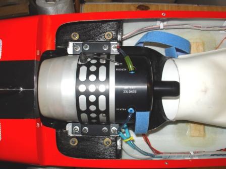

I have a Behotec J66 HP engine fitted in the Flash runs fine.
