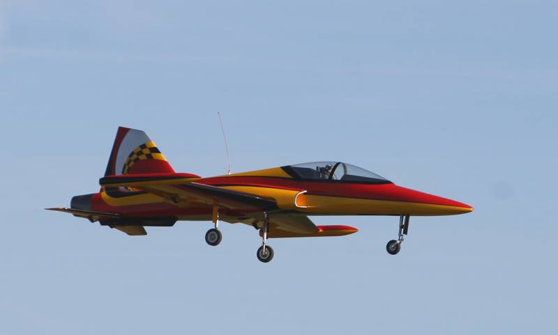

Fred,
For you to reminisce over...taken last Saturday!
Cheers,
Dick
