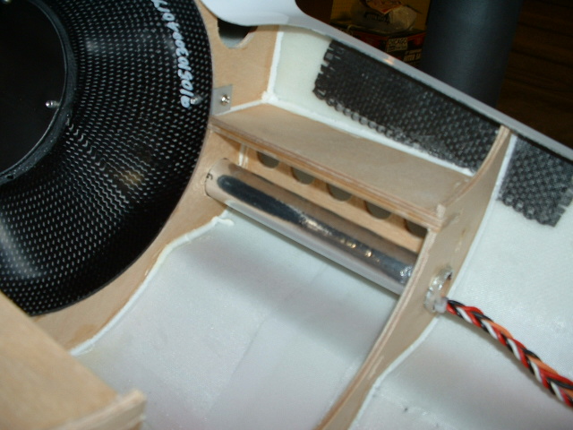

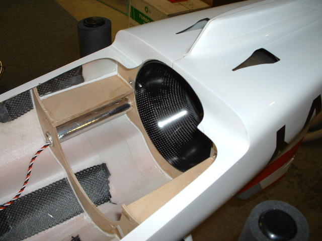

Is it O.K. to put this tube in here to protect the servo wires, or am I blocking a hole that bypass air is supposed to flow through?
I guess bypass air will still flow through the tube, but it might limit the flow a little?
Thanks, Jim

go to BVM site and in the catalog under air systems at the bottem in air accesories you will find clear brake line 6ft $2.25, not sure on the Pt No but someone out there will know it.
Fred[sm=75_75.gif]

Thanks, I'll order some and see how it fits.
Jim

Part No: J-BVM-4235 for brake pipe.
