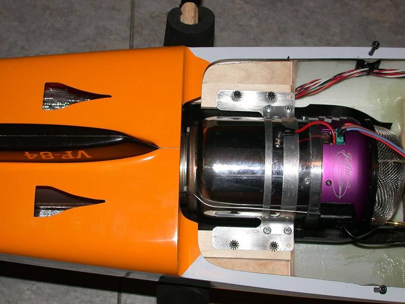

NACA inlets, do I need those? My friends who fly their flashes with the 120 and titan did not cut any NACA inlets and even claim the inlets can cause damage by catching too much air.
Old 04-14-2009 | 08:41 AM
  #783
Joined: Apr 2006
Posts: 5,962
From: Enterprise, AL
Default RE: Comp ARF Flash update
ORIGINAL: MicroDat
I've got a Titan SE in my Flash and it has the NACA inlets, as you can see in the pic, there is no damage at all to them and she's been at top speed many many times. I'd recommend adding them otherwise the outer pipe has no way of drawing in air, the bellmouth basically seals off the forward bulkhead and the pipe seals the tail cone.

"I've got a Titan SE in my Flash and it has the NACA inlets, as you can see in the pic, there is no damage at all to them and she's been at top speed many many times. I'd recommend adding them otherwise the outer pipe has no way of drawing in air, the bellmouth basically seals off the forward bulkhead and the pipe seals the tail cone."
Quick Question. If the front and the back of the pipe are "basically" sealed, how does the air from the NACA inlets flow?
Would a front inlet and rear exaust be more effective?
Doug
Old 04-20-2009 | 12:14 PM
  #796
Joined: Apr 2006
Posts: 5,962
ORIGINAL: rcdoug
Doug
under the inlets is where the gap between the two pipes is at.

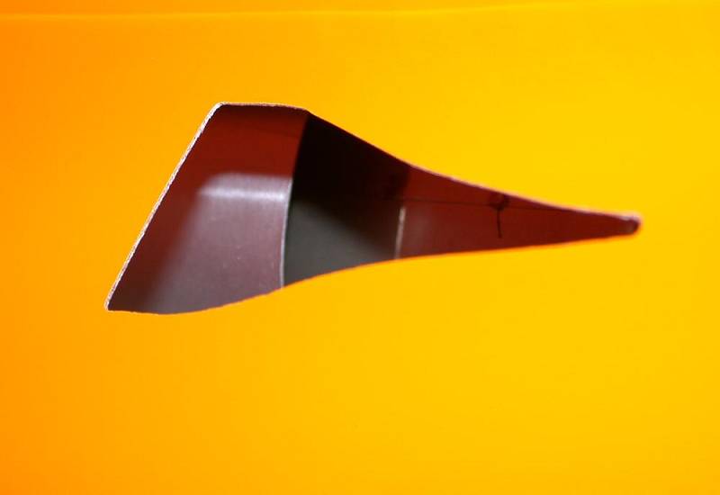

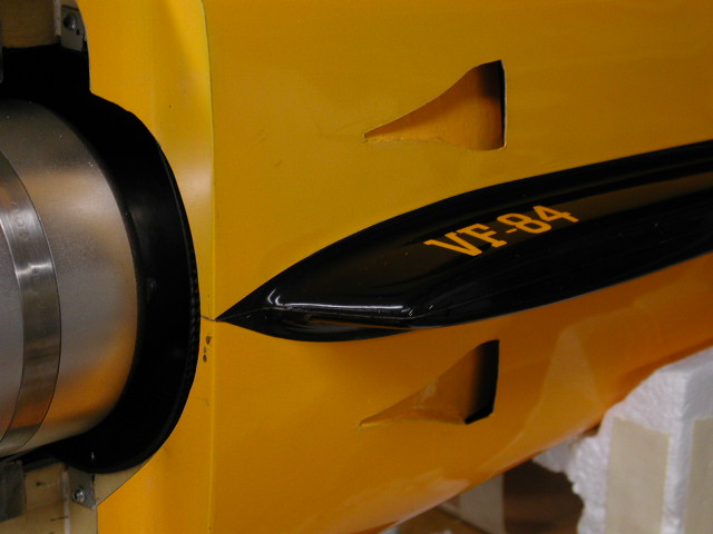

ORIGINAL: rcdoug
Doug
The air enters the inlets and is drawn between the inner and outer pipes. There are also holes in the former around the bell-mouth. But, the last two sections of the plane are sealed and I always think that this area could use some ventilation.
Here's a pic of my inlets:

ORIGINAL: causeitflies
ORIGINAL: rcdoug
Doug
there is also enough flow between the front retract and fuselage forcing the air outwards
