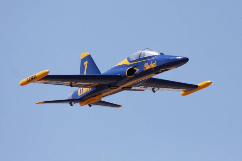

#841
<span style="font-size: medium;">Hi Guys,
Test flew my flash last sunday with the new wren 160 engine. CG was at 365 mm from the rear of the tip tanks. T/O flap was at 15 mm and landing flap was 50 mm. After rotation the plane took about 2-3 mm of up elevator to fly level and felt a bit nose heavy, after trimming, i had a great 5 min flight in clean configuration. After selecting gear down the plane again got her nose down which is normal. I selected flap 1 and the plane dived some more towards the ground, selected landing flap and the nice flight so far got pretty hairy with the PIOs. I was really struggling to fly the plane in landing config.
My question is if the plane is tail heavy, </span><span style="font-size: medium;">why did she take a fair bit of up trim to fly level.And if she is nose heavy, why did she go into the PIOs.</span><span style="font-size: medium;">
I am a bit confused now if i should add a little nose weight and get the CG to 370mm or remove some weight and get the CG to 360 mm, or leave the CG alone and just decrease the flap throws.
I was using flight modes on the 12x, and had trimmed the plane in clean config, so when i selected flaps i must have lost all the up trim i gave in clean config which must have added to the PIOs.
Thanks for any inputs
Chaitanya.

#844
ORIGINAL: JoelP
............... balance at mid-range of published c/g.
i found with mine, 362mm worked out to perfect neutral trim, where all surfaces are lined up flush and best of all, no trim change between slow and high speed flight with it cleaned up. it's so neutral that at modest speed you can slow roll for a mile with just aileron and not loose altitude.

#846
Hi Ron,
What is the amount of landing flap you have on yours? I have 50mm on mine but even with T/O flap of 15 she had a tendency to nose dive.
I did not fly for long enough with T/O flap so cant say much., I will try flying her for longer with T/O flap next time and see how she goes.
Another problem i am having is the intakes are small on the flash and the engine is the wren 160 which sucks inn a lot of air and i had the engine stall as there was lack off air. We fly in Mumbai in temps of 35degrees c, this combined with low pressure gives us a high density alt.
Any of you guys flying the flash with 35 lbs turbine faced this problem. I may have to cut 2 additional naca ducts on the side of the fuse to solve the problem.
Ron, i fly in Mumbai and on our feild we have a few bvm jets, 2 Sg hawks, an Avonds rafale, F16, Aw L39 and a few more so the flash was just an other sport jet in the sky .

#847
Joined: Mar 2006
Posts: 545
From: West KirbyWirral, UNITED KINGDOM
Hi Chaitanya, Your query prompted me to rig my model and double check the flap throws. Like you I have 15 mm deflection for take off and 35 mm for landing. I fly from a grass strip and have a Wren ss for power. I find I have to use a fair bit of elevator to get the model to unstick andyou have just reminded me to dial in a few clicks of 'up' elevator trim for take off. The landing flap deflection allows me to 'draw' the model in using a resonable amount of power. The speed bleeds off quickly when I close the throttle and the landing becomes very manageable. Flying from a grass stripwith a restricted length runway ensures that every landing is like a carrier landing.
Apologies for under-estimating your jet activity. I wish I had the same level of jet support in my club. Re. the intake area, as a former D/F flyer I am particularly interested in duct design and the Flash does seem to have sacrificed 'form over function' but I am no expert. This forum is testiment to the number of people who have experienced over heating for whatever reason. However the good guys seem to have it mastered and fly with turbines of similar size to yours although the factory addition of naca inlets at the rear bears testiment to the underlying problem. I fly without a by-pass and have experienced no problems with the rear end being only slightly warm. I use a Wren augmenting thrust tube with a 2mm ceramic blanket for insulation. Ron.

#848
Chaitanya, are you running the full bypass??
it gets hotter than 35C here where I'm at, but we're only 300' ASL and with the Titan SE I've never had any issues, i do not run the lower bypass cover or the inlet ducting, this way the turbine can draw air from the fuselage (mainly the nose wheel hole)
#849
Hi Kc36330,
I am running exactly the same setup as yours, no lower bypass cover and not used the inlet joiner. Infact i think i copied your setup which you posted some where here on rcu a while ago.
I think the wren and jc may have different compressor designs, and the wren manual says that this engine needs a fair amount of air to run.
The engine only stalls if i slam open thrust from idle to full. If i gradually open thrust from idle to full the engine performs flawlessly and runs very sweet even at full thrust.
Any idea what would be the best place on the fuse to cut the naca ducts, just incase i decide to take that route.
