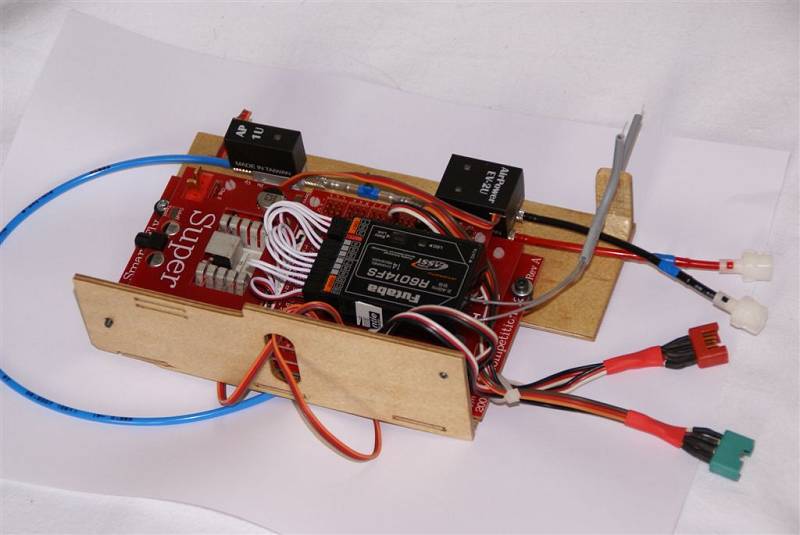

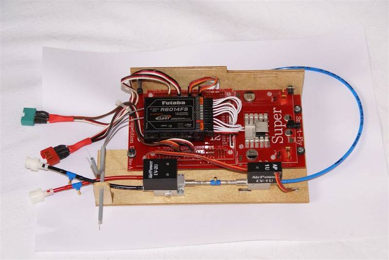

#740
Joined: Aug 2006
Posts: 138
From: -Burgundy, FRANCE
Hello Microdat,
I will use a Smart-Fly PowerSystem Competition 12 with 2 x 1800mA lipo in my flash (see attached photos)
I use the milled plywood plate included in the kit for the power system, Rx and retract/brake valves on the right side of the cockpit
Best regards,
Alain
Best regards,
Alain
