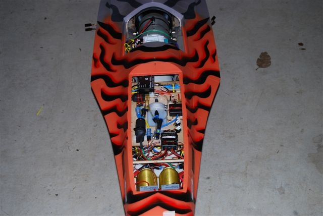

#1487
Joined: Apr 2008
Posts: 599
From: Sydney, AUSTRALIA
Here are a few pics of my FE F 16 plus now ready for a maiden. Came in at 9.1 kg dry.
I recon I spent 50 hours on this thing. Jet central Falcon turbine if you are wondering!
2 weeks to Temora and maiden
Mav[8D]
Mav[8D]
