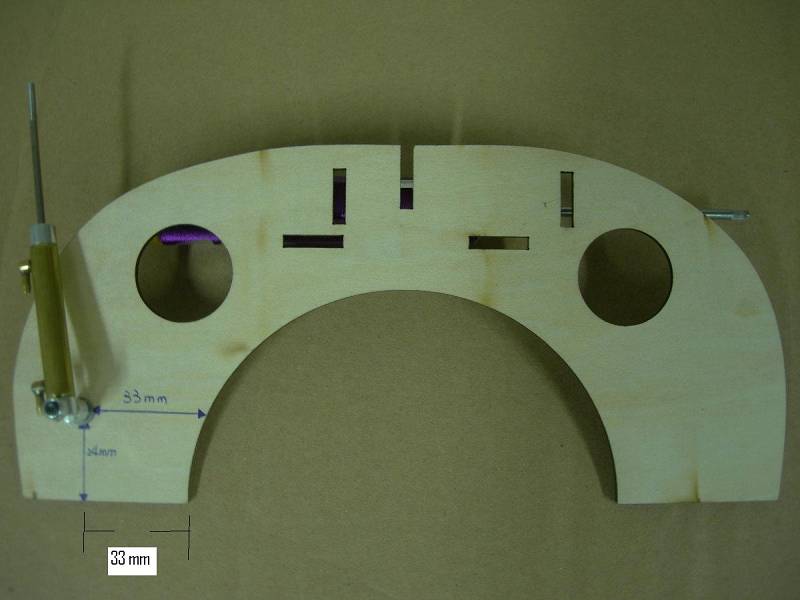

Hi Mike i am glad that you have got them to work,i tried allways but was not convinced.What measurement did you use the web site is not very clear i used 33mm oneway and 24mm the other was this correct?i had to redrill mine so the nipples faced in towards the centre of fuse. i am fitting a Wren Supersport 18lbs thrust with an exhaust duct regards Keith

Hello Keith,
I see what I did, although not intentionally, but it worked. I used the 33mm from the bottom corner. see attached photo.
BTW, for the hinges in the nose gear door, the last two toward the front will have to be modified by cutting the ears off. Do that before you install them, believe me it will be a lot easier.

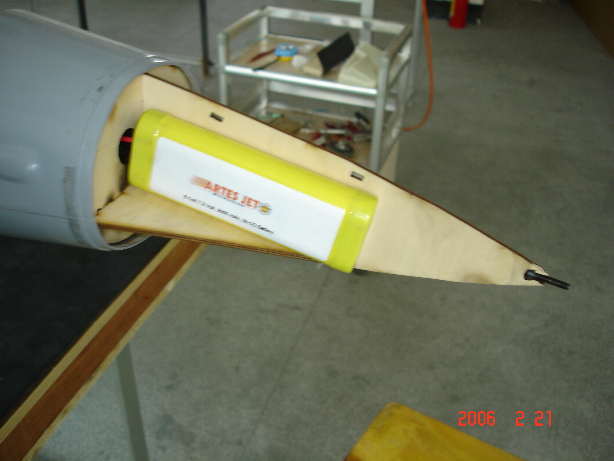

I had been trying to decide whether to mount my Wren SS in the tail or in the conventional location on my F-16. I'm leaning towards a conventional mounting. After looking over the kit I don't think it will be practical to put enough weight far enough forward for a tail mounting.
Looking at the Skymaster website I noticed that they provide formers to mount the batteries in the nose. These also allow a removeable nose cone for access. See picture.
No such formers were supplied with my FEJ F-16, nor do the installation instructions on their website show any. Someone who does a tail mounted turbine would have to make nose formers similar to Skymasters. Did anyone get nose formers with their FEJ F-16? I suspect this is an oversight by FEJ.
Joe

Hi Mike yep allready done the ears on nose wheel door hinges,but i could not get the front one in there is just not enough room for the hinge and the ram,at last i have all the air system working and air tight,i am now starting engine installion,the FEJ exhaust pipe is a bit on the heavy side [13oz] i have a wren single wall pipe which weighs 7oz which is matched to the s/sport so i might go that route regards Keith HAPPY NEW YEAR to all

ORIGINAL: joeflyer
Joe
Hello,
here the assembly which I carried out for my F16.
For the cockpit, there is the skymaster, and eagle jet prepares some for soon.
Regards,
Sébastien

Sebastien,
Did those plywood nose formers come with your kit or did you make them?
Joe
