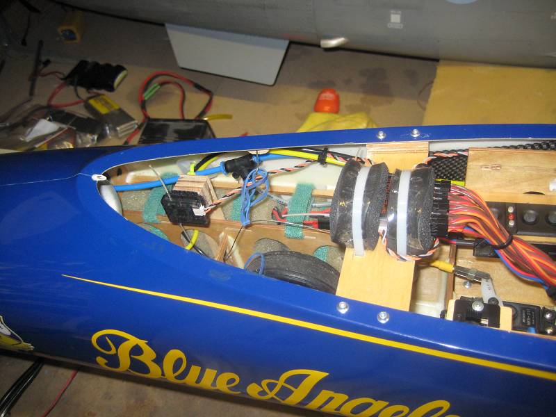

Hi,
I have flown my Flash on 2.4Ghz today for the first time. I had 4 flights and it worked perfectly, however when I look at the data ref the number of fades/frame losses after each flight I am slightly concerned. Here are the results.
Flight 1- A 40,B 72, L 64, R 244, F 0, H 0
Flight 2 - A 141,B 136, L 69, R 234, F 0,H 0
Flight 3 - A 255, B 253, L 555, R 801, F 46, H 0
Flight 4 - A 65, B 39, L 58, R 186, F 0, H 0
Done a bit of research on previous threads and the figures look OK, apart from flight 3 which looks a bit odd. As there are people on RCU who are far more experienced then me with using spektrum, can anyone offer any advice. Are the figures OK? Have I anything to worry about?
Also, I am sure it has been asked before but the L and R figures refer to Left and right external antenna's. How do I know which is left and right?
I also thought it might help posting a picture of the installation. Note the second remote receiver is at the rear of the plane in the fin.
Thanks.

Disconnect one of the remotes, start up the tubine and taxi around a few minutes, come back and take another reading and you will find out which one is L or R.

I have used this system in two of my jets and have been extremely pleased with each. From your data I would say that everything other then flight #3 is acceptable, but I would move the "R" antenna to another location to see if you get better results. I am guessing that the "R" may be the one in your vertical fin, and the lengthy lead may cause the lower numbers.....but this is just a guess. Your system seems to be operating perfectly, don't dwell too much on flight #3.....I have had the same type of readings on one flight, then perfect the rest. Either way, the system works above my expectations and I will not fly another model without it.

FWIW, I get numbers comparable to your flights 1, 2, and 4. Flight 3 is higher than I have seen, but at least you did not get any holds. Rapid rolling maneuvers seem to increase the fade count, and orienting the transmitter antenna vertically (rather than straight out) seems to reduce the fade count. I've got about 35 flights with a Spektrum setup and it has worked well so far. I'm flying an air frame slightly smaller than the Flash. Thanks for starting the thread - the info should be useful.
Even with flight three's reading being high you only had 46 frame losses but no holds it takes 44 consecutive frame losses to egual one hold so they were not consecutive frame losses. Also I have noticed that if you are wright next to the model at some angles you can cause your antena counts to go up so they may of been high before you took off. I usally check mine before I fly as the canopy is going on. To make sure what ever reading I have are only from the flight and not while I am next to the model. To find out easily since you have the data loger turn on the system and remove one of the remote antenas and scroll through the data loger until you see ----- reading and thats it.

Your flight #3 numbers "seem" high, however your number of fades in WELL below what I have EVER gotten. It is not uncommon for me to get up to 100 fades (I am only using one external antennae). Like Sean, I have not ever felt so much as a hint of not being in control (other than my pure lack of ability). When you start seeing "Holds".....become concerned. Until then, burn Kero.

Your figures could be improved but as many have said the totals for the flight are not consecutive, so I would not worry...your 35 mHz gear was going in and out throughout the flight...you just didn't have a way of checking!
Make sure you don't hold your Tx right next to the model before you take off, you can swamp the system

Two things of interest. Firstly, when starting the model I was holding the Tx and so naturally it was very close to the model and secondly on the third flight I was doing a lot of rolling and snapping manoevres and since the model is doing about 2 snaps per seconds it is rolling really rapidly so maybe thats the cause of the high counts.
In any case, during the 4 flights at no time did I not feel as though I didnt have control so I will continue to fly it, monitoring the counts for my own curiosity.
When I get home tonight I will pull one of the external aerials out to ascertain which is left and right as I am very interested to see if the R aerial is the one at the back of the model in the fin as mentioned by Dave Presta.

Have you looked at the carbon situation around the fin? I'm sure it will be the fin mounted Rx that is giving the high numbers.
It would be interesting to know the temperature range on the sub aerials...must be warm in the fin

OK Paul says 85 degrees C max
He also says that the tail pipe will cause a lot of reflection. Basically he says take the remote out of the fin and put it in the wing.

Funnily enough, I was chatting to Dick after flying yesterday and he said that maybe its the tailpipe causing issues with the rear RX. If, as we suspect, it is the rear one that has the high count then I will definately move it as suggested.
Any details(timescales?) on the new RX? What makes it more suitable for jets and large models?

Well, just checked and the right external RX is indeed the one in the top of the fin so as advised I will reposition it.
