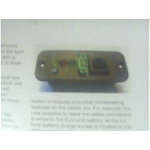

Has anyone Seen or is anyone using the new version of the I/O interface Board from JetCat. Pix in July August Jet Power Mag. Page 63.
I didn't see it on their site last month when I ordered another old style I/O board.

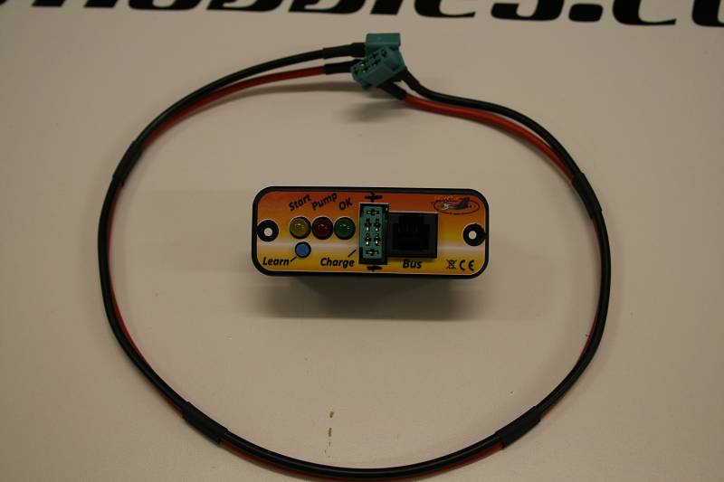

We have had them in stock for a few weeks now. Was going to post it on here but didnt want to get another slap on the wrists!

So, one can now charge the battery w/o disconnecting from the ecu using the provided cable and charge jack, right?

Ali:
Thanks. I just needed the new I/O Board instructions. However a nice guy from Iceland posted a pic of what goes where. The only question now is whether you can quick charge A123 battery thru the I/O board with out disconnecting the ecu.
Thanks again.

Default RE: New I/O Interfece , from JetCat
Let me help clarify.
The restriction is for a reverse pulse in the charge cycle. This is normally called a "REFLEX" mode in most chargers.
REFLEX mode is only used for NiCADs, not for the factory supplied LiPos. So if you are using LiPos you can use any charger you like without hesitation. If you are using NiCads you are on your own, you have to personally make sure your charger is not using a negative pulse if you are using Ni chemistry batteries!.
I don't know as much about A123 so you would need to read the manuals on your charger to see if they ever use a reverse pulse. If they don't you are fine.
Hope that helps,
