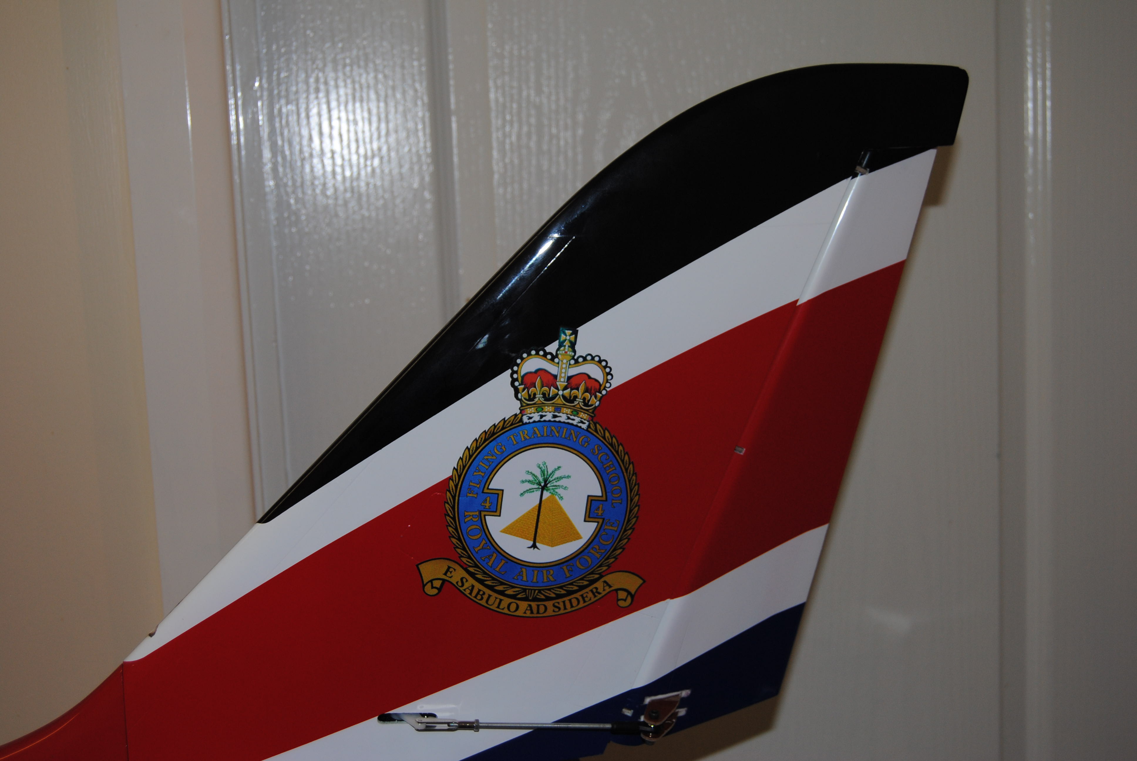

Hi Roger
Not sure about being ahead just doing some of the messy bits, I have not decided yet on repainting the canopy, I have been messing about with the inside of the canopy at the moment so that I can fit the derjet tubs, had to make some rails, trying to upload some picts but need to work out how
Dave- The black area is tiny, so I don't think shrinking the lettering will work

Will try and find some pixs on the cockpit fitting. Several have done it.
Will look at fin and see!

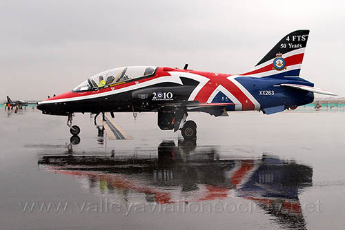

Here is the CARF Hawk and full size and you can see the paint scheme on the model is quite wrong. I hope the pictures have uploaded
Roger

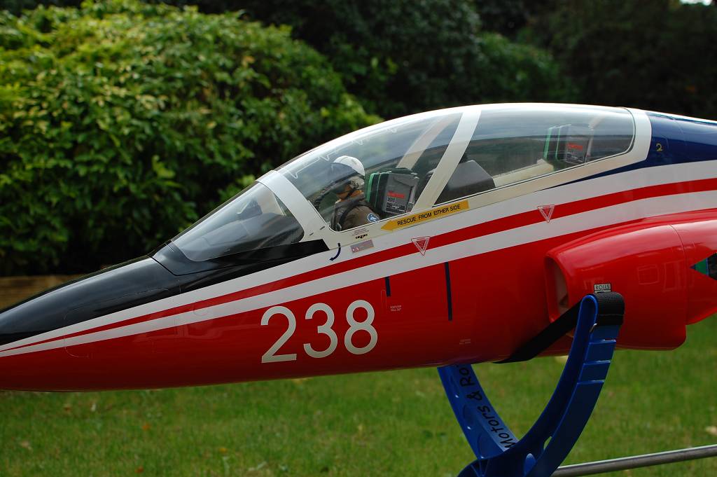

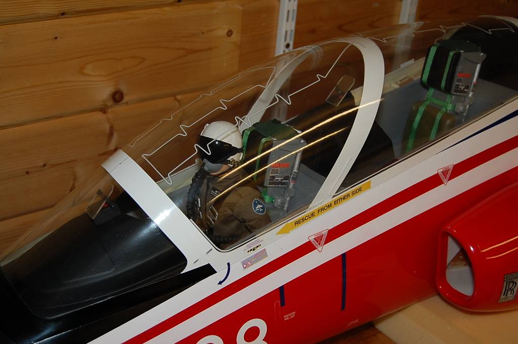

I have used the Skymaster scale cockpit kit on my carf Hawk.
Very easy to fit,just need a 3/8th x 1/8th balarail glued to the upper inside edge of the frame.I then painted the balsa rails and inside of frame matt black.
The SM cockpit kit comes in two halves and the ABS tub is already reinforced with lightweight glass cloth.Just trimmed the edges to fit inside the frame and glued with ZAP A-Dap GOO.
I bought a 1/5th scale red arrows pliot with scale flight suit from Fighteraces .co.uk cost about &pound;90.00. Be carefull to mount all your radio/ecu etc.as low as possible to clear the cockpit base.
Phil.

Just trying to upload some pice of my Carf Hawk scale canopy.</p>

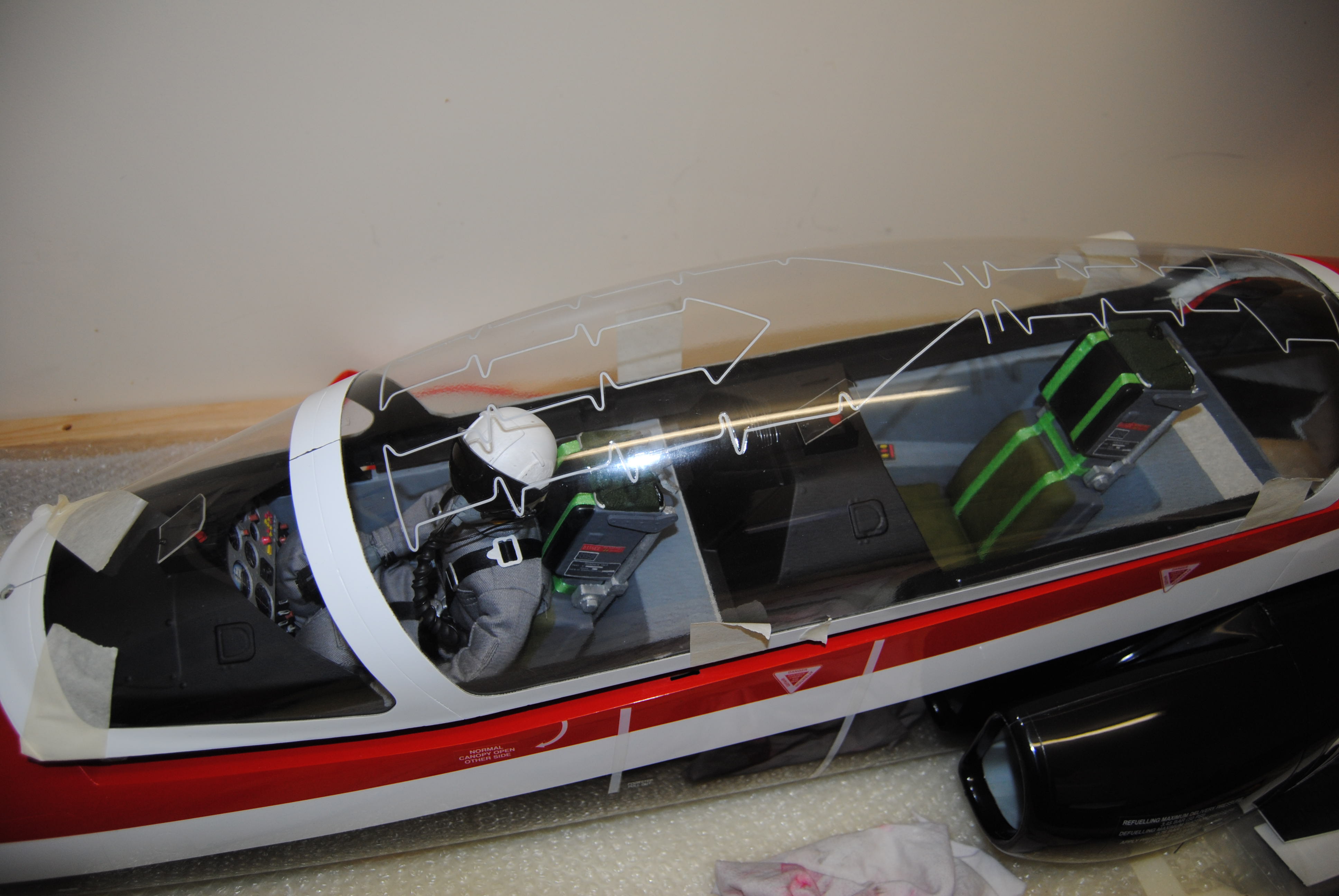

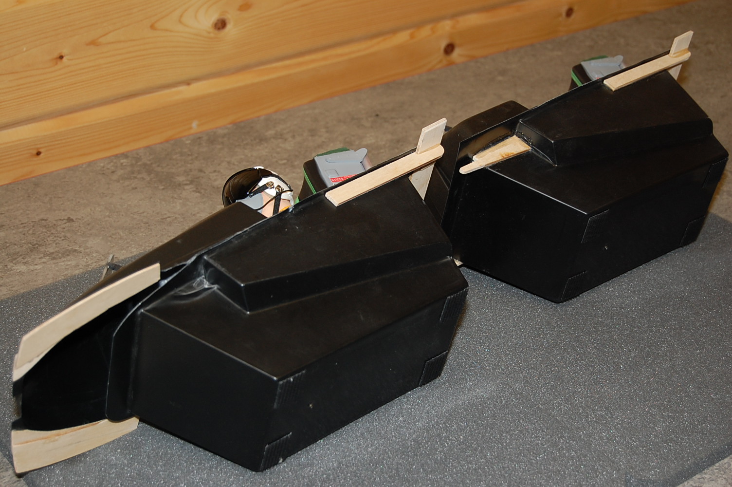

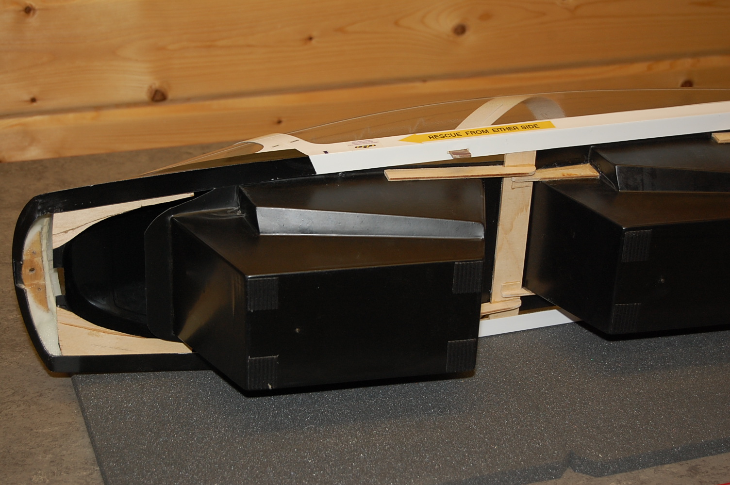

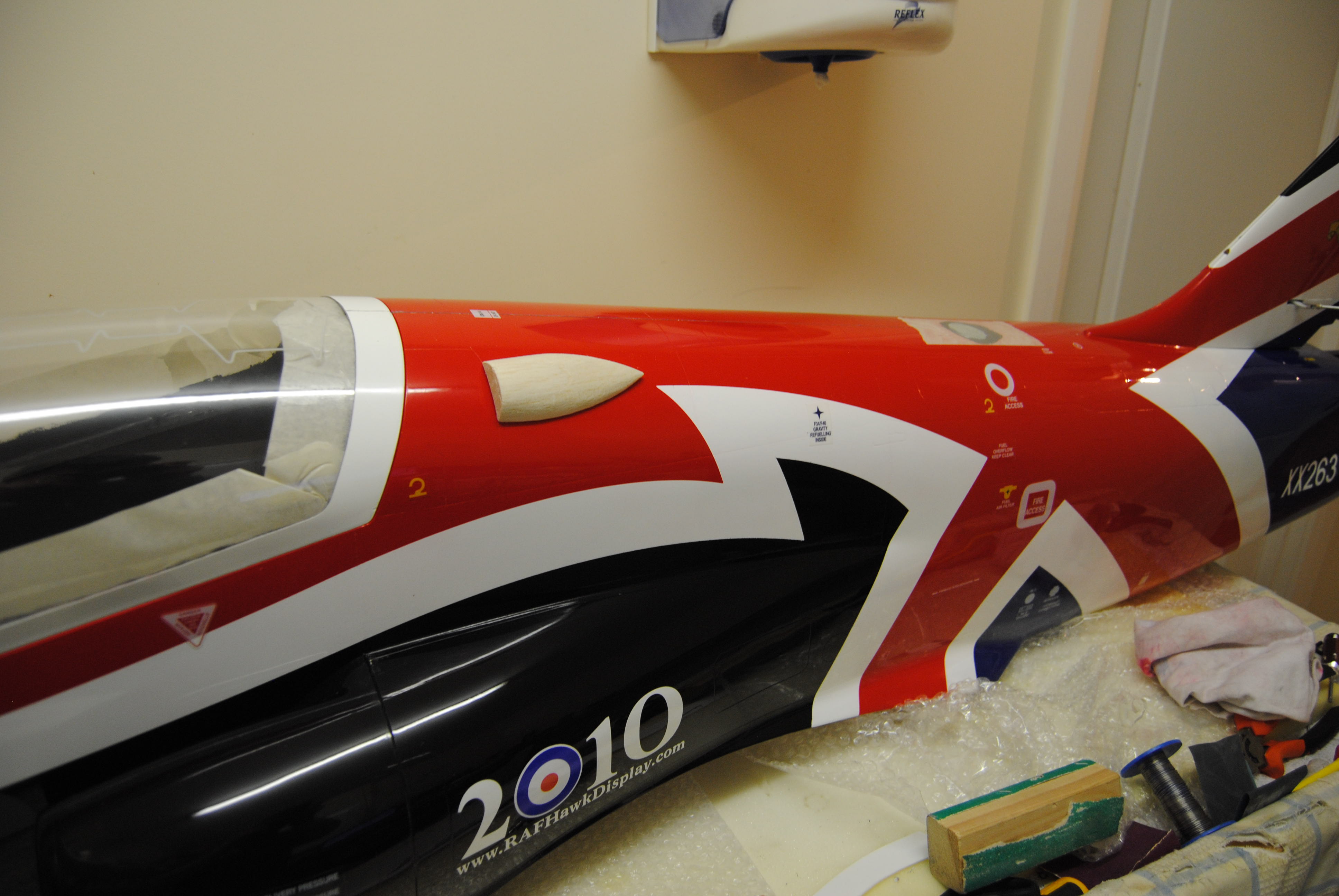

Default RE: Comp ARF BAE Hawk build thread

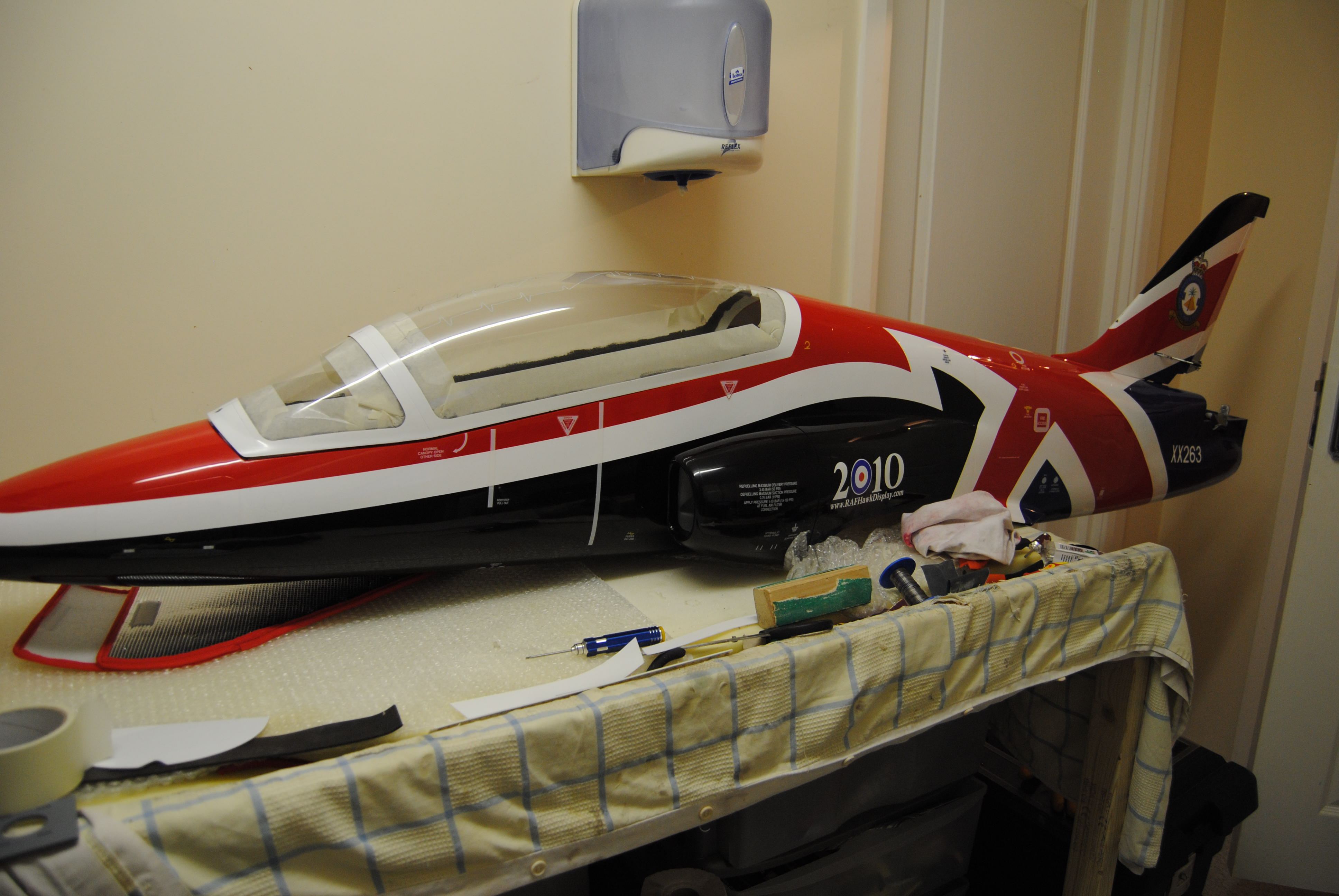

Roger
Got some images up at last, as you will see I am trying to make some air scoops for the top as well, one way or another this project is not going to be a scale model just making it look as near as possible.
Also here are a couple of cockpit shots, I have gone for a similar method to Phil, the front end needs some chopping about to make it fit but will be ok once finished, I think I have made hard work of this part.

Lewis,
Are you going to mould the air scoops, or leave them as solid wood? I will probably do what you have done on the fin and not fit the white lettering as there just isn't enough room. I've sprayed the canopy frame black so the next task will be to fit the glazing. My cockpit tubs will be fitted in the same way as Phil's, using silicone and Zap a dap a goop. It's a shame that CARF weren't more particular about the spraying of the scheme, but it is a sports jet after all
Roger
Old 12-01-2010 | 05:04 AM
  #539
Joined: Aug 2010
Posts: 110
Received 6 Likes on 6 Posts
From: Berkshire, UNITED KINGDOM
Hi Roger
I thought about sealing them with resin and painting, I have had some spray made up to colour match the red, also the blue as the rear underside fins I am going to paint these blue, it will be too much hassle to do them in all three colours to follow the lines through, I think it should look ok, you could spend forever on these things and for a sprts model its not that critical. Going to by a Skygate/Airworld one next

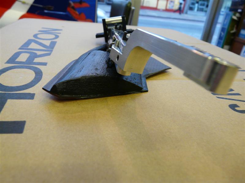

Here are some mods I have done to my Hawk sports landing gear.
I have added (drilled and tapped) a 3mm allen bolt to bottom of main led just at the pivot and then ground it with a dremel to limit travel on the trailing arms to 45deg.
Before the trailing link could deflect up to 90 deg. on a heavy landing wiping off the attached doors.(thanks Dave W. for the tip)
I have also added 10mm balsa sheet shaped to an aerofoil to try and create inward lift to the doors to aid retraction on take off.
I havn't had a chance to test this properely so far as could only maintain 80 psi in my system this year so farso it was always roll inverted and clime slowly inverted and then retract which always worked.
I am replumbing my entire system this winter.Spliting the door and gear on to two seperate circuits as I have three tanks anyway.Also decided to use Festo 3mm tubing and not BVM as the I.D. on the Festo tubing is larger and hope with the new large dia. retract cylinders (25 mm) this will cure the retract problem some of us have had.
Phil.

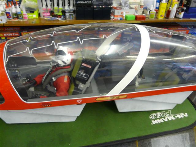

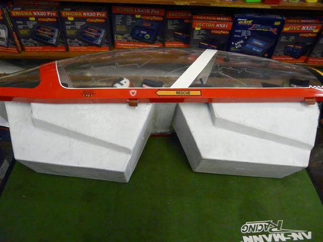

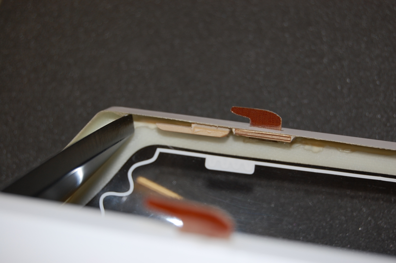

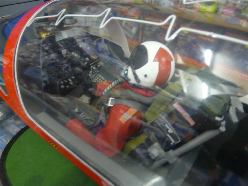

Pixs of DerJet Cockpit-Removable method by M&R team pilot Rob Westwater.

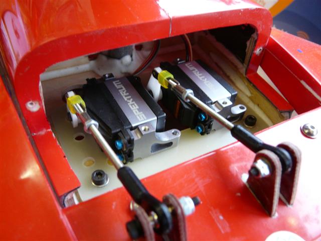

Here is another mod I did to my Hawk.
Due to my own faultI glued the rear elevator servo mount to the wrong side of the plywoodmounting plate (big c**k up) so I decided to make a new mount from 3mm GRP sheet and use model car lightweight alloy servo mounts(K-Facory) instead.I have cut lightening holes under the servos and the end result is both light and strong.
I have also used the excellent Spektrum A6030 high torque digital servos(made by Savox).These units have 20kg torque and titanium gear train anmd are very good value,fast and accurate.
I have also just weighed my scale cockpit/canopy unit and it weighs 1kg (2.2 lbs). I have no additional nose weight but I still think my model is a touch nose heavey as although it flies great it tends to drop its nose a little in turns and also needs quite a bit of down elevatorto fly level inverted.
So on the next outing I will move the CG back about 10mm and see it that improves things.
Phil.
