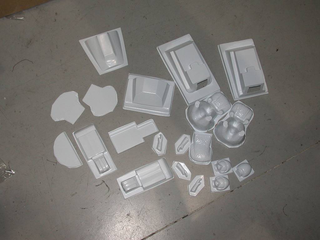

Pix of the first Hawk cockpit set from CARF, all the parts for two seats, pilots, dashes.
Dw

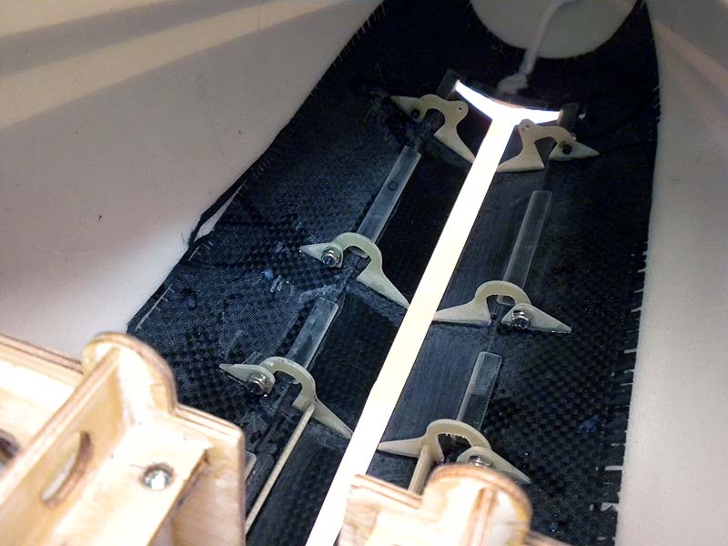

Here are some picks of what I did for hinges on the nose gear doors. I can easily remove these also.
Jeff

Very neat work, there are always three or four ways of doing the same thing!
regards
Dave
