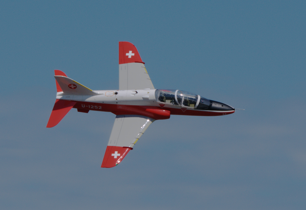

Inconel your Swiss scheme looks fantastic, a really neat build. Well done, keep the photos comming it gives the guys still building some insparation.
Cheers Neil

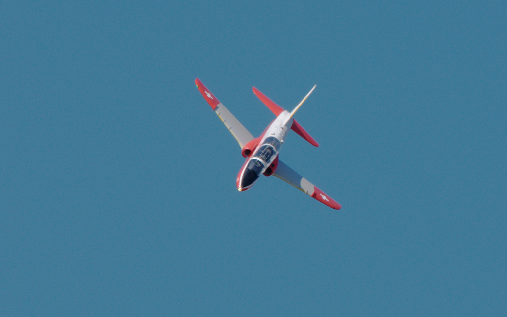

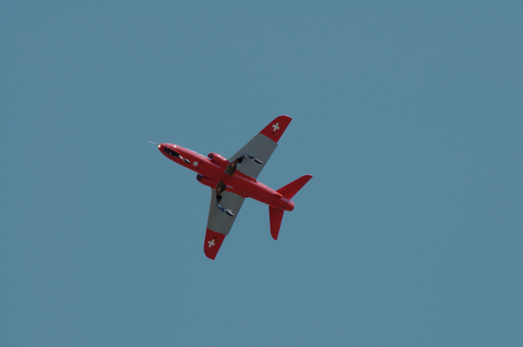

Thanks Neil, the scheme looks phantastic in the sky, i like it. It´s a beautiful finish for thr Hawk.....

Inconel,
Beautiful airplane, nice job on the detailing.
I'm curious if the wing 'fences' come standard on the C-Arf Hawk? I've seen the larger fence (outboard) on several examples, but not the smaller inboard ones. Did you add those yourself?
Regards, Jim

Jim
He's added them. They are not part of most Hawks they modelled
