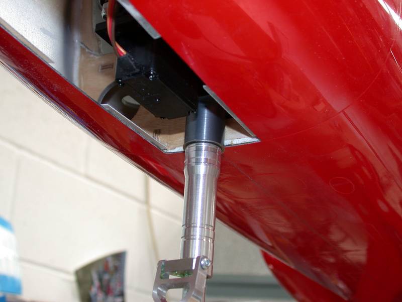

Dave, please post some pics of your front LG install. Iam interested in the distance from the tire to the front cutout as it swings down, THANKS

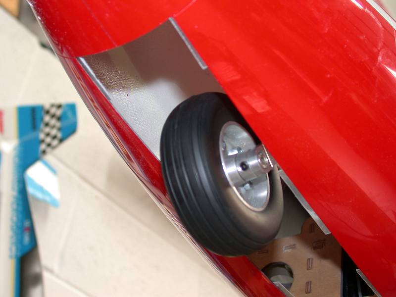

Dave do you have the recommended throw for the elevator? THANKS
Old 05-26-2009 | 12:04 PM
  #84
Joined: Jun 2002
Posts: 13,264
Received 791 Likes on 574 Posts
From: Watford, UNITED KINGDOM
Default RE: Comp ARF BAE Hawk build thread
G
Nose wheel clearance is around 35mm (1 3/8") Elevator up and down 30mm (1 1/4") with 30% expo
Dave

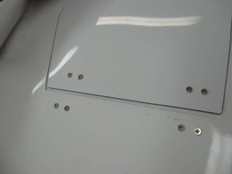

I'm having to shim the mains up a little to avoid the air connector on the bottom from hitting the wing surface
it's quite tight there!!!

isnt that door closing? or is the wheel not locked and up?

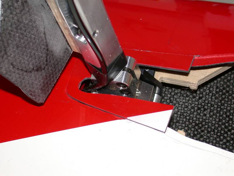

Sandor, you were correct about difficulties in creating a "tub" for the main wheels!
Dave: do you have a solution for the inner end of the main door cover? possibly hinging at the bottom
and moving it with a strut from the main?
I used RCJETMODELS hinges, very easy to use..no gluing, no brass rods

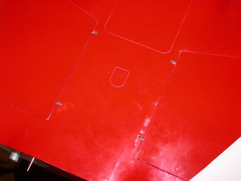

I was going to hinge the door and fit a small spring, but this Hawk is supposed to be a sports model and doors always cause trouble so I cut the plate to clear....When I build my second one as a scale model I'll hinge them.
regards

Sandor
isnt that door closing? or is the wheel not locked and up?-Q
It was left half out to show the distance...
Dave

I realise re reading your earlier post, you know you can turn over the cylinder so the nipple is up (lower skin on the wing) no packing needed then
Dave

OK it's all in there now, Ionly had to use 1/32" so I will leave it for now, I just didn't want to damage that fitting...

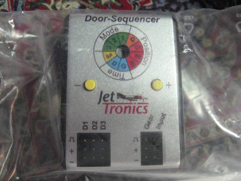

ALSO have you ever used a JETTRONICSdoor sequencer?

Yes, I've used the Jet Tronics Seq in an Airworld Panther
