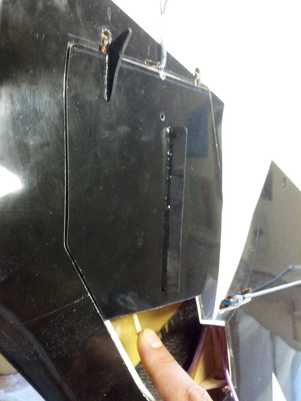

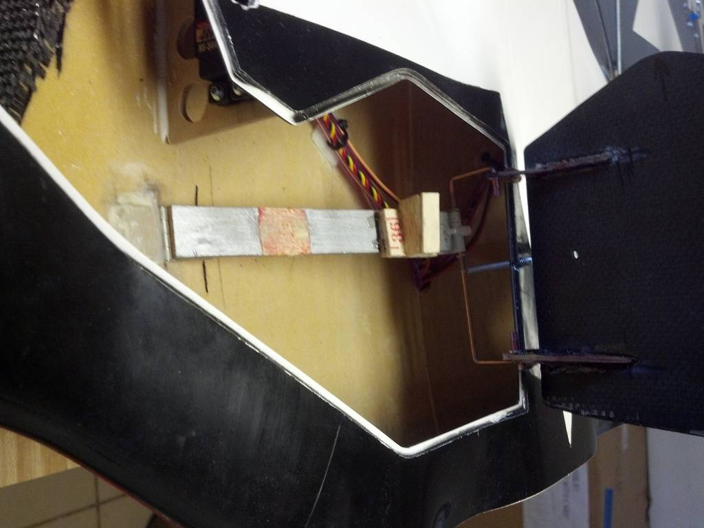

A friend here in Tucson who likes to do things his way decided to eliminate the air system for all the doors in his Hawk. Here are a few pictures (not great) which I took with my phone on how he did the mains. From what I saw it works well.
He uses a spring attached to keep the doors open once the gear is out. He put a small flange (deflector) on the outside of the gear door to help keep the door open using the air stream.
He did not like the way the flaps were hooked up so he ran the push rod on the bottom outside of the wing and used a horn on the outside bottom of the flap.
You can see part of it in one of the pictures.
He is a inovative guy.
Stan

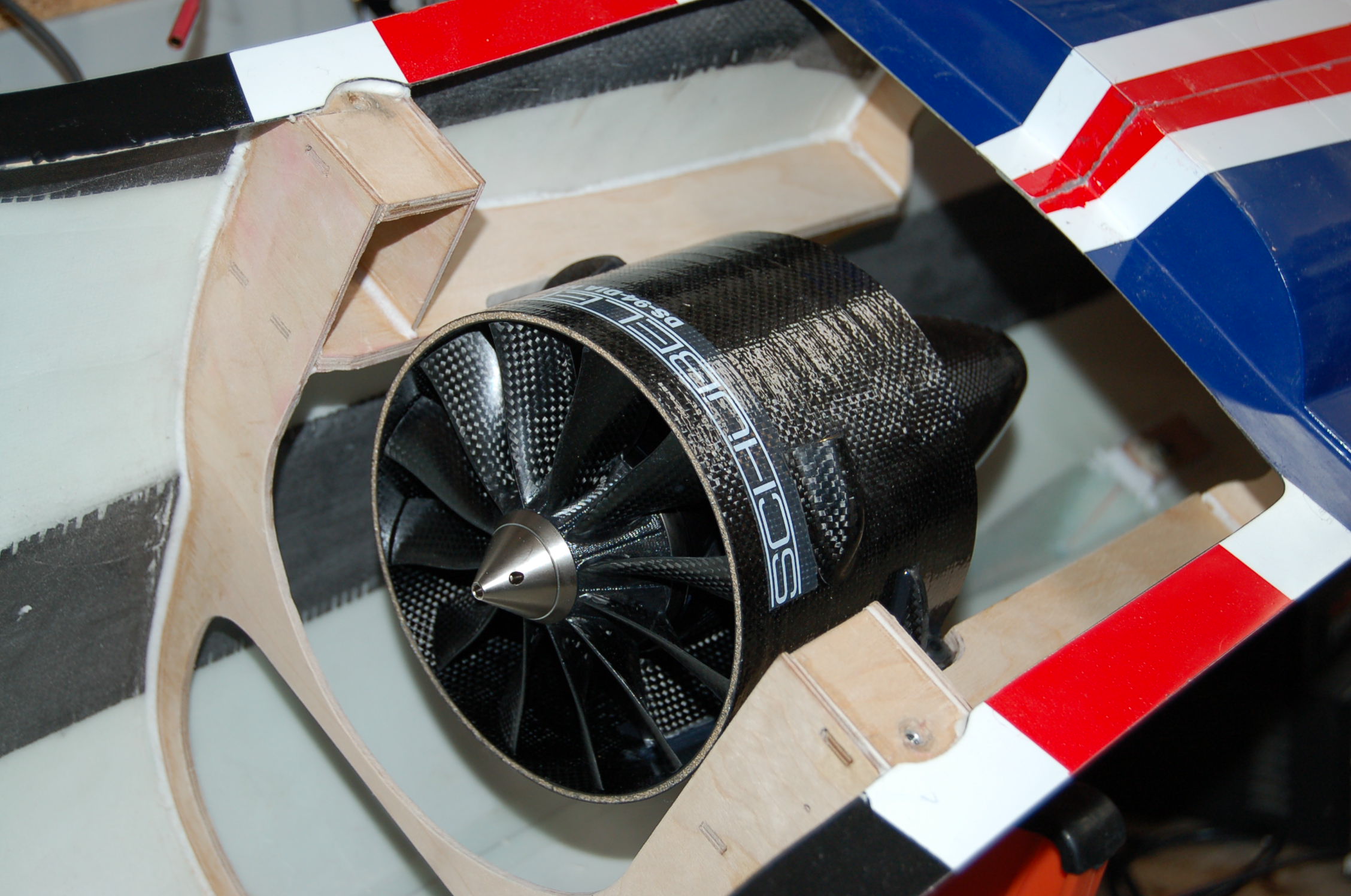

Its a DS-94 powered Hawk I'm building for a friend, 14s 10,000 mAh. We have turbine restrictions at our grass site now and I convinced him this will work, so I'm building this one EDF and he's going to have a second one Turbine later in the year for when we can fly Turbines freely.
Fit out is the quickest time! Should have done all your planning by now, so its 'just' bolt in and go ;-)
This EDF has me scratching again as I have no balance refs and the fan is much bigger than a turbine, so I have dropped the mounting 10mm
Dave
