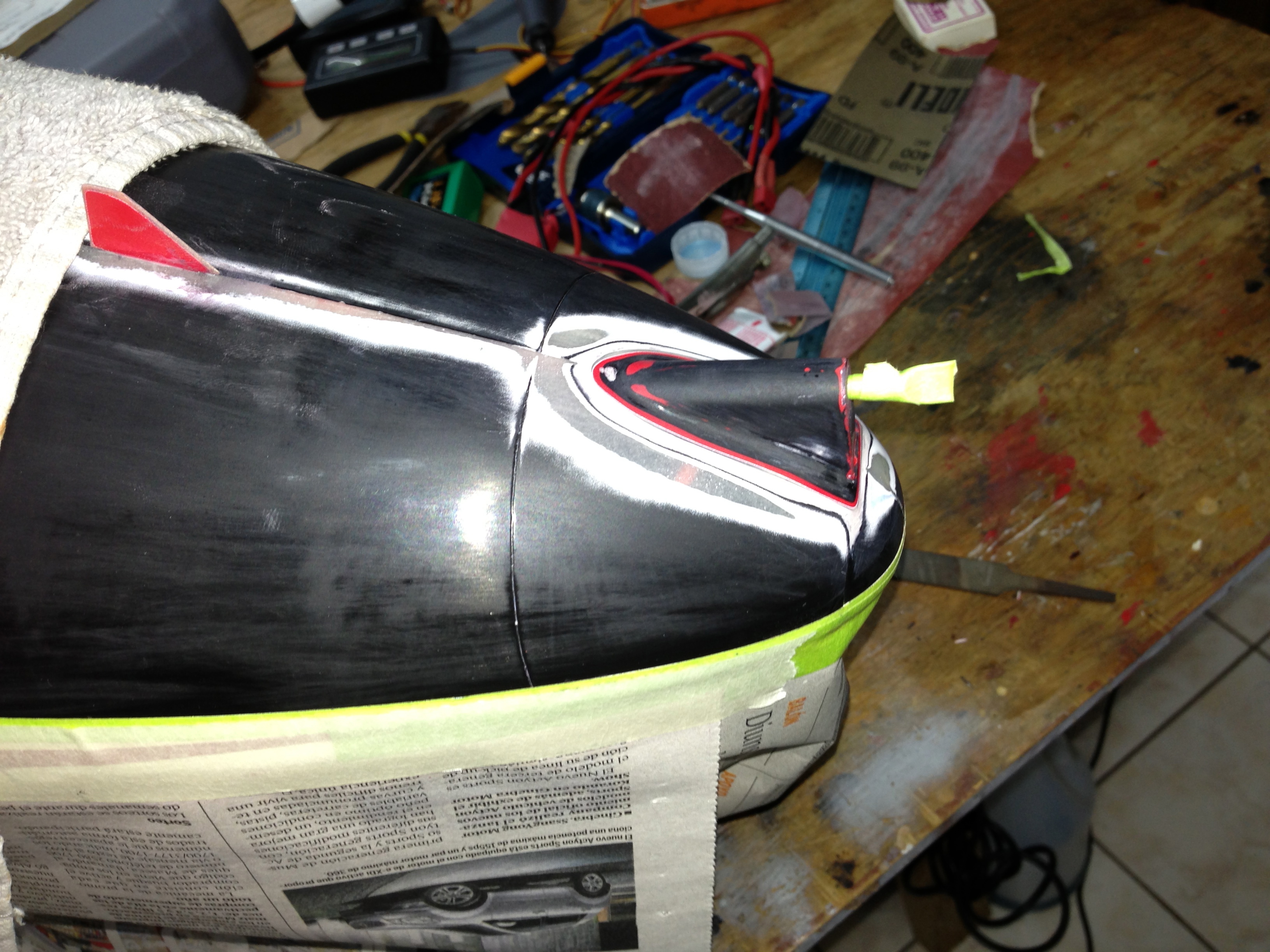

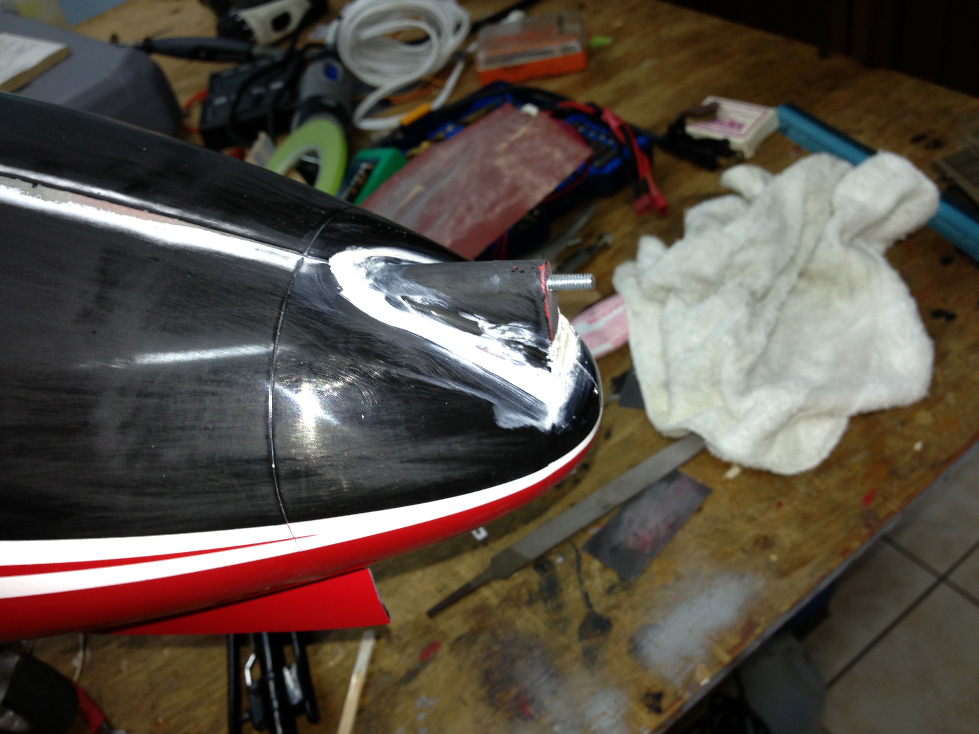

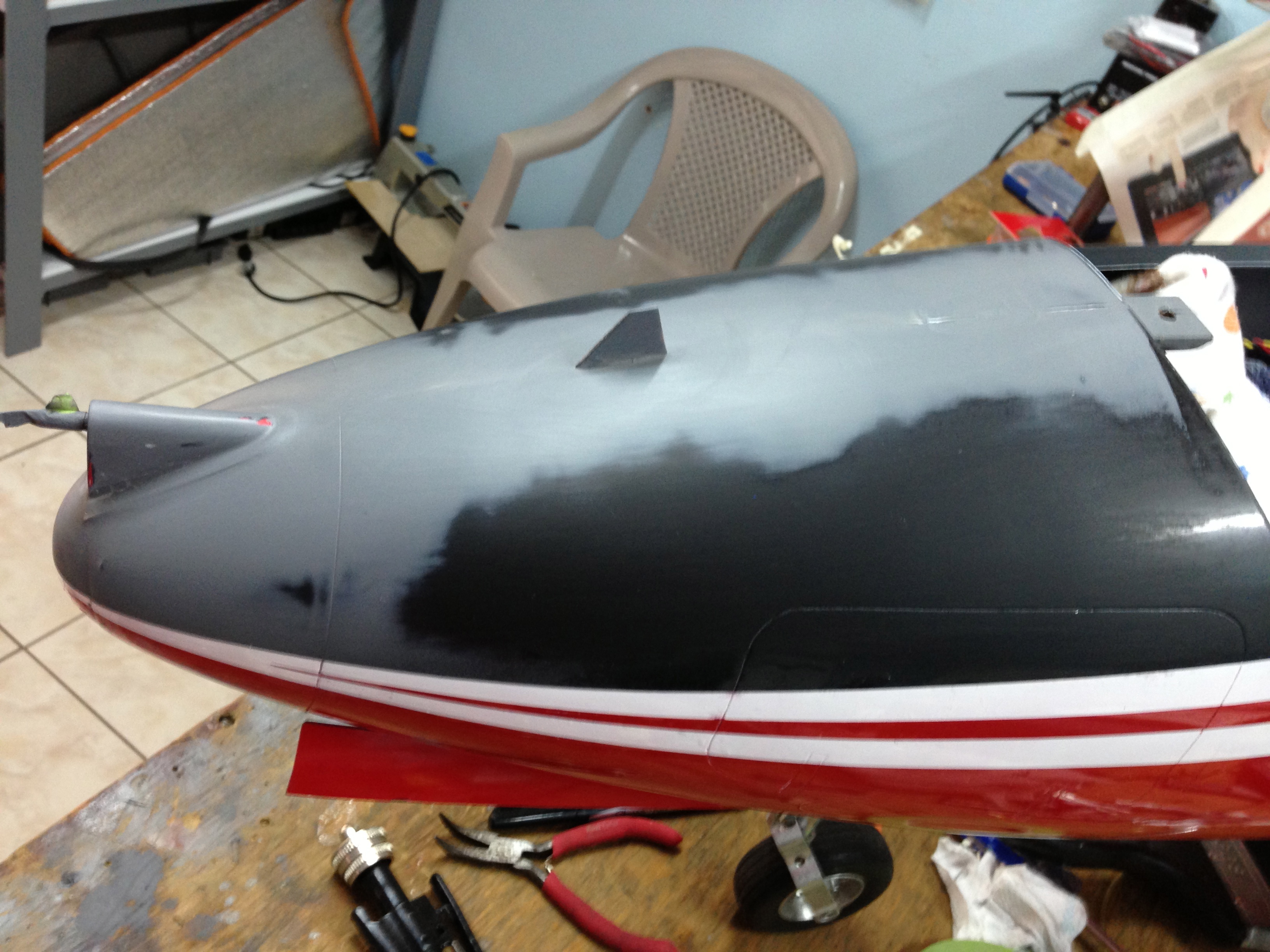

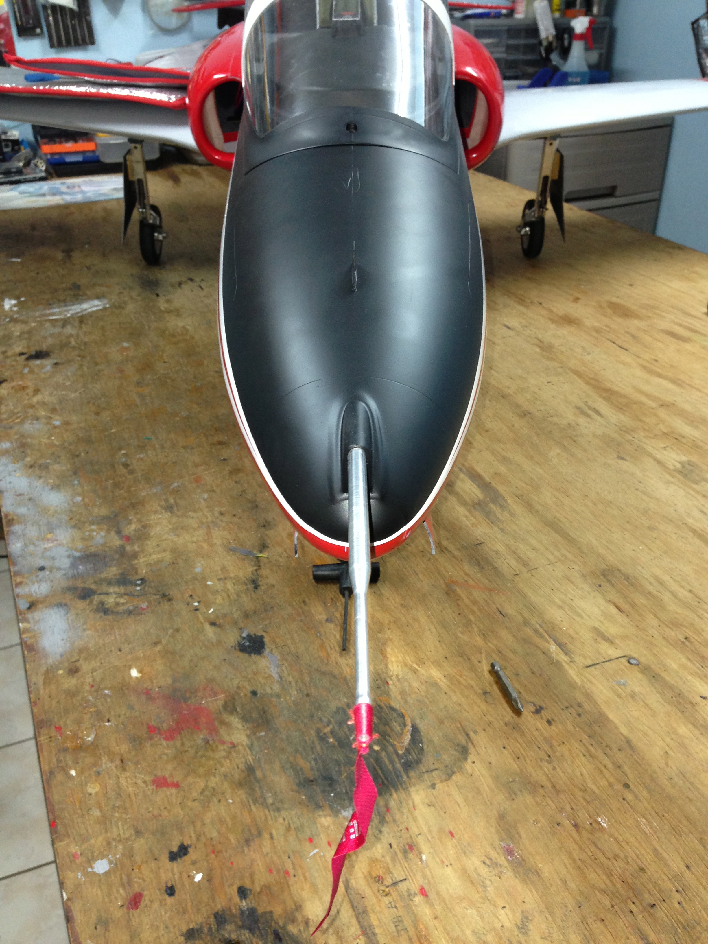

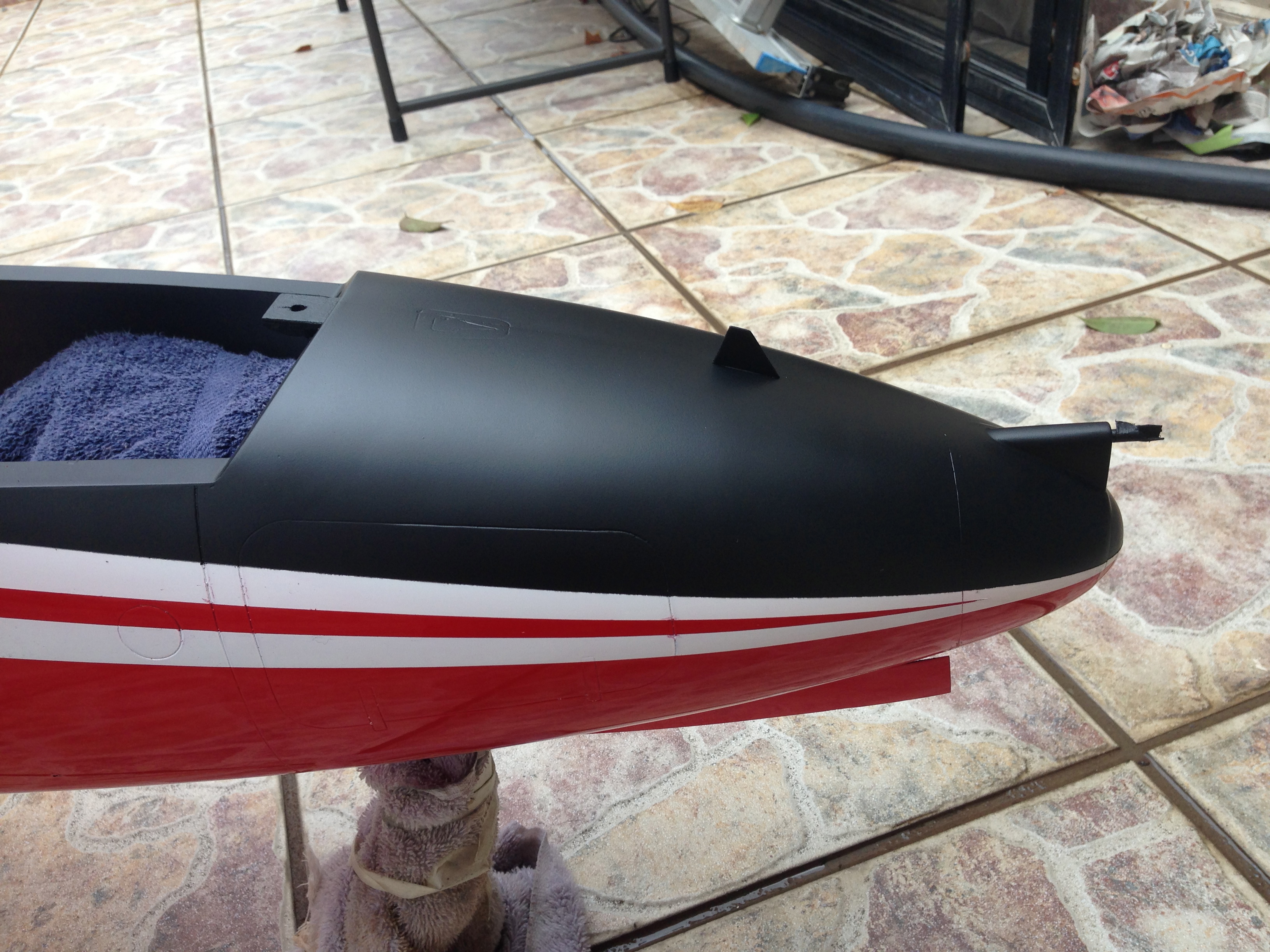

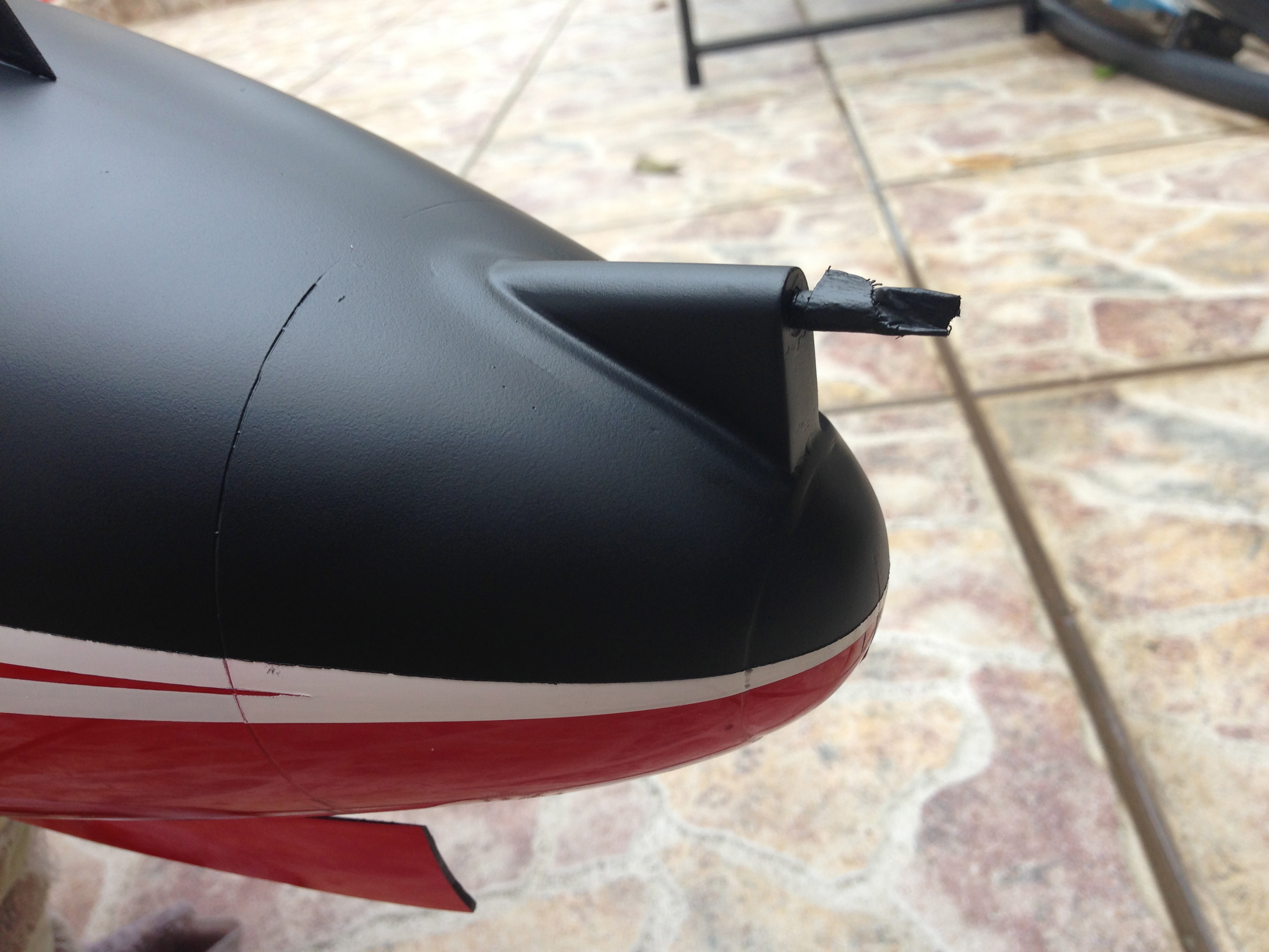

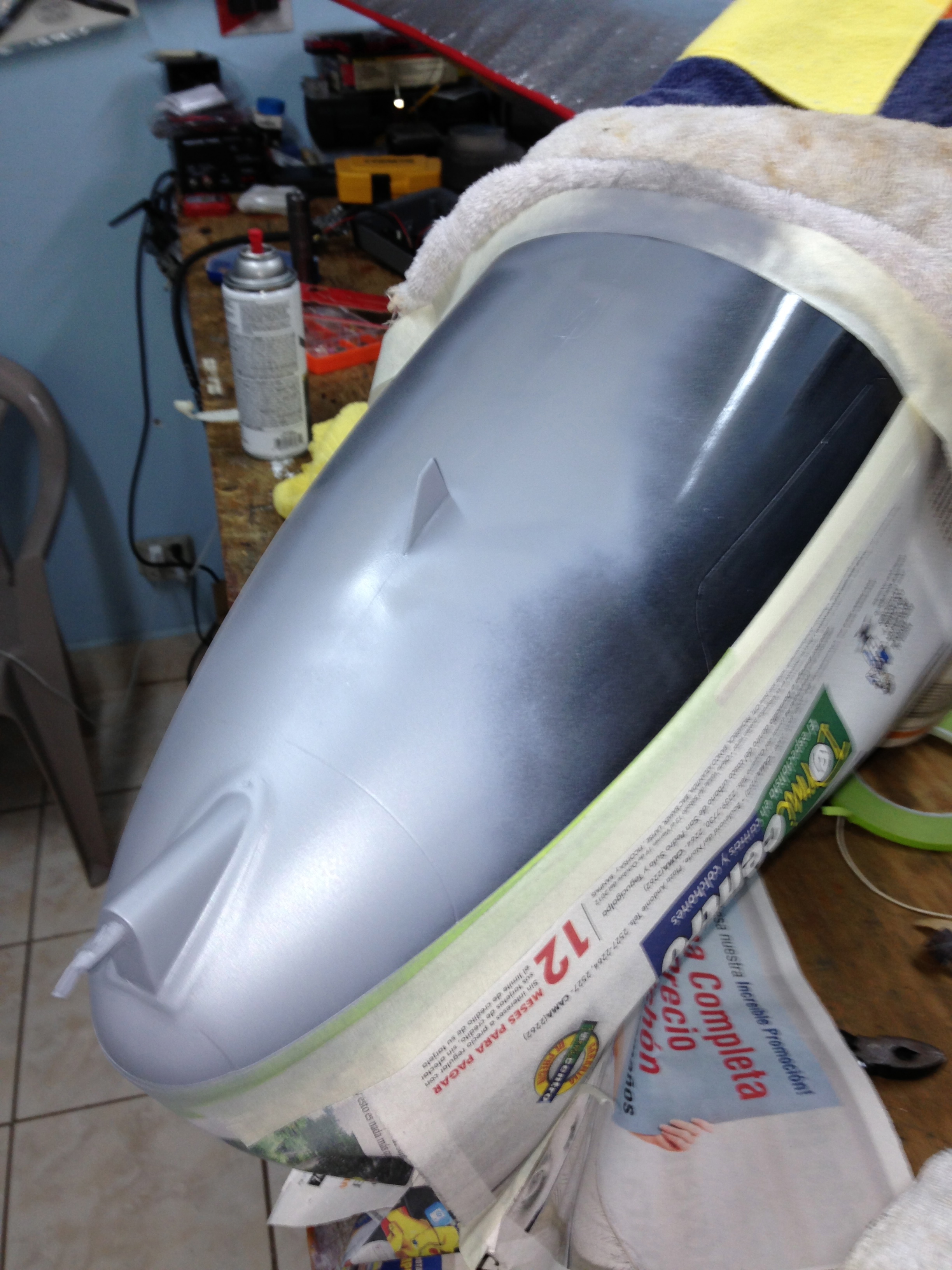

Did Some nose work on the Hawk today.

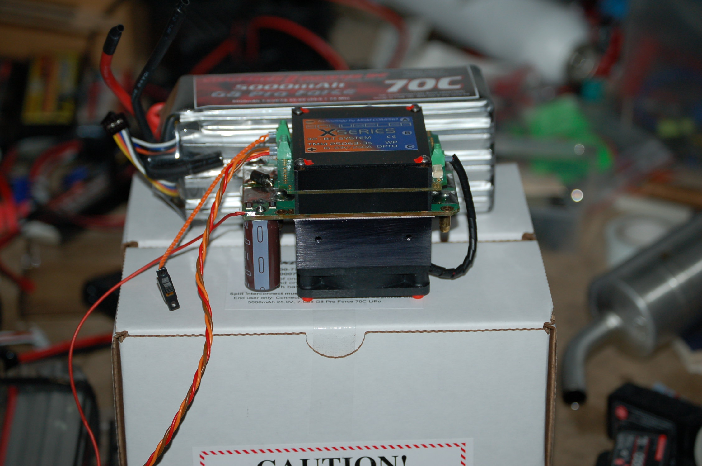

Originally Posted by husafreak

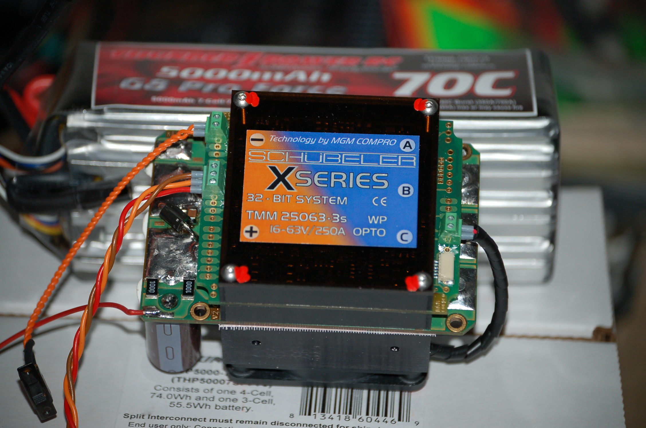

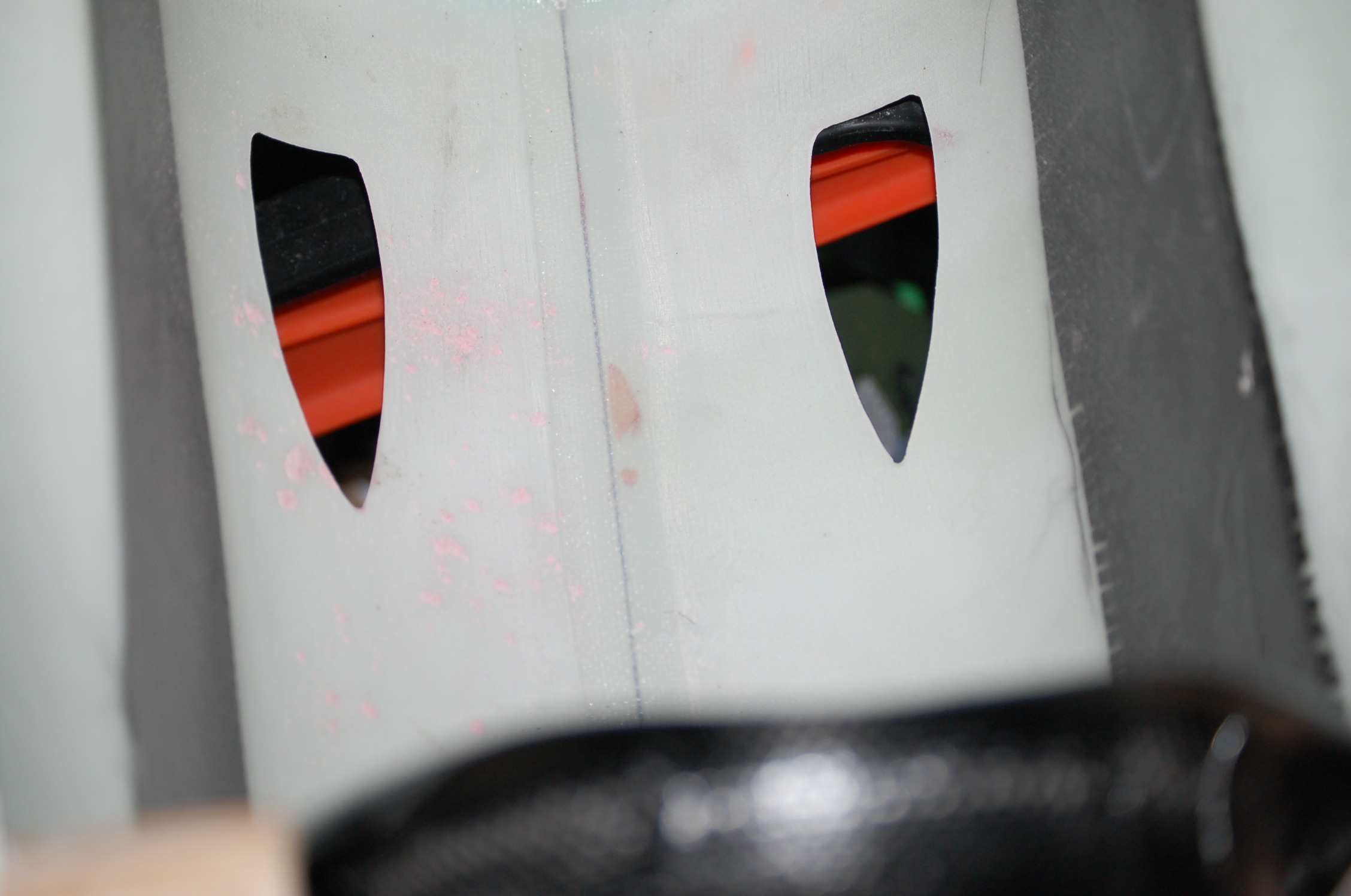

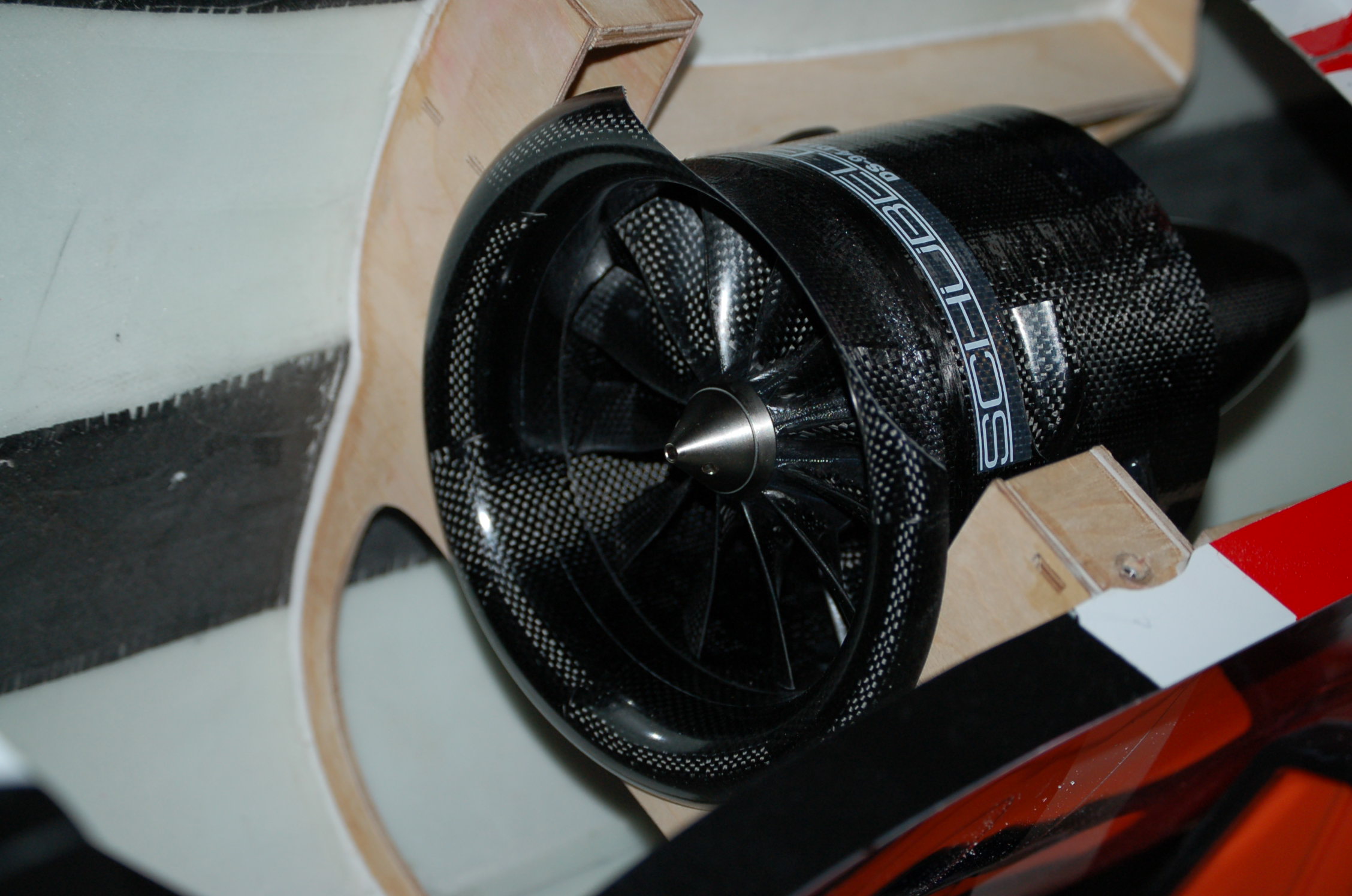

Aw nuts! Came up about 4" short on 4mm turbine fuel line and had to place an order for more... Should be RTF in a couple weeks though.
As for the EDF good luck and I hope you can source a dependable ESC for 14s. It is just too EZ to burn up the big systems. Will you have full intake ducting for it?
No worries on ESC 250A Unit. Big thing about Schubeler is they know their stuff! 4 of these TP G8 packs give me 14s and 10,000mAh. ESC is never the worry, motor temp is everything. In developing the Spark I only blew motors...which took out the ESC each time. The guys in Germany fixed it soon enough.
No inlets, the inlet lip will smooth out air going it. I'm opening up everything for air intake, mainly on take-off. I can get the outlet within 5mm of what we want for the DS94 by removing the small lip at the back.
Dave

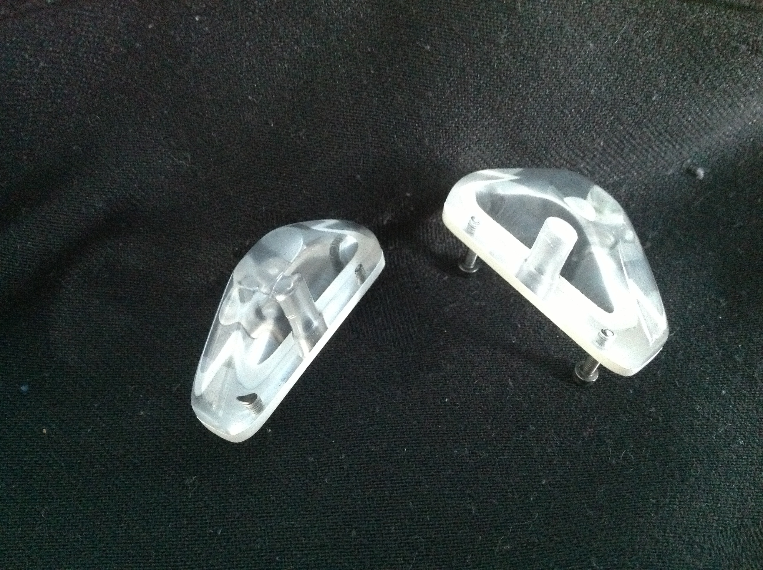

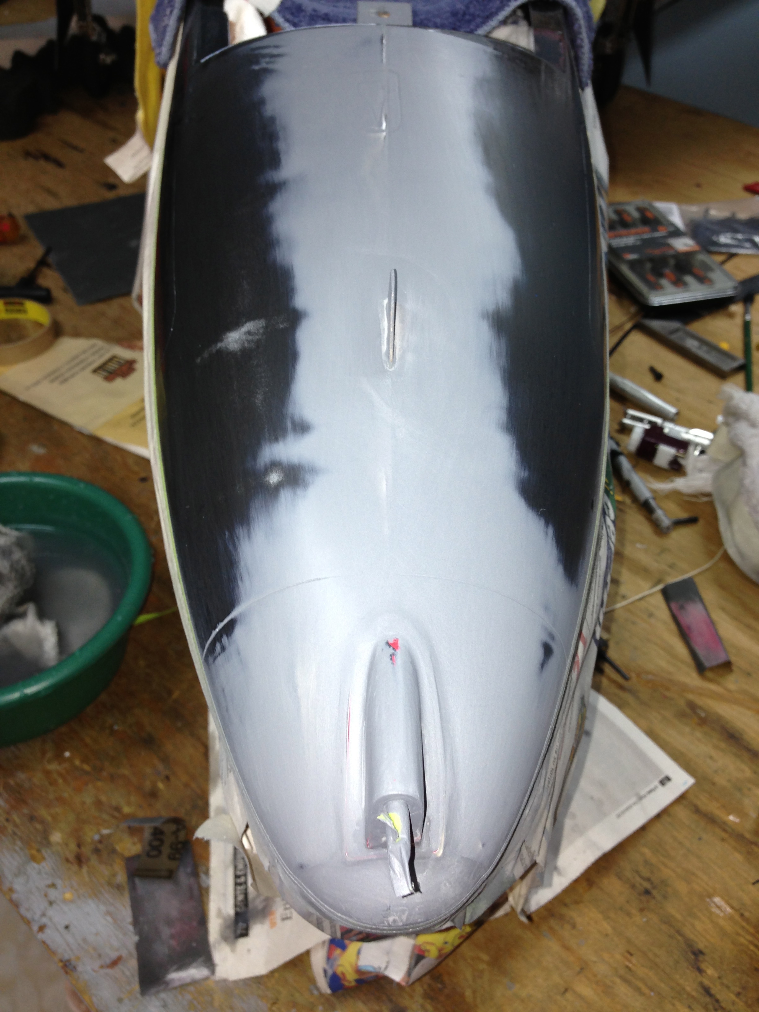

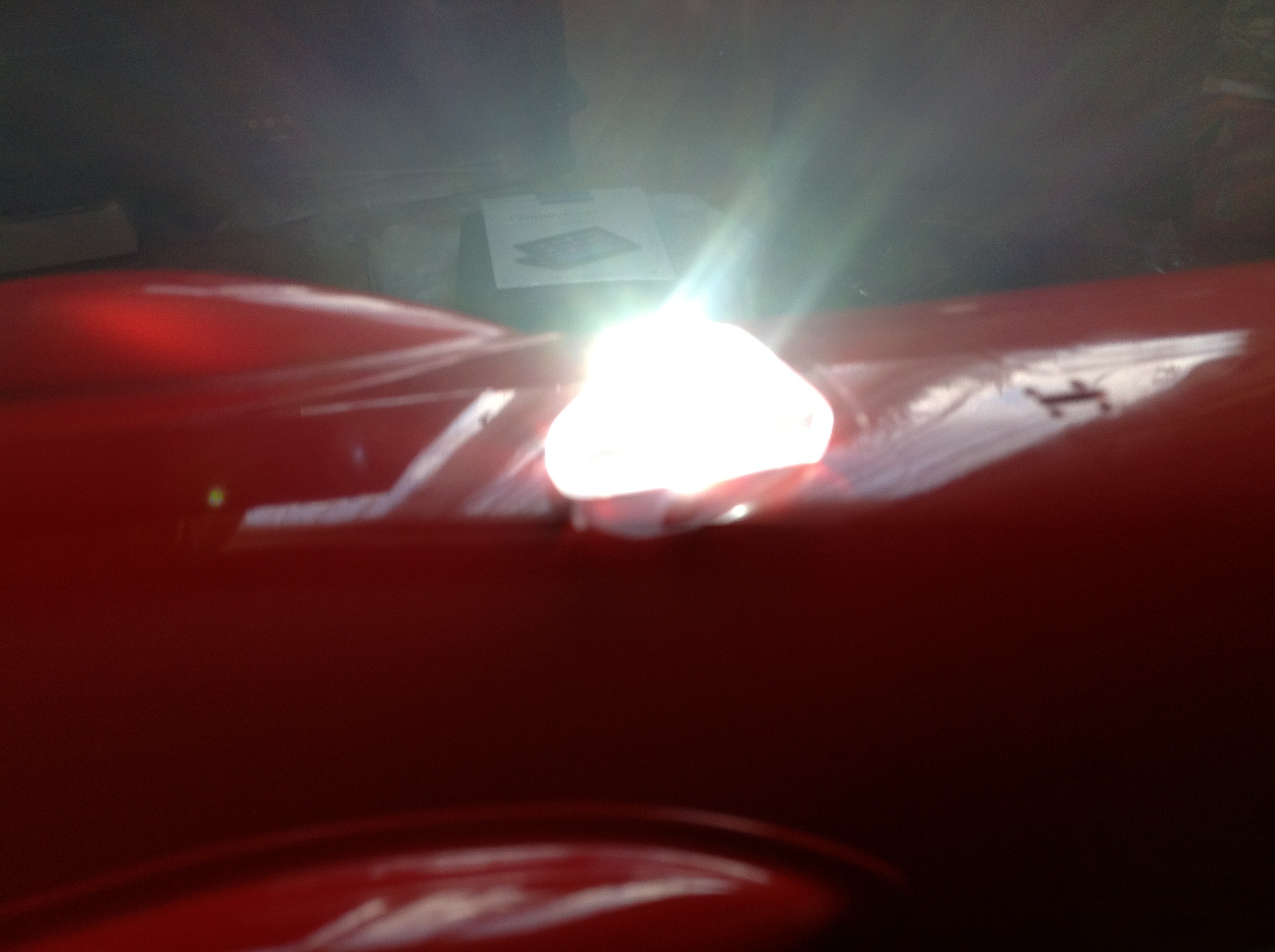

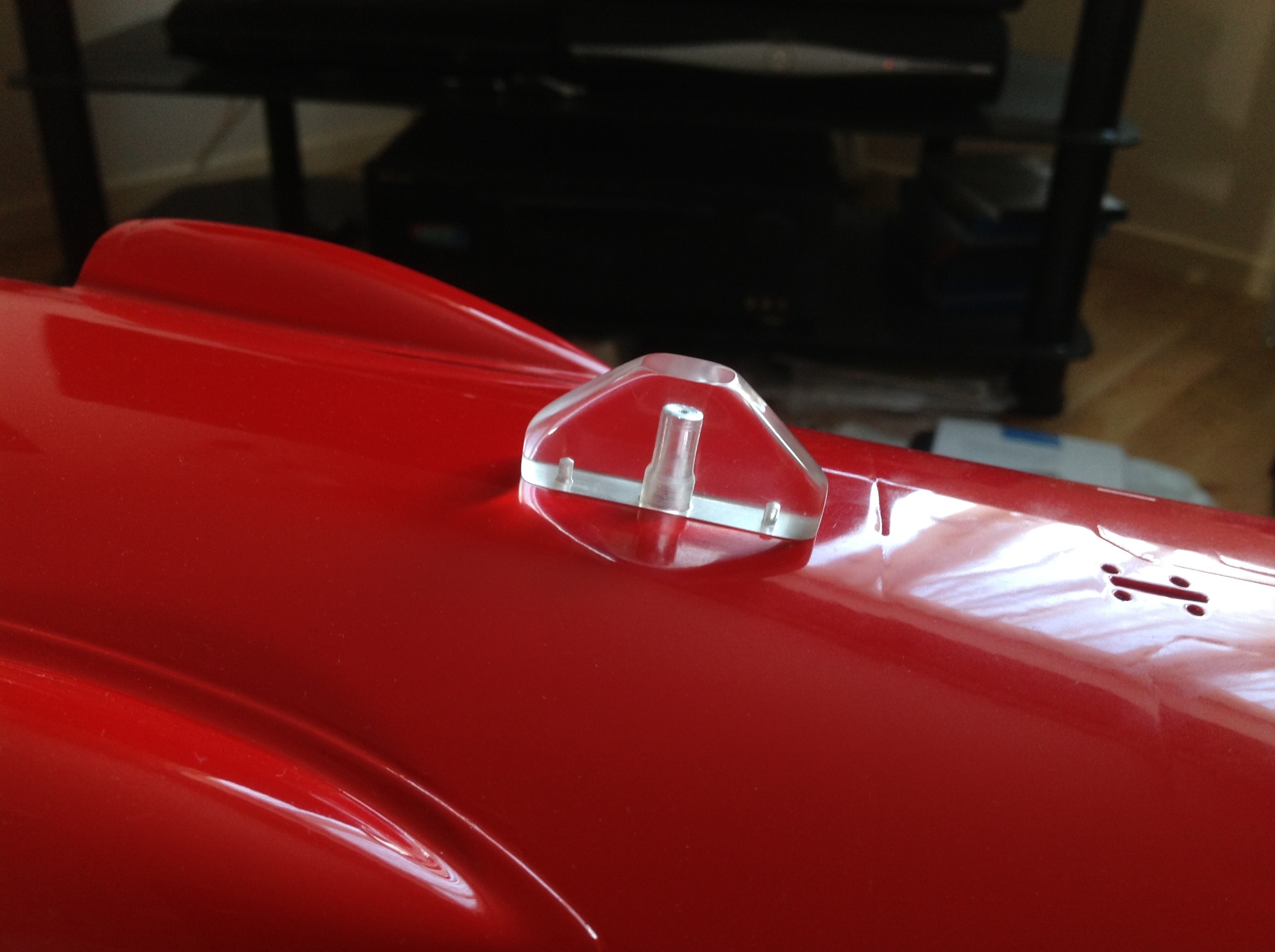

main fuselage painting is complete, so decided to make a set of new strobes (have cut the reflective tube different on this set which makes them a bit brighter than the original ones that I made (not that you could not see those) then I can start putting back the tube and turbine
Last pic the bright led caused the iPad camera to close right down, but up close about a couple of flashes is the most eyes can take before going wonky!
Alan
ps RCU slowly getting better, I found if you add pics with cursor after your last words then it will add as you can see here but if you have cursor in middle of text then your pics end up in that line of txt if that makes sense

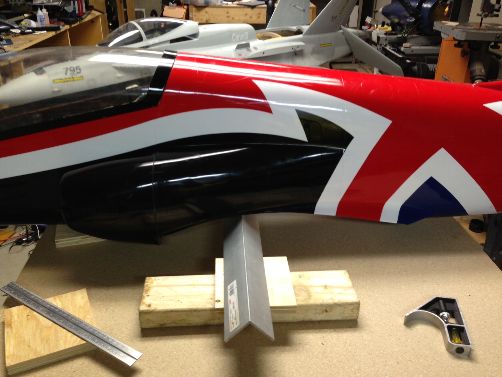

Old 08-19-2013 | 08:51 PM
  #1349
husafreak's Avatar
Joined: Dec 2004
Posts: 1,205
Received 50 Likes on 42 Posts
From: Livermore, CA
I was able to get the fuse to balance at 208mm back from the bulkhead (LE of wing assembly) by putting the Cheetah's battery against the main bulkhead at the back of the cockpit and the two 2300 LiFe Rx packs just in front of the electronics tray. This is with the DerJet cockpit tubs but not the BVM pilot... I am using the stock pipe and the Cheetah, which is a light engine, smoke tank below the main tank. I did the two door nose gear instal so that added a bit of weight up front. So I have to get the pilot figure as light as possible but ultimately I might need to move all the batteries to he bulkhead. I don't like the idea of mounting the batteries on the fuselage sides but it is an option. Anyway CG is really close so I am pretty happy! I have all the plumbing in and the EV5 works the gear and doors like a charm. I put two of the large Robart air cylinders in above the main tank, the EV5 uses one for brakes. Just need to secure all the bits now and it will be go time.
