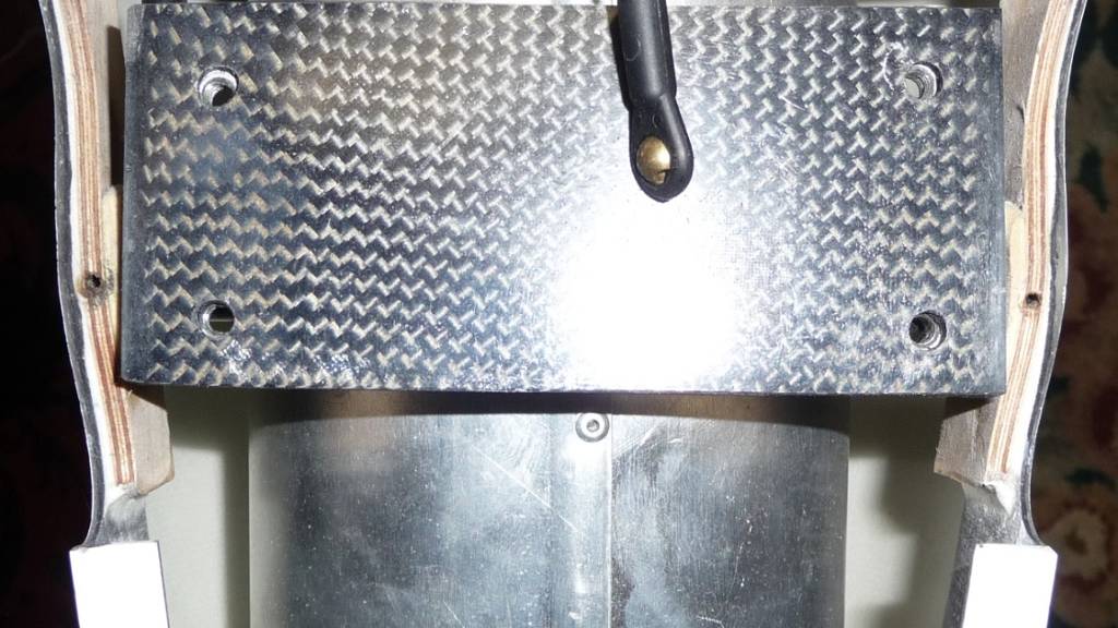

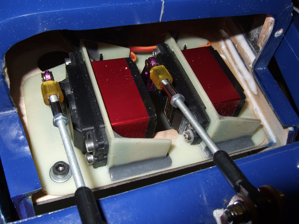

Some pics of the fittings I made for end of carbon tube also the servo mount I made out out FG board as the wooden ones in my kit.... well I would not use them for what they were intended for...
Also made bushes for the purple servo arms (Phosphor bronze) so there was zero play in clevis. Grey glue is Hysol 9461 same tear strength as 9462 but works out a lot cheaper I buy it in tubes of 200ml (400ml total)

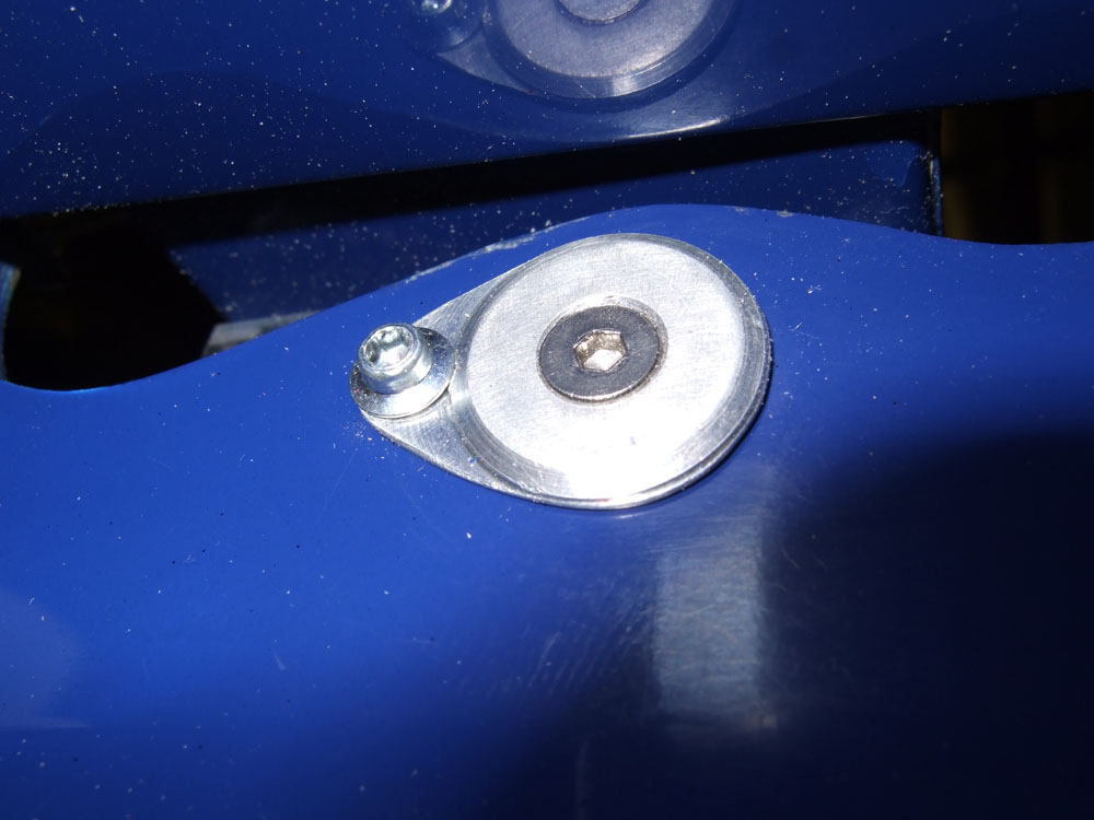

My tube was cut flush and pinned, it looks like an extra inner piece of plywood was added to take up the slop.
In the photos the pins are removed I need to install before the final assembly.

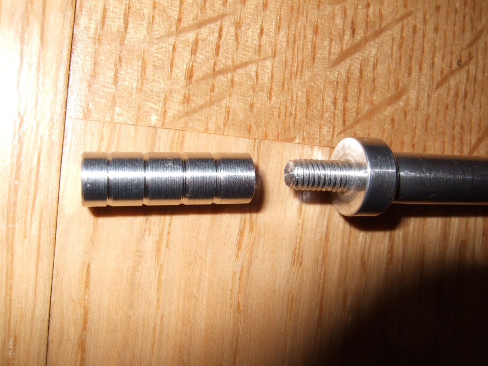

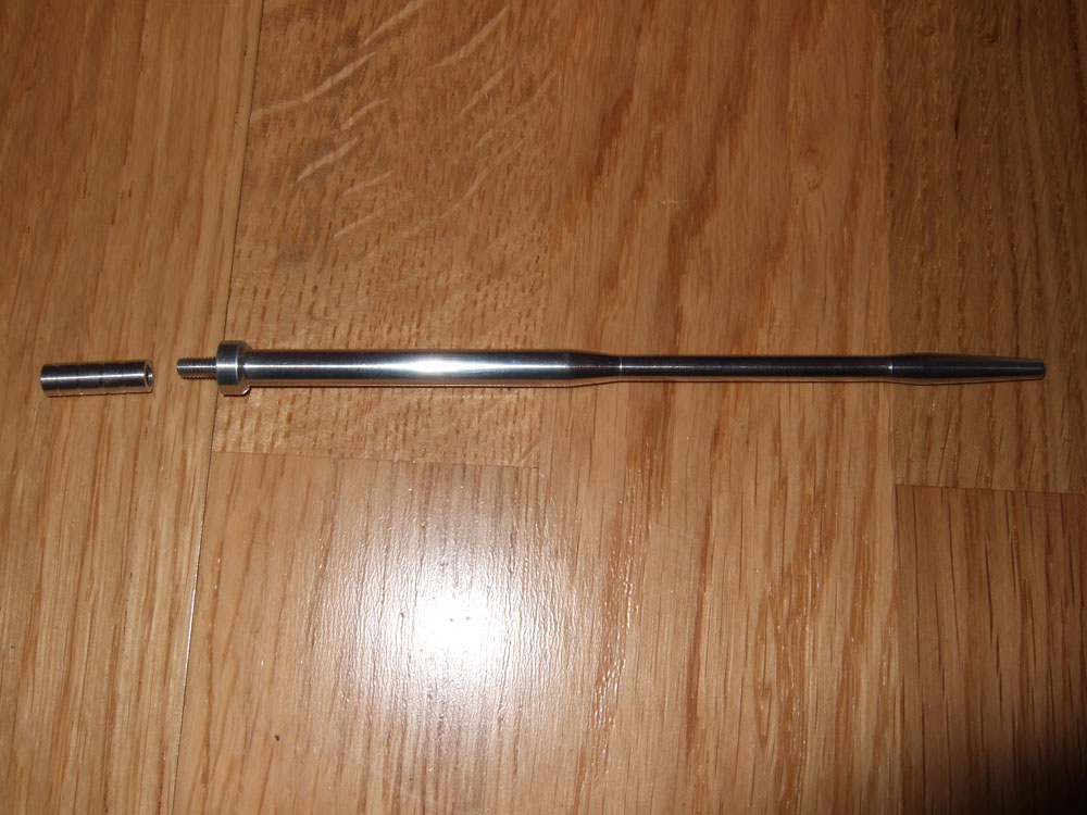

TUCSON (Stan)
Your pitot probe for your CARF Hawk is finished, will pack into a carbon tube for protection then it will be on it's way over the pond!
Alan
