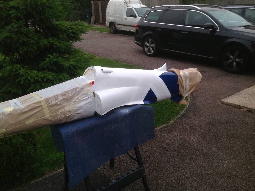

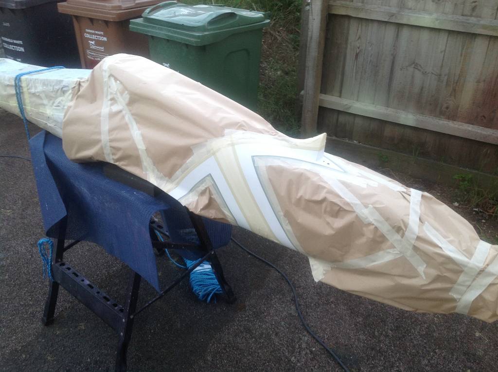

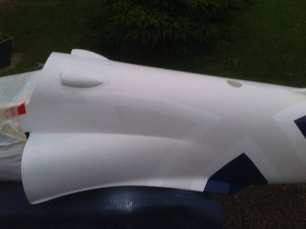

I am certainly getting tired of wrapping and unwrapping this Hawk! Has taken a good 2.5hrs to mask up for the white bands...painting in am as soon as temps are up
Hope this is going to be worthwhile when she is finished... Think the next one will be all grey!
Alan

Old 06-06-2013 | 04:31 PM
  #1242
Joined: May 2010
Posts: 158
From: Herveybay, AUSTRALIA
Default RE: Comp ARF BAE Hawk build thread
What type of paint are you using on it ?
Old 06-06-2013 | 08:31 PM
  #1243
fireblade5437's Avatar
Joined: Dec 2005
Posts: 974
From: Leicester, UNITED KINGDOM
Paint I am using is by Lechler (Italian company) 2k Macrofan/Isoakryl with a white 2k primer which is needed for the red as this red is very bright. Mix is 2:1 with 15% 2k thinner, this type of paint covers very well and does not need to be heavily sprayed on to achieve good results
Alan
