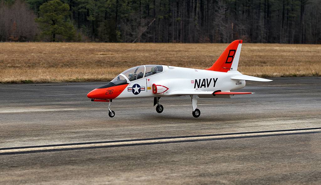

Finally got flights three four and five in yesterday as it was a warm day for this time of year but we had heavy fog and a low ceiling till the early afternoon. I just felt the need to post again how this plane flies so well. I guess that's why I see so many at the jet events. Do most Hawks fly this good? It just goes where you point it and seems to have no bad habits. We had nearly a breeze yesterday and landings were uneventful. Just a happy customer.
Marty
Marty's Hawk looked *really good* on our last outing - which, with Marty at the sticks means that the darn thing must basically fly itself!
Bob

ORIGINAL: rhklenke
ORIGINAL: afterburner
Marty
Bob
Well I could probably come up with a few or maybe more than a few smart ***** comebacks for that statement but the truth is it does practically fly itself.
Marty

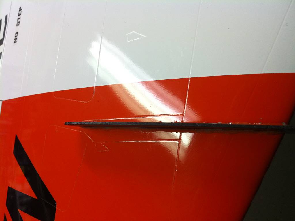

I finally drew up the wing fence in AutoCad, from your photo it looks like yours is mounted at the intersection of the red with the white paint can you confirm.

ORIGINAL: RCISFUN
Hey Marty
Hey Rich,
Here's a pic. I think Dave mentions in the manual that it goes where the rectangular panel line is as you can see in the pic.
Marty

I just hope I get those suckers glued on straight. I would imagine the wing fences and fuselage strakes would be a destabilizing force if not aligned correctly...

Funny you should say that because that's a picture of the side that went on straight the first time.. The other side was not so lucky and had to be snapped off and re-done.
Marty

Hey Marty Thanks for the photo!
I really hate to have to put these on as they don't belong on the Goshawk, so I think I will have them laser cut out of clear polycarbonate, that way you'll never see them on a flyby
I downloaded the manual and found the reference
Additional Fences and covers
Your Hawk kit includes various parts cut from a color coded glass sheet. The wing
fences are an important feature on the Hawk. The glass fibre fences are fitted to the
wing leading edge just outboard of the aileron/flap break line. If you project a line
forward from the aileron inner edge there is a rectangular panel approximately 12mm
wide and 60mm long marked 45mm back from the leading edge. The wing fence is
mounted centrally on this panel using thick CA or epoxy.

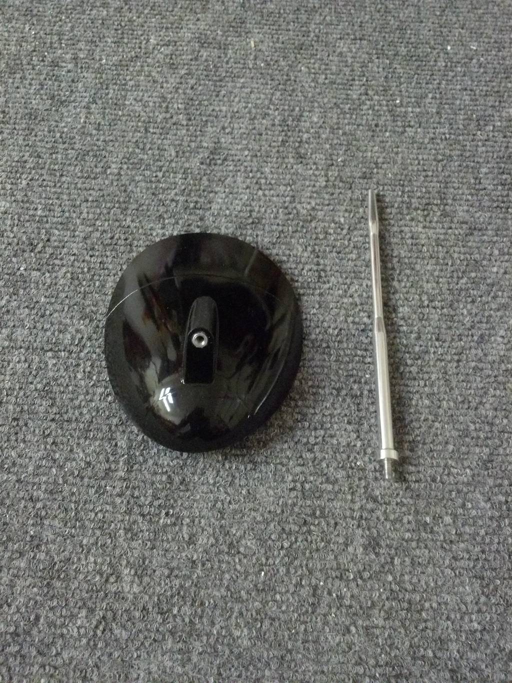

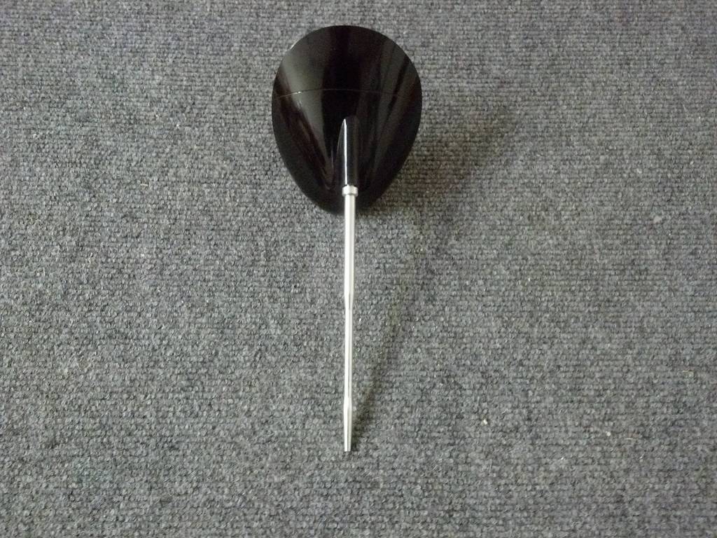

Here are some images of my new probe that Alan Cooke (Fireblade 5437) has made for my Hawk.
The probe is detailed in every way and fits perfectly into the nose piece that Carf supplies with the kit.
It is removable as it does screw into a fitting that Alan made to insert into the nose piece
In the 3rd picture no sooner then I temporarily mounted the probe fitting on the nose of my Hawk it tried to mate with my UF
Can't wait to get it back in the air.

Steering is not a problem, I have a BLS352 on mine plenty of torque (had a spare one) only have enough travel that you really need. This plane tracks as good on the ground as it does in the air, just make sure you have a small amount of toe in on mains
Stan, glad it arrived in one piece or should I say two!
