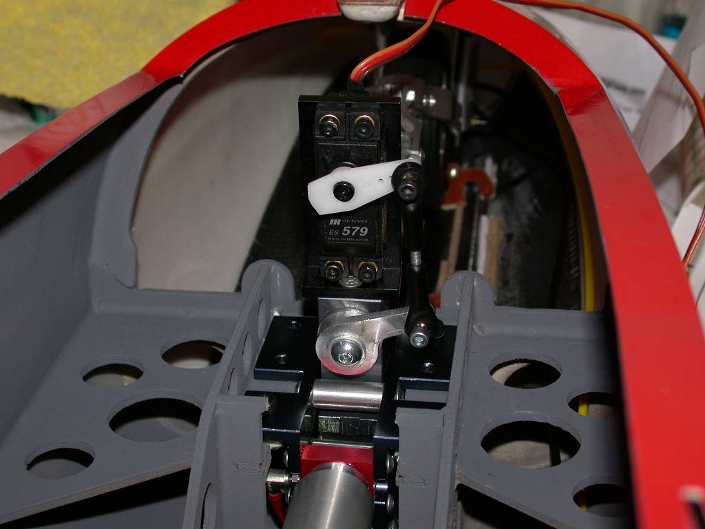

Nose gear doors driving me nuts! any one got tips or close up pics of the door ? not sure if im putting the hinges on the doors in the right location, the first try i had them too close to the edge and the hinge would hit the fuse when trying to open, then i placed them further in but when i try to swing the door open the door edge hits with the fuse opening. The manual says to keep the hinge rod straight but when i placed the supports to maintain the rounded shape of the door the rod follows the shape of the door.
any help greatly appreciated.
Thanks!

ORIGINAL: Kenrico
Thanks!
This is the manual model as I did it. You can pick up some points. The hinges need to go against the fuse opeing when fully open. The rod goes from almost at the skin from the rear to packed off at the nose. I then tacked front and back hinges only to the door with CA and then swung the mid hinge into place and packed.
You can just see the packing under the white pivot tube (added after the wire has been tacked in place. I put the white tube on the wire spaced around the hinge positions.
Dave

Dave, Thanks for the tips!, I found what was causing my problem, the mid hinge. I was tacking all 3 hinge on before going in trying to tack the tubing in on the fuse, after a ton load of trying different hinge positions on the door i decided to remove the mid hinge and just try the forward and aft one and it works perfectly free as it can be no binding, so I'm thinking if it would be strong enough just with those two hinges ?
the problem the mid hinge was causing is it would force the rod upwards when i try to open the door, now I can see in your pics that the mid hinge does not sit flat on the door like the other two.

I'd keep three, I went that way as in flight the load is high on the doors, look at the open shot and you can see they are spread slightly (this is good as it keeps them clear of the nose wheel) I packed the third hinge with balsa and its been good for hundreds of flights mine has had.

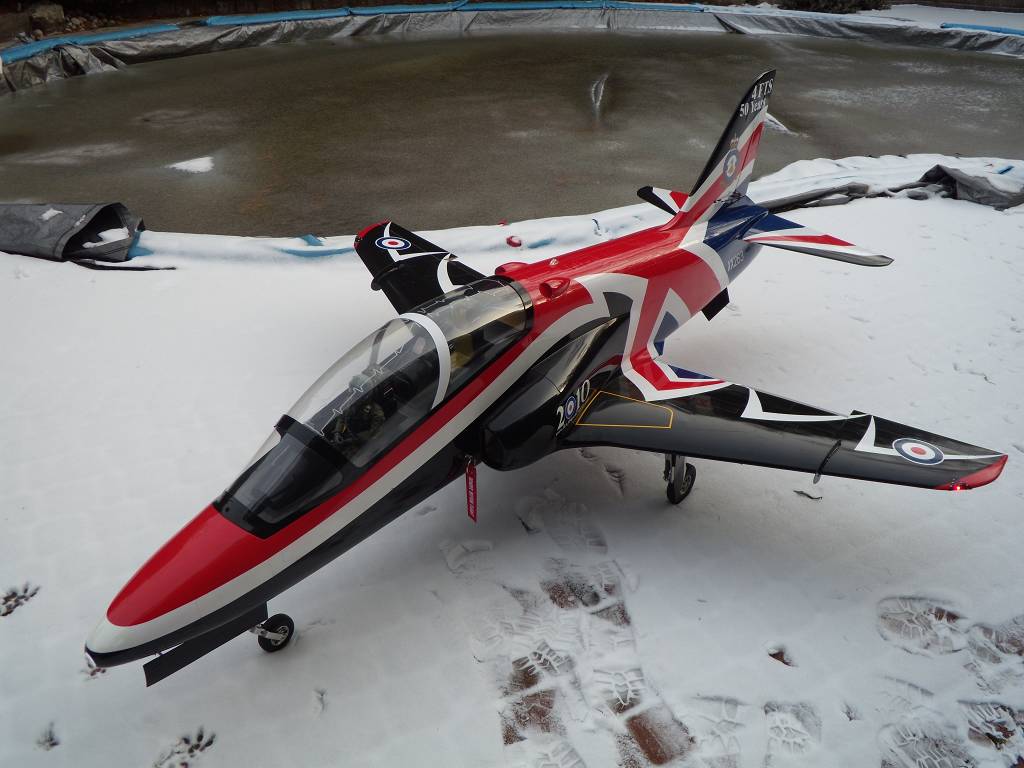

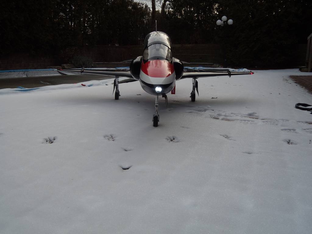

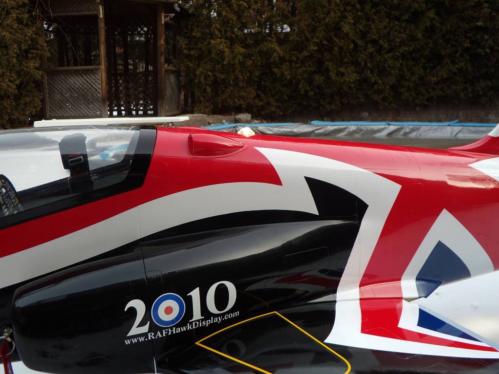

Been doing some upgrades on my Hawk over the winter months. Added FEJ cockpit, scale pilot and canopy hoop. Repainted rear fin to properly accomodate the decals from Tailormade. Added nav. lights and landing light and fuselage scoops.
Overall weight gain was 1lbs as I was able to remove my 9oz of lead balast from the nose. All ready for the spring
Mike

Old 01-19-2013 | 07:13 AM
  #1011
luv2flyrc's Avatar
Posts: 1,694
From: Mississauga, ON, CANADA
Default RE: Comp ARF BAE Hawk build thread
A few more

Nice, would you mind sharing where you got the lights from? How was the cckpit fit ?

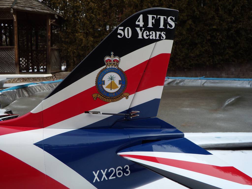

That looks just great! Good job on the tail. I have a complete set of touch up paints from CARF and the Tailormade decals as well, I plan to do the same. Did you take the fin down to primer or just the part where the new paint is? I have also ordered the Derjet cockpit but where did you get a pilot figure? Did you make it yourself? I am looking at another 4-5 weeks for my kit to be delivered (paid for last Nov) oh well, great anticipation!

luv2flyrc's Avatar
Posts: 1,694
Thanks guys! Gary, not to worry yours looks great too!
The cockpit is the 1/5.5 scale FEJ one, I had to "stretch" it about an inch and widen it about 1/4" to fit. The pilot was from a guy who advertises on RCU. I think he makes(assembles) them himself.
I'm hesitant to say where the light kit is from because I've been disatisfied with the service and can't recomend him....at least yet. I ordered the light kit and Hawk accessories kit back in Oct. and received it 3 weeks later than promised and it was missing a bunch of key parts. After numerous emails and promises to ship the parts, I still do not have them. Subsequent emails went unanswered until just this morning, likely because I got annoyed and filed a Paypal disput with the vendor just yesterday. I've been told the missing parts will now ship Monday....we shall see.
I only had to partially paint the fin. The top black area was painted and extended to cover the top white stripe. A new white stripe was created below that by cutting into the existing red area. Only these areas were primed. it was not necessary to shoot red or blue, just the top black and white.
Mike
