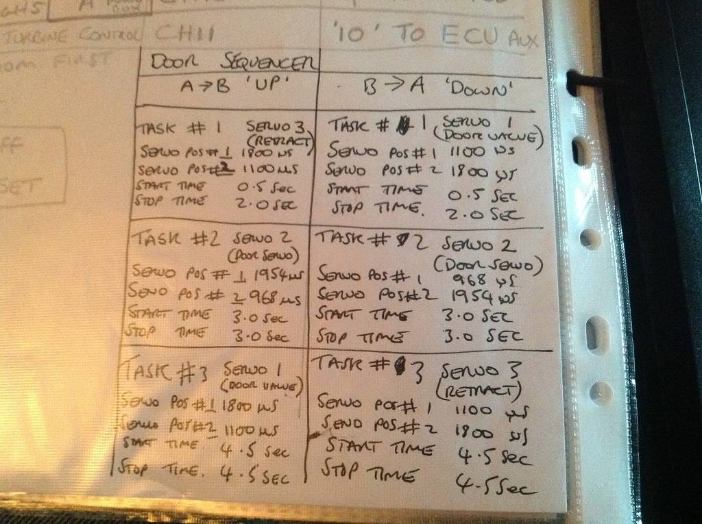

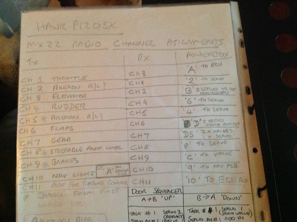

Ok here are my settings for my Hawk seems ages ago since I looked at this!
Alan

Just to mention that task #2 door servo is operating the small front door...
Alan

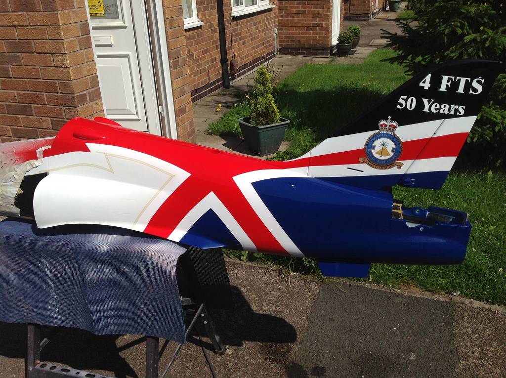

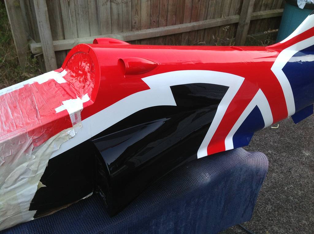

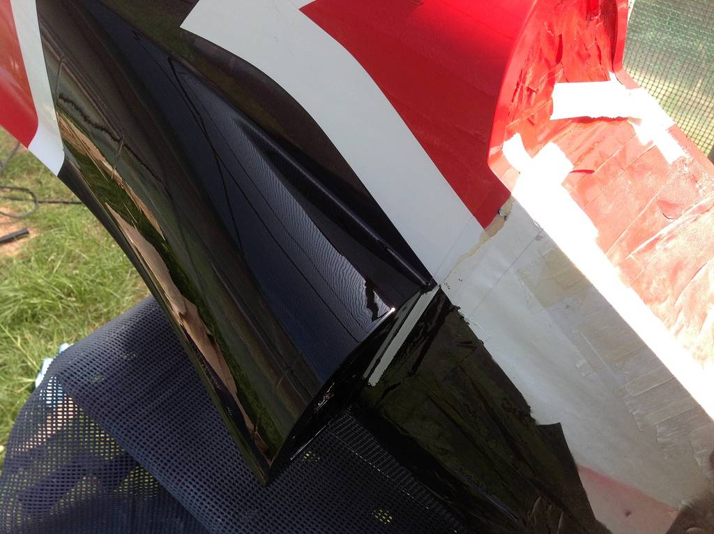

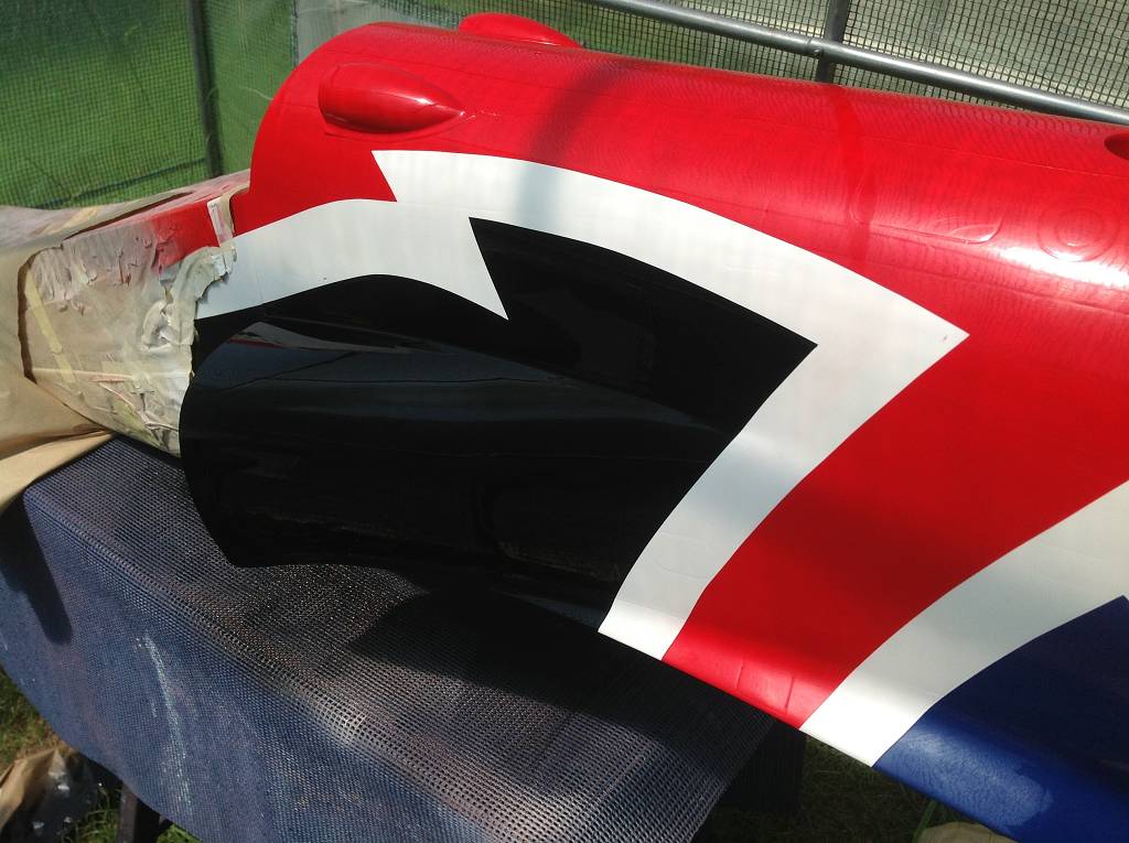

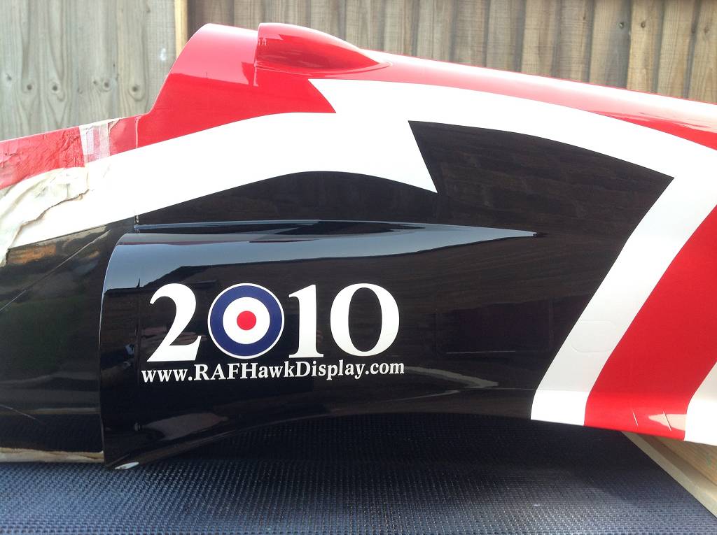

Ready to go for black!
Will have a look at a light set for you and see what Parts I have in stock, will let you know!
Nice and hot today so sprayed the black, i know i should be flying but that's not getting the Hawk painted...
Alan

nice work looking good 2 pack looks great finnish .

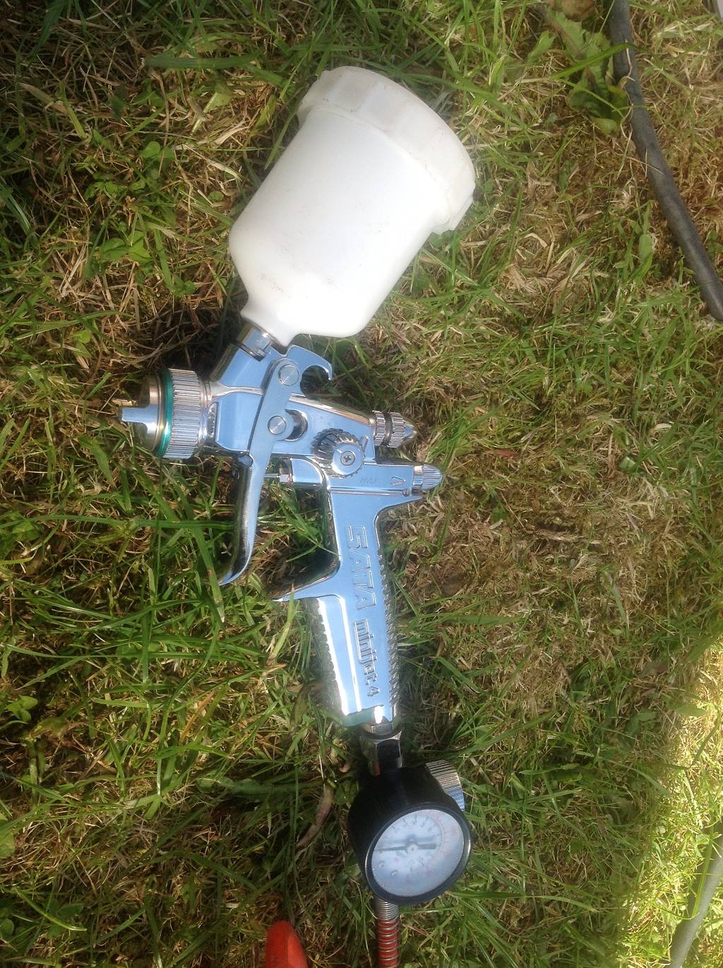

Thanks, combination of 2k paint and Sata spray gun!
Sprayed both the jet intakes in 2k primer and found as per fin and rudder plenty of pin holes so had to give a coat of Upol and fill the holes now ready for another thin coat to see if they have all been filled plus to reveal any new ones!
Alan

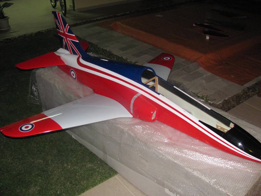

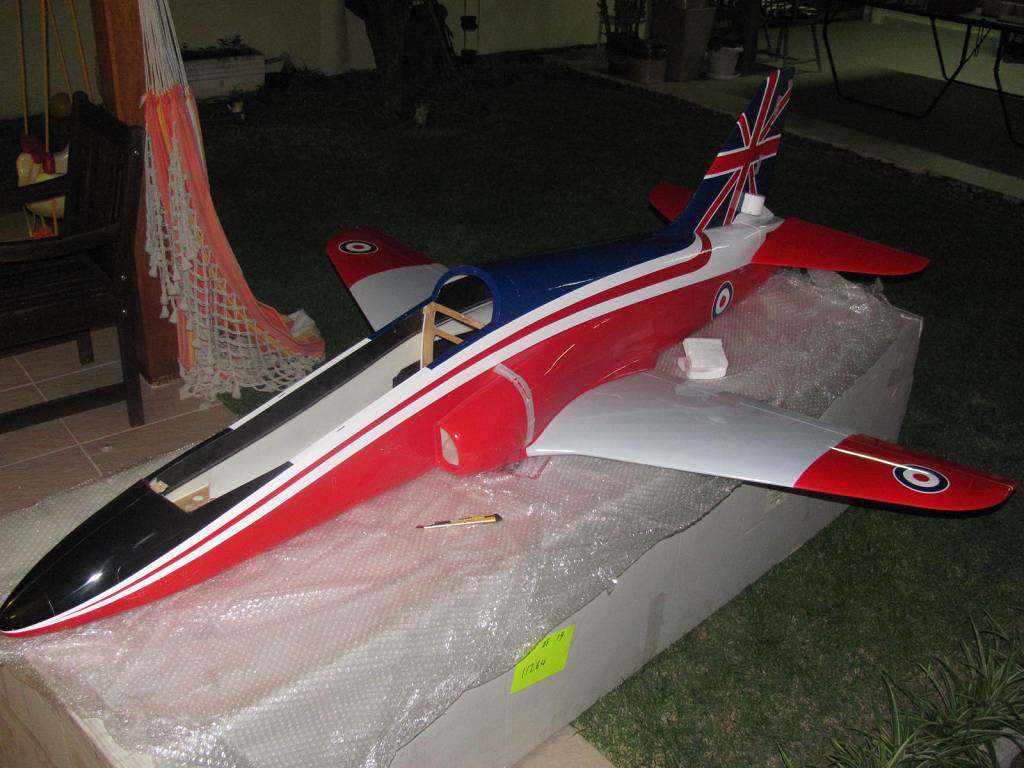

May I join the club

You may its a great airframe enjoy it.

ORIGINAL: mjunior
May I join the club
Anymore help just say
Regards
Dave

Building is straight forward, the hard job is chopping up that cardboard box! [:@]
Enjoy
Alan

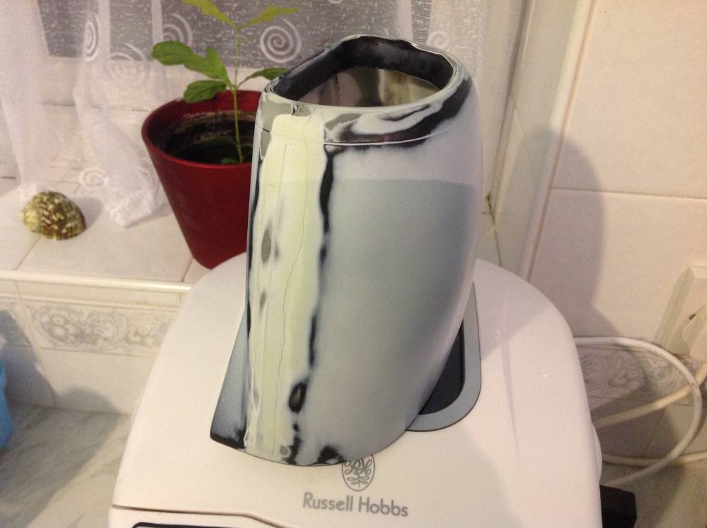

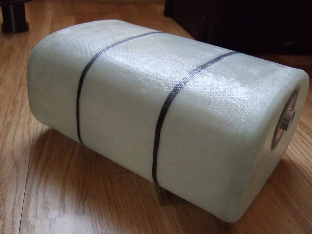

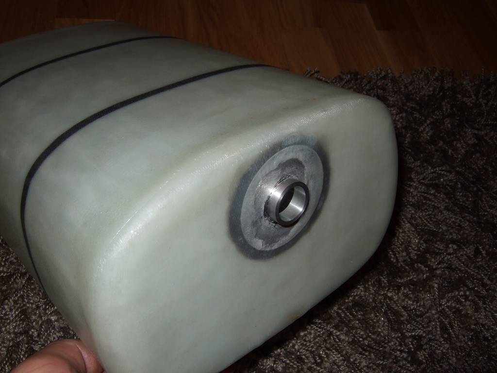

You could always make your own! I made mine with blue foam then melted it out with thinners, I was aiming for around 4.5L but it actually cam out @4.8L
I used two layers of glass cloth with carbon twill in between both layers, also turned the fittings. The resin used was West System Expoxy
Alan
