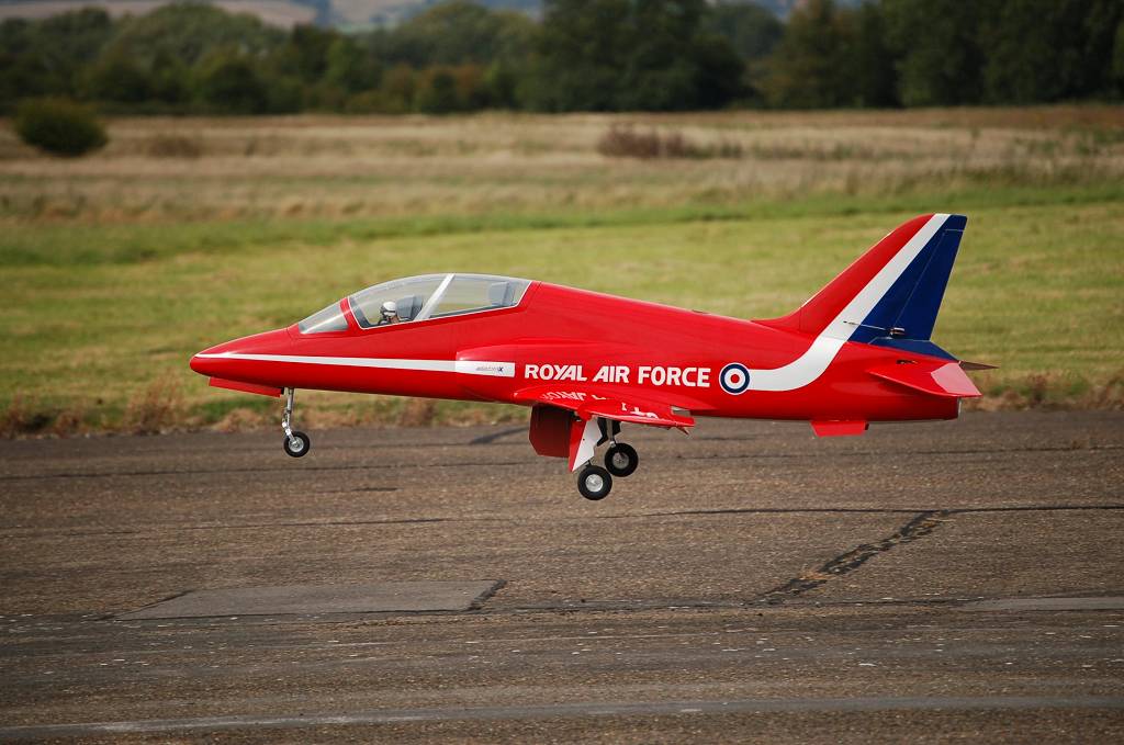

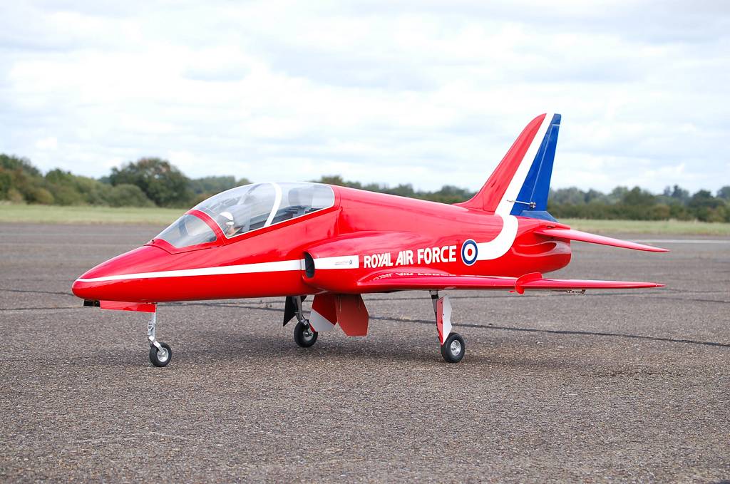

As Paul's photos, I flew the Hawk again today, both at Chalgrove and after a 50 mile rush at our local club Bar BQ on a grass 90m strip. The Hawk easily took off and landed in 50m max! This is with a P120, it really does not need more.
I finally got something in the cockpit, it's a cheat but looks ok in the shots!
Model now has the turbine mounted on the factory rails and if anything I would flip the mount over and mount the turbine/tube higher in the fuselage. My turbine purple cover is now 7mm below (higher) the wing seat and could go more, hence flipping the mount. With a strong turbine the model climbs under power. Flown at scale speeds it trims OK.
I nreally love this model and everyone who see's it wants one!
Dave Wilshere

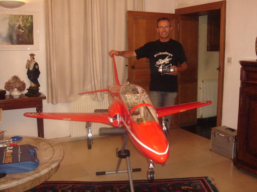

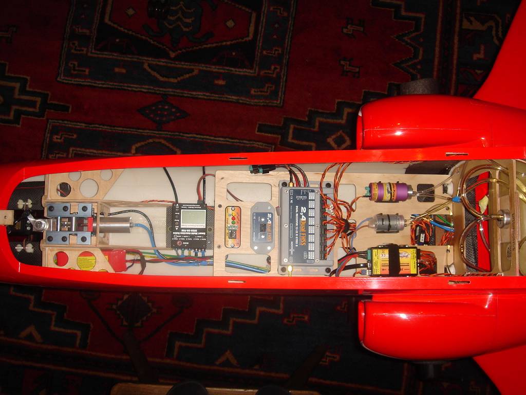

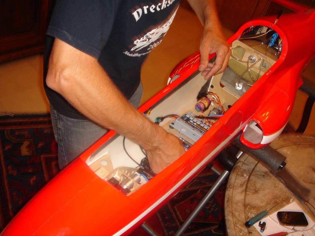

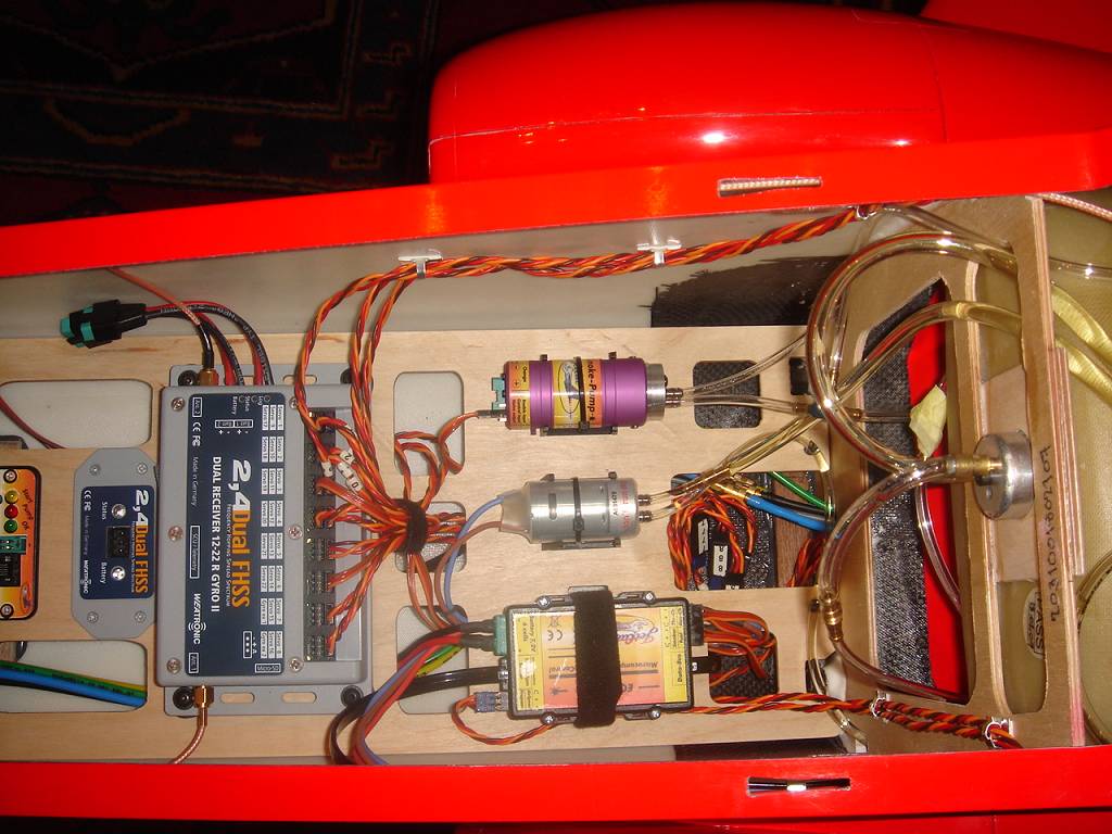

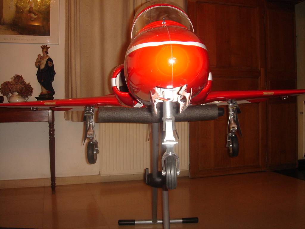

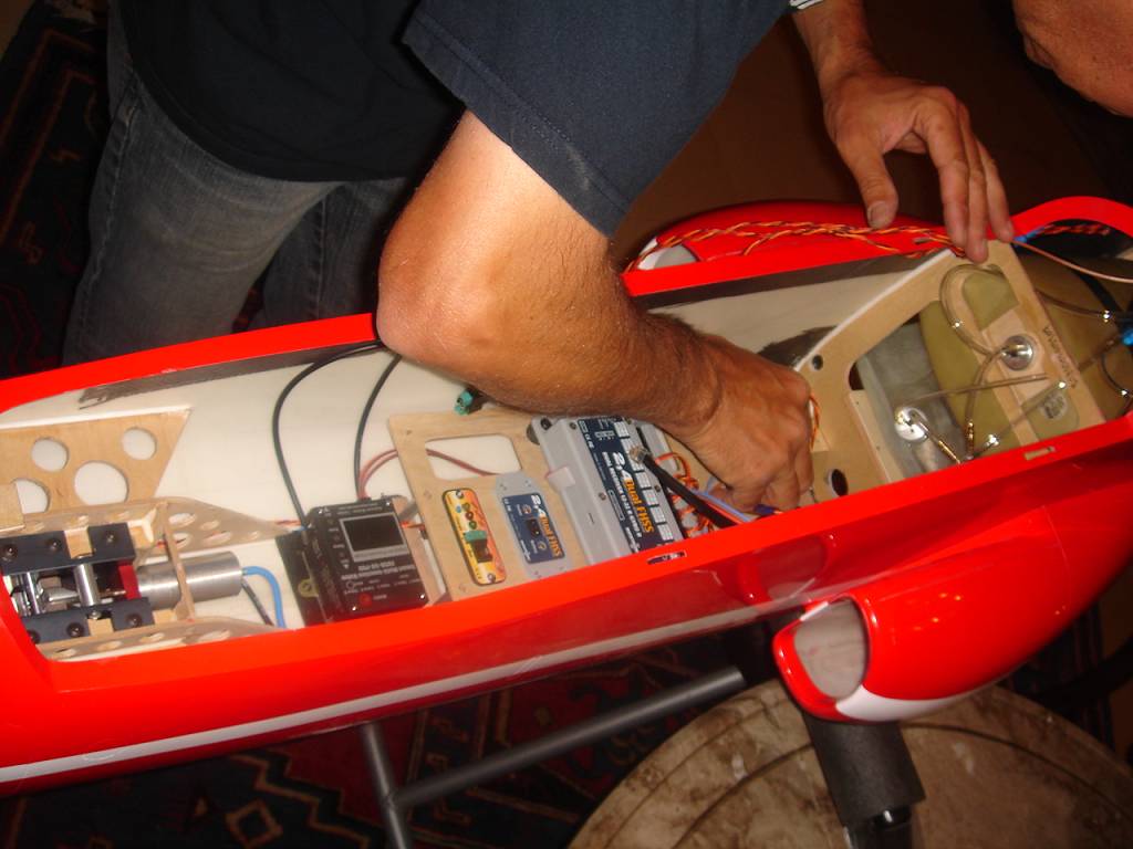

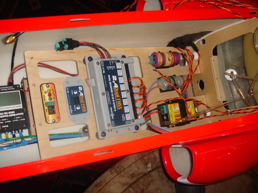

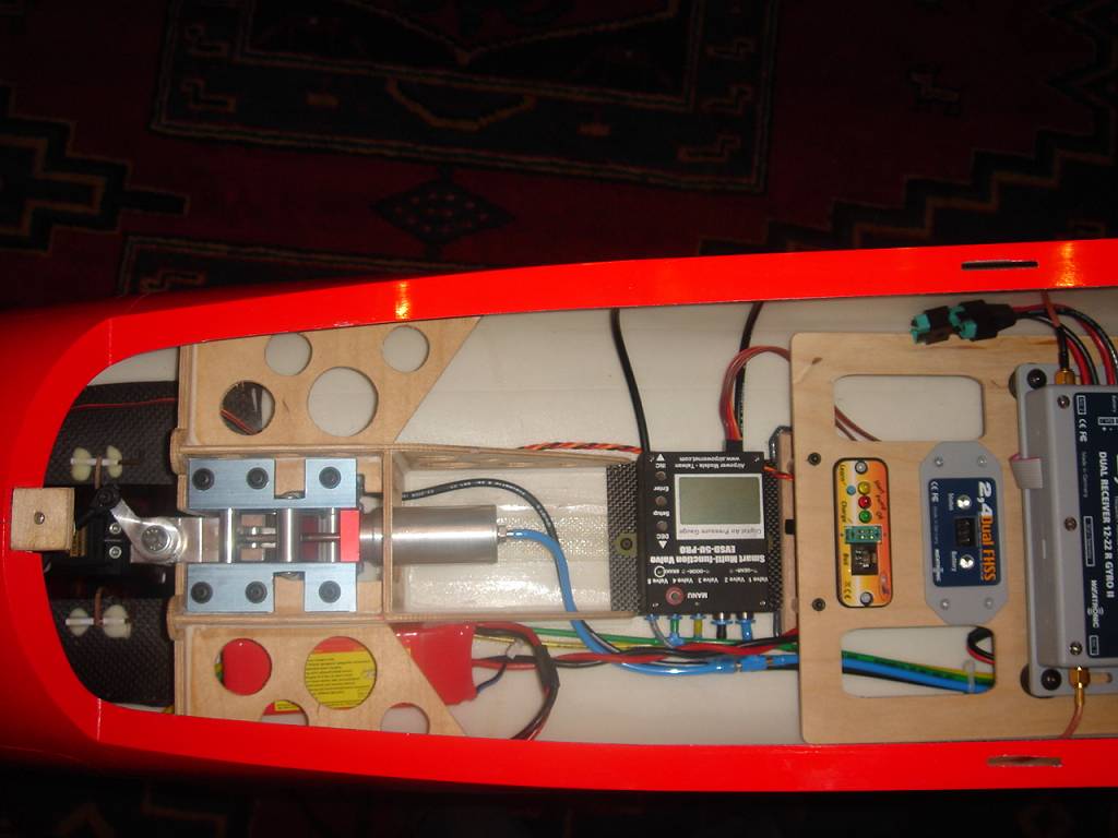

Hi Dave
Here some pics of my installation
JPZ

JP
Looks good, nice neat install...
See you at JP, JP!
