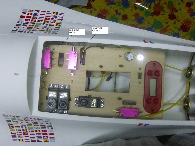

In my F16 I have set up like the one in the attached photo. There are 2 servos driving 2 airvalves, in 2 different channels that have a mix with delay in my Futaba 12FG.
Also I was planning to install one in my F18 with Weatronics rx that as 1 channel in use but an internal mix in the Weatronics receiver with a master/slave with delay between each other.
From what I have understood the Aux in the Tamjets can be plugged to the doors and the rx plug to the gear. If there is a pressure drop the signal will be invoiced to both channels. The delay in the mix might retard the gear to open after the doors???????
Also I have the latest version of Tam's with firmware upgrade. This is not clear because from wht I understood from instructions is that I can operate brakes as long as I have gear down[&:][&:][&:]
Tam, some help would be appreciated

I have installed in my Skymaster F-16 1/8 the Air Micro Switch from BVM (part No.: BVM # 5753 at USD $ 27.50).
You can find it at:
http://www.bvmjets.com/Pages/Catalog/air.htm
I have also installed the Tamjets Gear Fail Safe and it have been working very nice. I have set the activating pressure in 50 pounds. After the gear is retracted, the strut push the button in the swicth through the lever and air flow to the doors cylinders closing them.
When gear is extended, the strut release the button of the Air Micro Switch and gears and doors open simultaneoulsy.

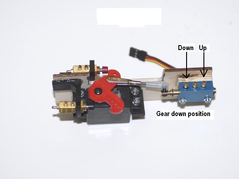

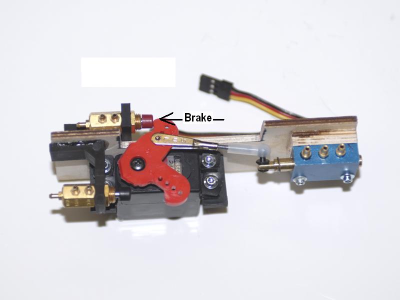

Here is the set up I do to have retract, doors sequencer and brake all in one channel and servo.
This is cheap set up and it's just work everytam.
The trick is you got to set it up right. Any pressure on the strut will get stuck or too loose it bleach out the air slowly in flight.
The other way is like Tom did on his.
Delay the travel on the servo and with little mechanical delay it works like a charm.

That cam setup idea I originally got from Tom Dodgen and Barry West.....once you get the dimensions right ( I used up 3 or 4 of the round arms which I seldom use elsewhere) and get the hole placement right, it is perfect. I had the room on the BCARF for a small extra air tank, so the doors are isolated from the gear air supply, although it is simple to hook it all up to the gear tank. That is the way I have it on the KC and BARF. I have Tam's FS Unit on the BARF as well. Once I figured out how to get the setup to work right on 2.4 with no jiggling of the gear servo or folding of the gear when I turn RX on, it was [sm=thumbup.gif][sm=thumbup.gif].
