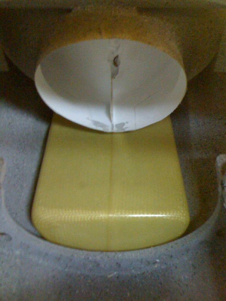

Question for anyone who is actually flying the 2m right now,and to satisfy my curiosity. What kind of flight time are you getting? Kit comes with 2 kevlar tanks. Are you using both, or one etc...
Old 08-02-2010 | 09:06 PM
  #256
My Feedback: (30)
Joined: Feb 2009
Posts: 687
Received 6 Likes on 5 Posts
From: Hampstead,NH
Default RE: Viper Jet 2M Pointers/ tips.
Reason I ask is one of the tanks seems real close to the turbine. makes me nervous

We're getting an 8 min flight with the Kingtech, 9 oz/ min. I also have the kevlar tanks.

This just looks to close for me....

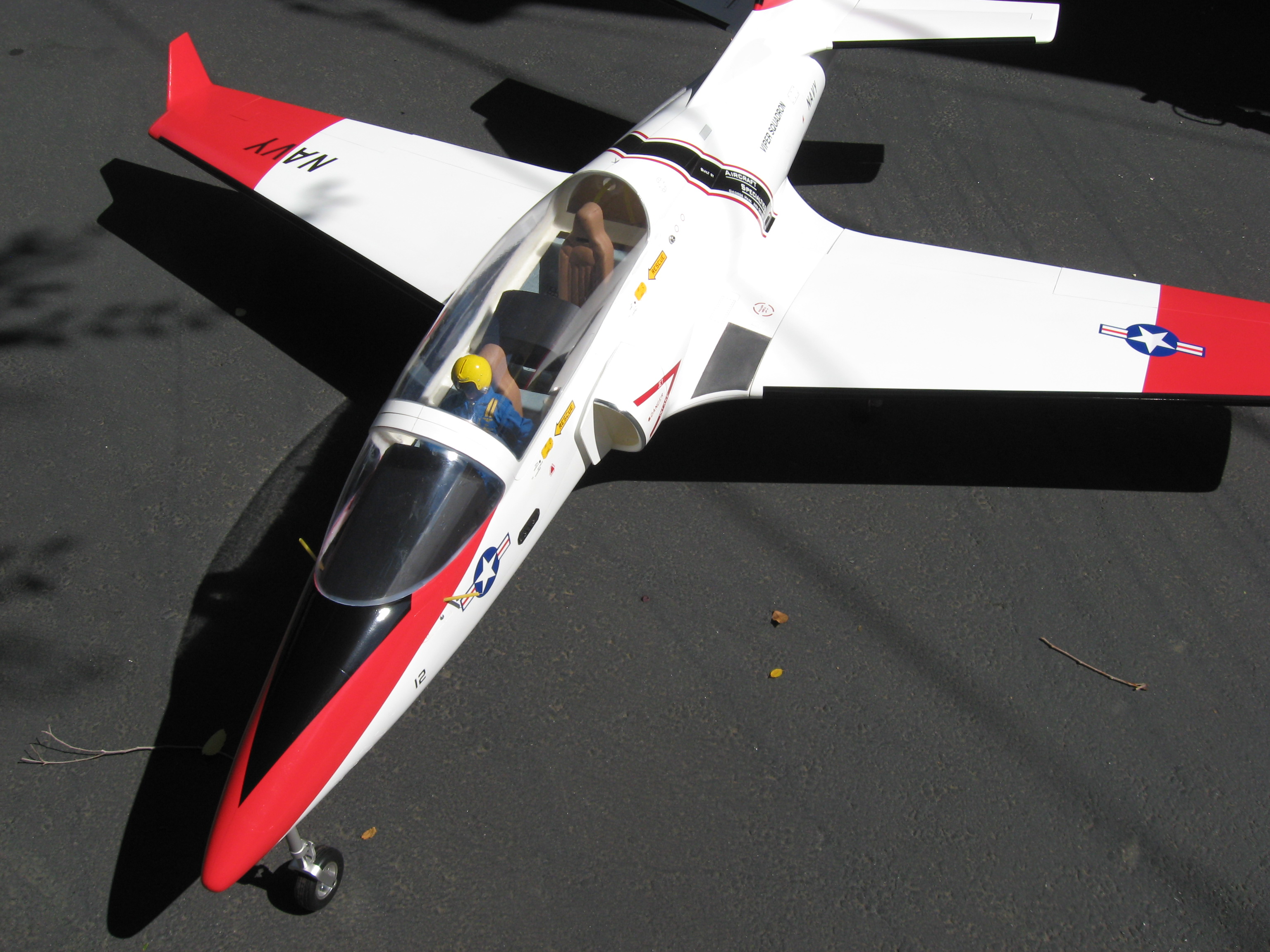

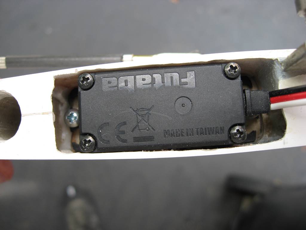

For what it's worth, I used Futaba S 9551 servos in my 2M Viper elevators, a perfect fit!!!!
see pics
I have also decorated the plane in the new Patuxent NAS Viper Squadron scheme (similar to the T-45)
pictures will be forthcoming

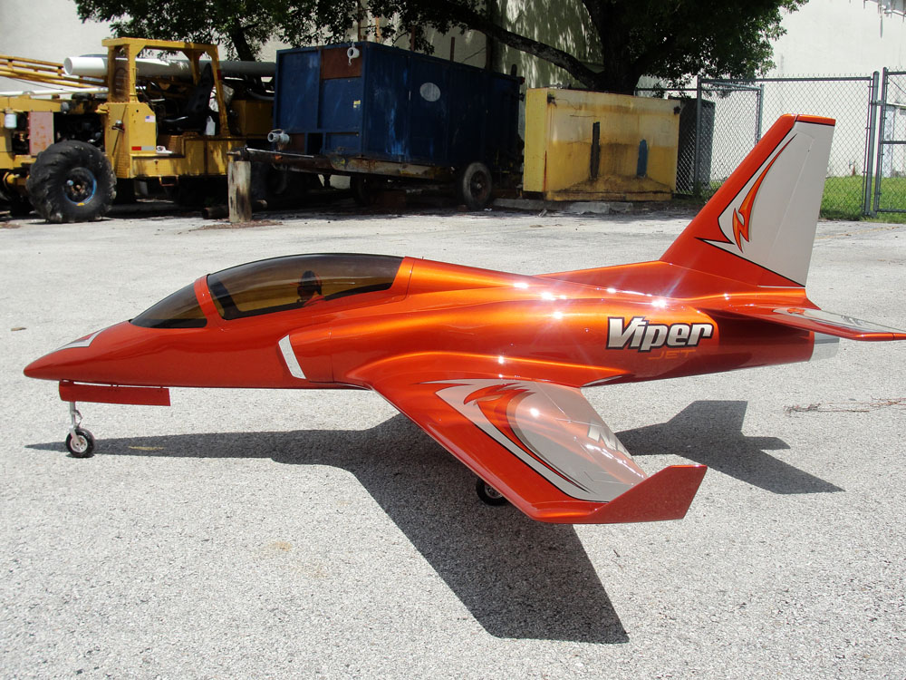

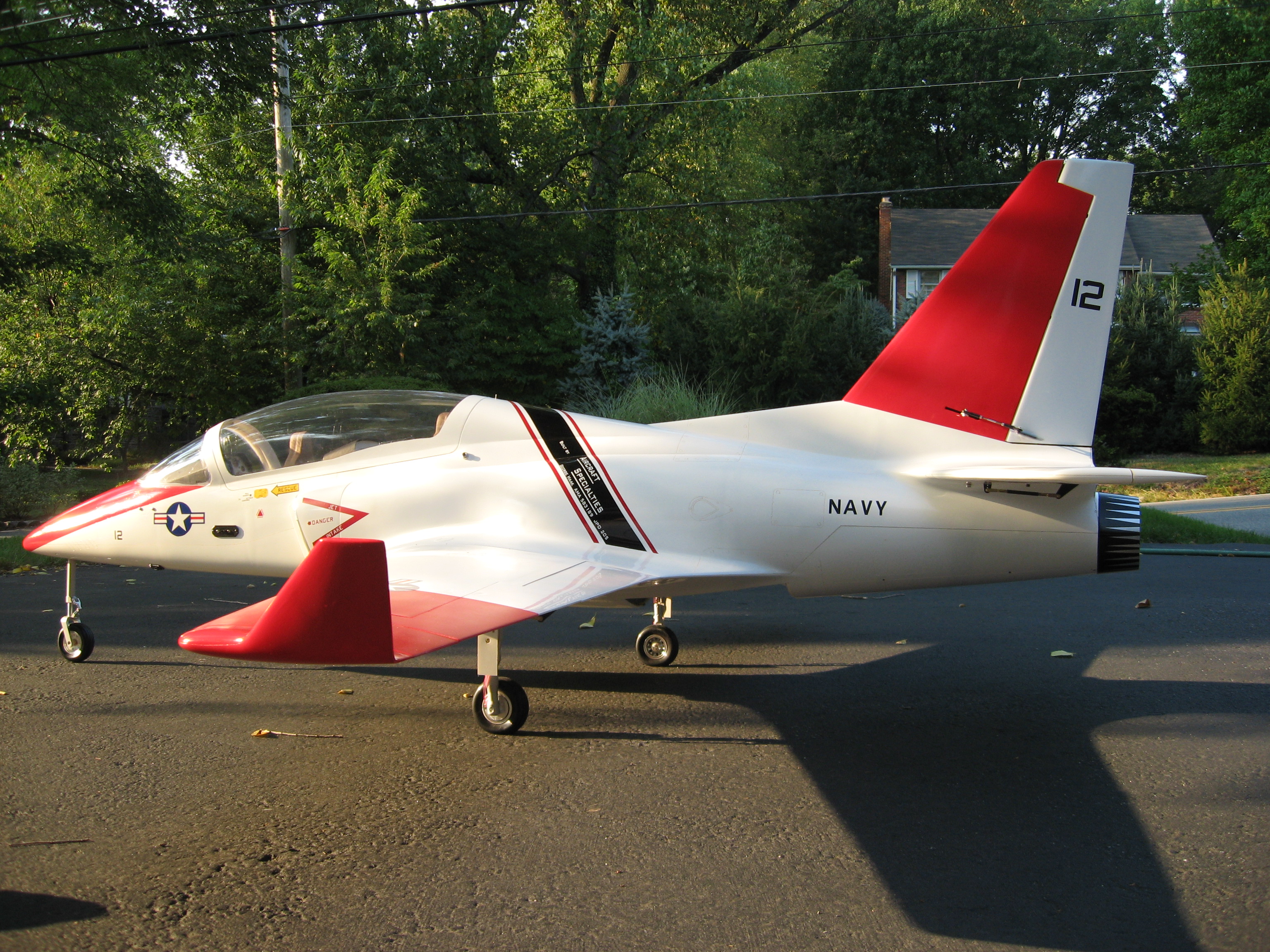

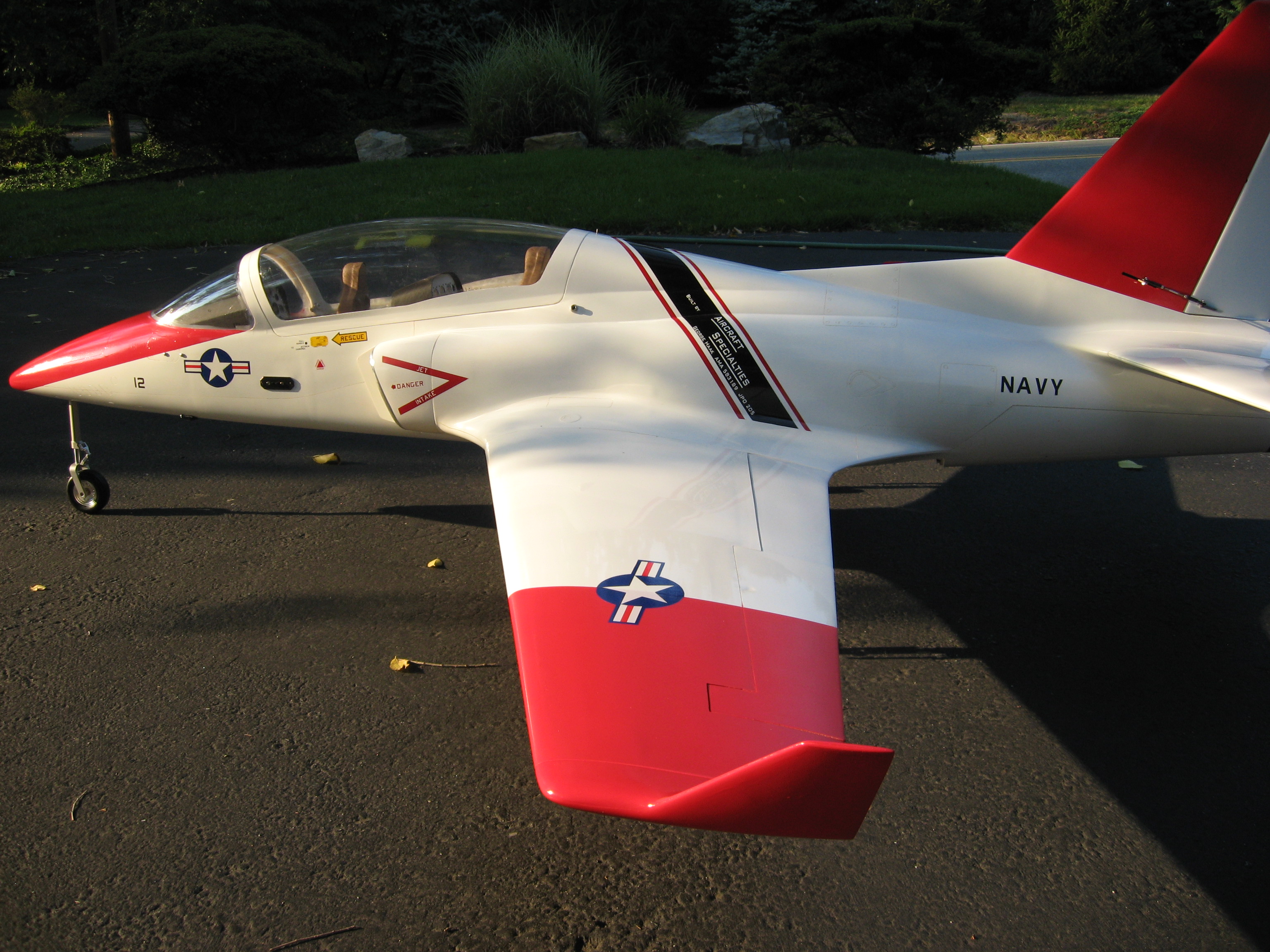

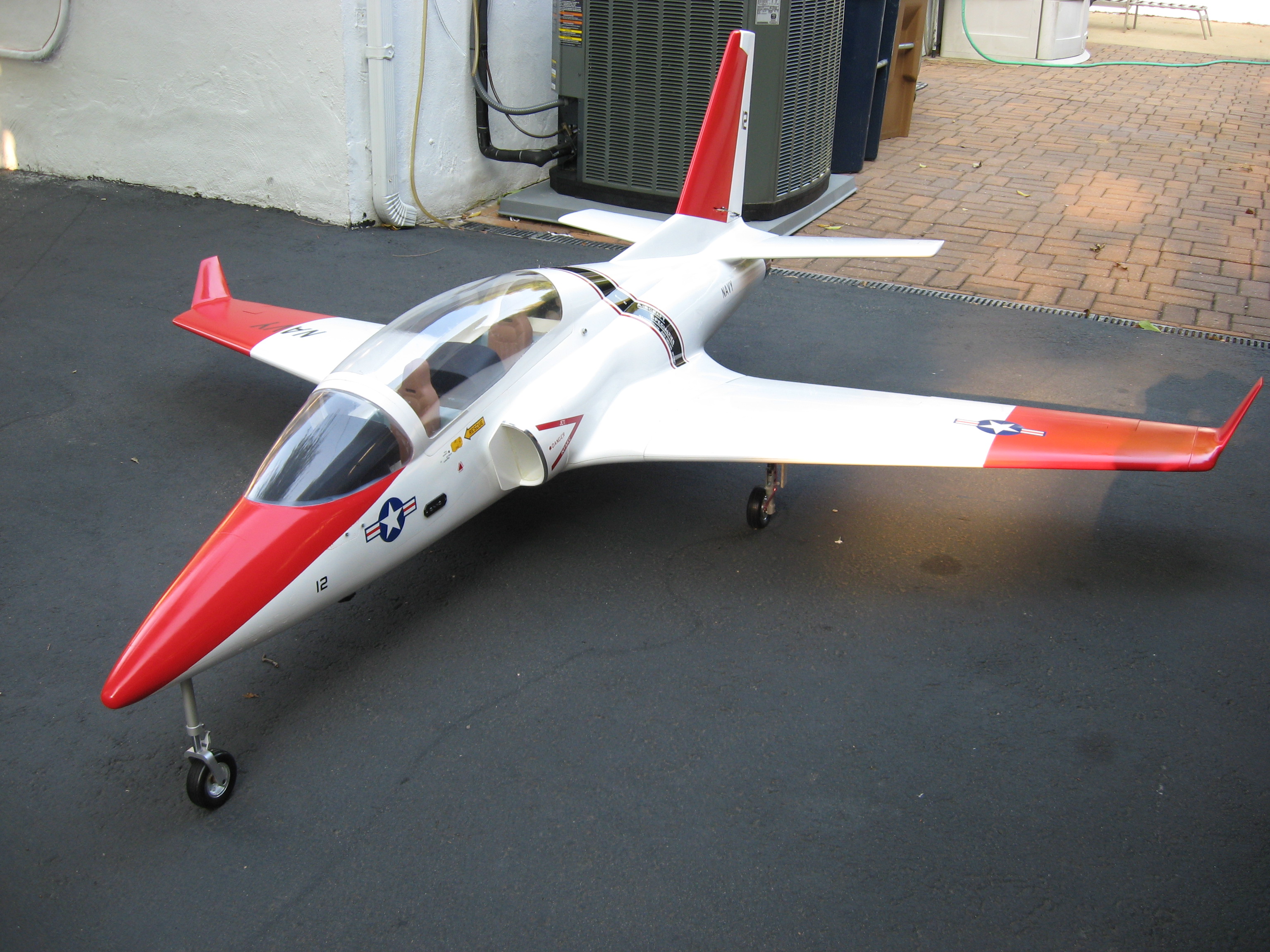

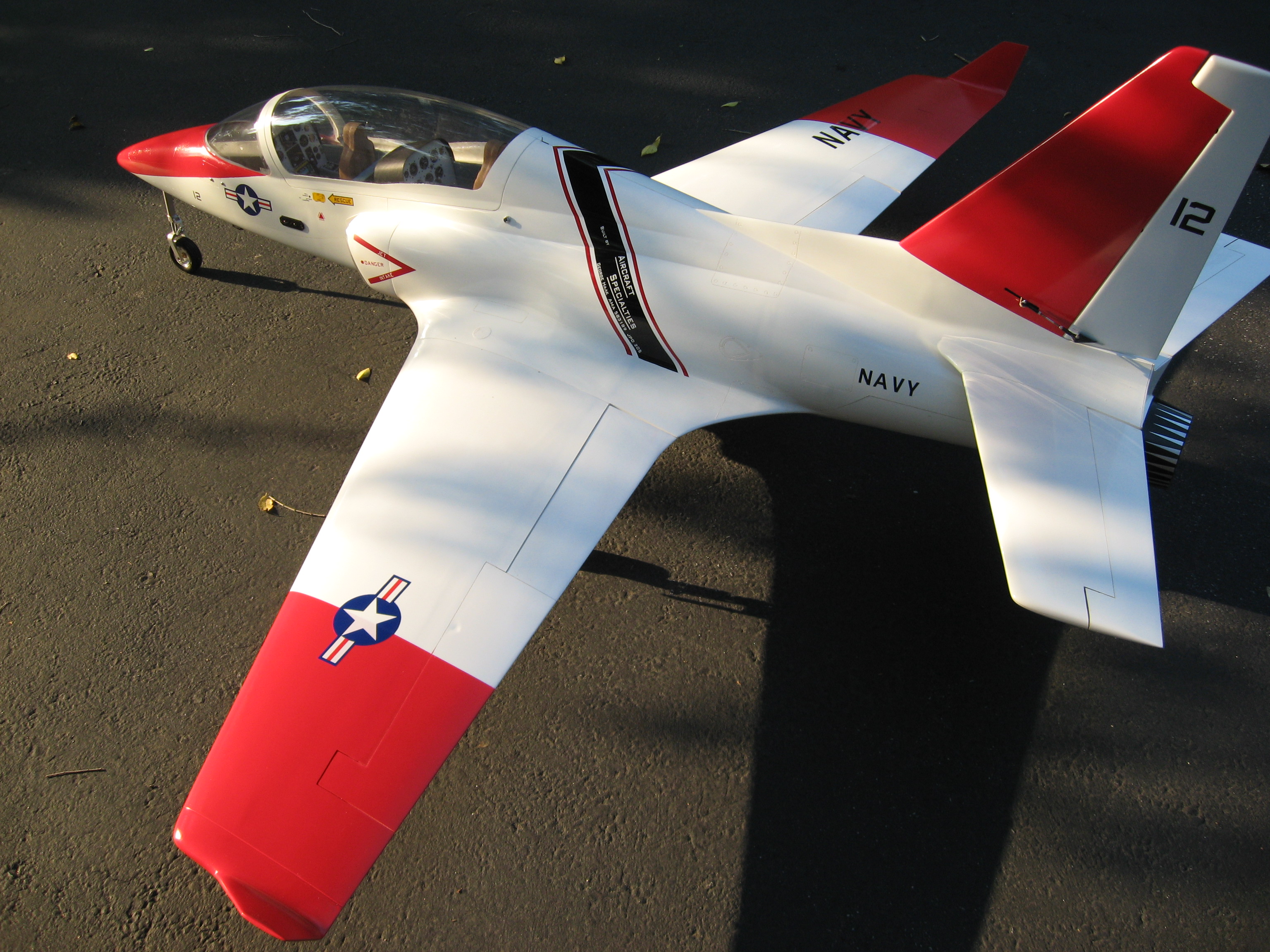

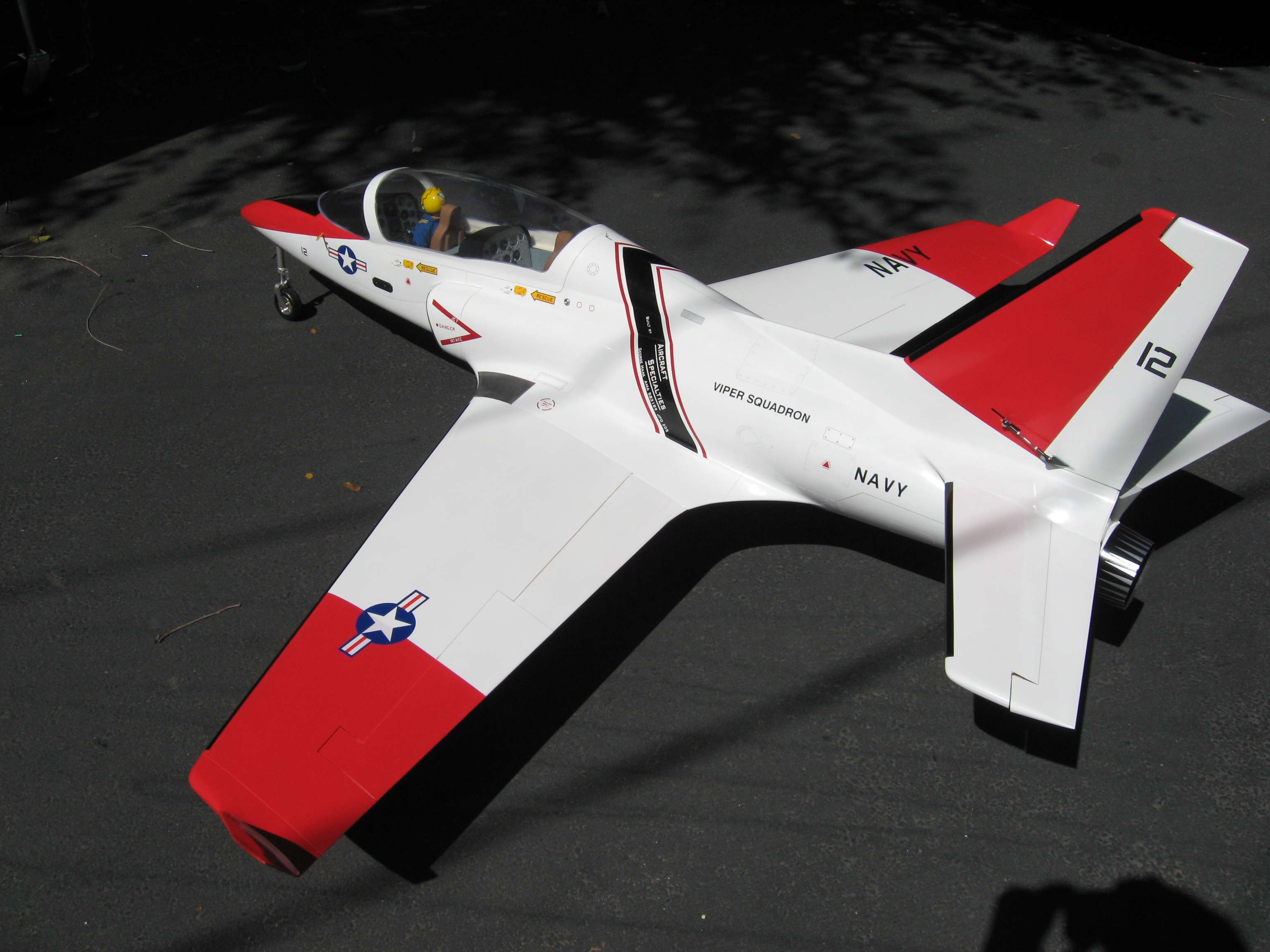

OKhere is the partially decorated NAVYVIPER (Patuxent NASversion )
I LOVETHENAVYSCHEME!!!!!

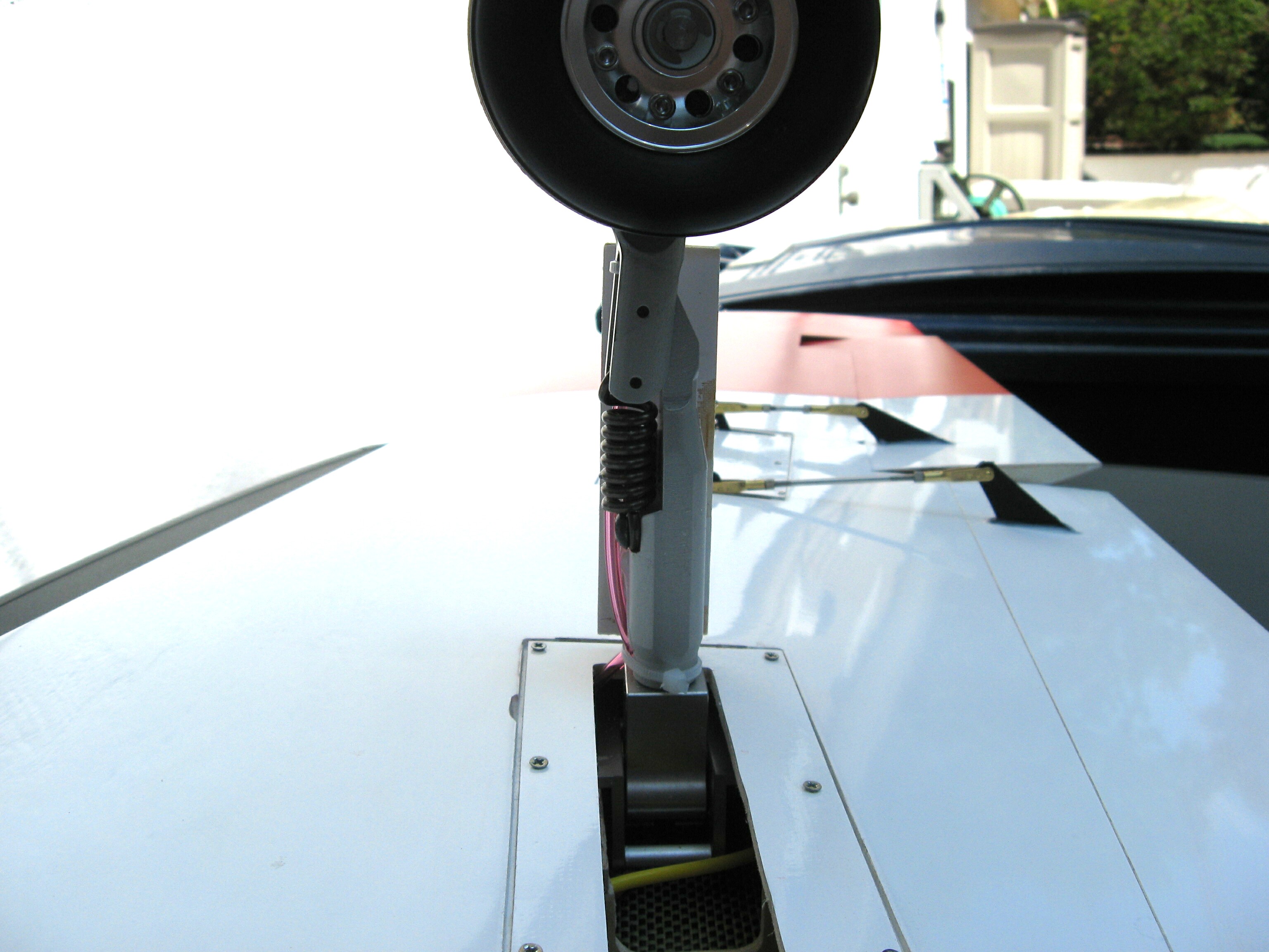

Something to share:
Ihad difficulty in getting reliable operation of the main LGunits that came with my plane
Ifinally had to disassemble them and do this:
1. Polish the main shaft that supports the trunnion as it was very tight (held in by 2, 4 mm screws)
2. Disassemble the air cylinders and polish the shaft as it was quite sticky
where it protrudes through the oring embedded in the cylinder end
3. Put BVMair cyl lube in the cylinders
4. What made the biggest difference however is that Ihad to remove some metal
on both sides of the sideplates that enabled the mecanism to freely operate in the "extend"position (gear down)
otherwise the gear(s)would not go down reliably except under high pressure.
After all of the above mods, they now operate down to 30 or so PSI!
See pics.. lookfor the small arrow... Ifiled here...

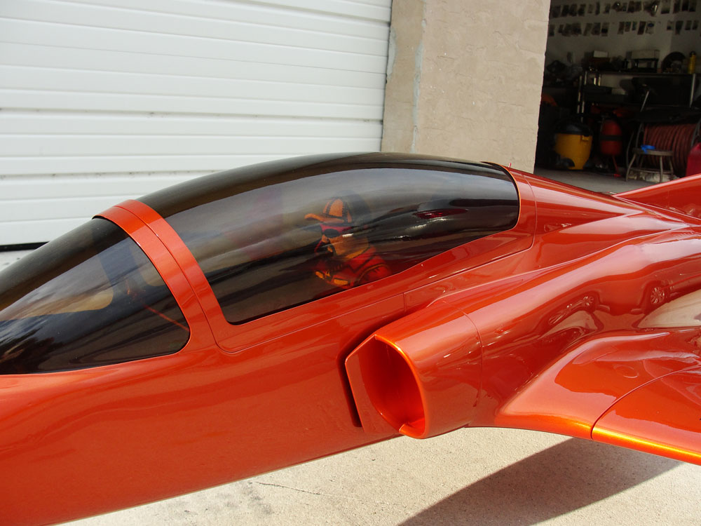

Hey Guys,
I ordered my Viper in all white. Also with the canopy and frame un-cut and uninstalled so that I could tint the plexi.
I went with a civilian type (hot rod) paint scheme and left out the cockpit and just went with a light pilot to off-set the weight of the paint.
Should have it ready to test fly next weekend. Jim
