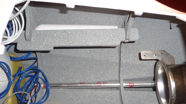

OK Guys I am working on the install of my Viper and I am wondering with all of these Vipers out there is there anyone who has an extra cockpit or a set of cockpit tubs they want to part with?
I have a FB T-45 and I found that the Cockpit Tubs from that will fit it also... so I should presume that the older Skymaster T-45 BAE Hawk tubs will fit...
Please PM me if you have something that will fit the bill....Thanks
p.s. I picked mt Viper up minus the Cockpit, Landing Gear and Pipe, I found that the Jet Legend T-45 pipe fits perfect, The JL T-45 pneumatic retract units fit, the JL T-45 Main wheels and brakes fit my prolink main legs from Digitec.
I had to turn some aluminum extensions on the lathe for the pro-link legs to get the right height, and I am using the pro-link small front strut which I fabricated a full size direct drive servo to the front strut to rid myself of the nasty pull pull set up.
When I get a chance I will post some photos if anyone is interested.

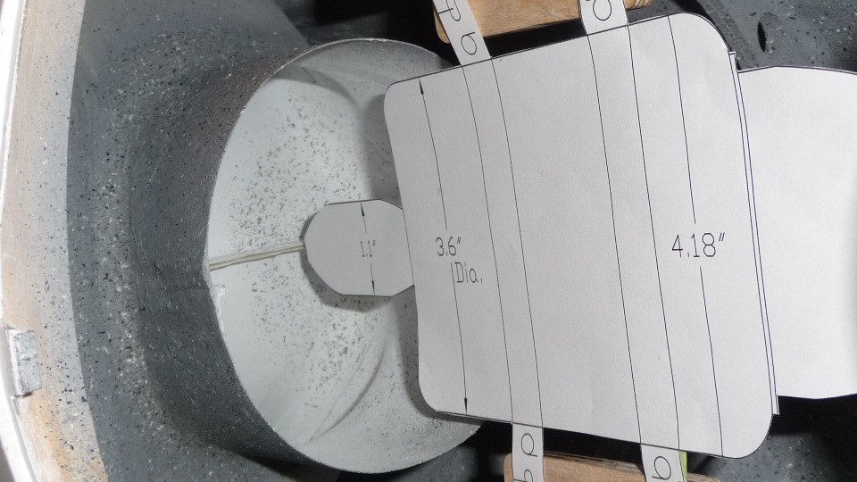

Thought I would post some of my install photos, I added two extra hinge points to the rudder, and some blocks to stiffen the ends of the hing points and add area to the back of the vertical fin

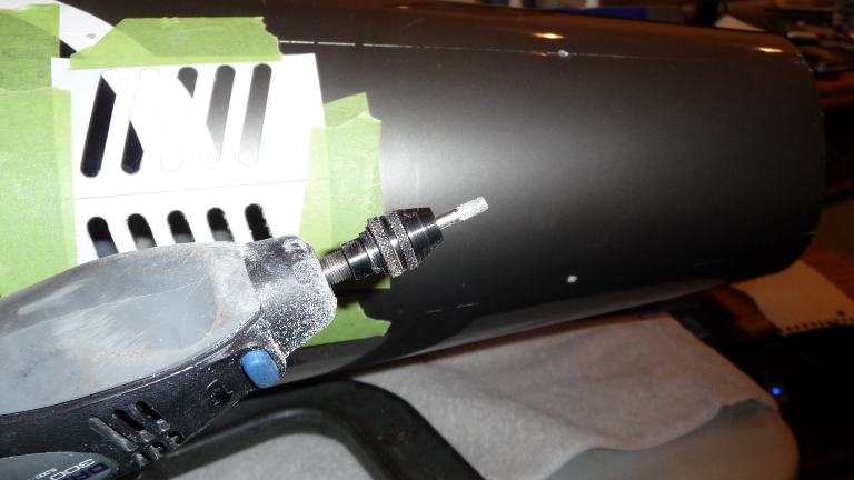

To make the cooling vents I made a paper template and cut out the vents with a dremel rotary diamond wheel cutter, I included a full size pdf template. The trick is cut out the paper from the template first with an x-acto knife, then use the paper as the guide when using the dremel.
