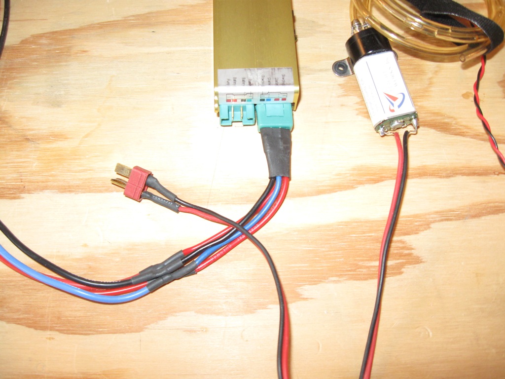

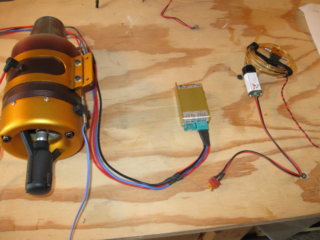

Gents,
Obviously I'm missing something.
1. The pump has a Deans plug. What does it plug into?
2. What does the ECU battery plug into?
It appears I need a Y-harness that I don't have. Does anyone know the wiring diagram with the pin-outs?

Chris, did you get one of these???
On mine harness as shown, the deans plugs into the pump. The two wires unconnected there wire up to your ECU Bat. Now mines a propane start so if yours is kero, the wiring may be a little Diff.

I didn't. Bought the engine NIB, but not from Barry. I can easily make it. As long as the pin-out marked on the ECU is correct.
Mine is Gas too.
Thanks for quick response. I'm heading to Radio Shack.

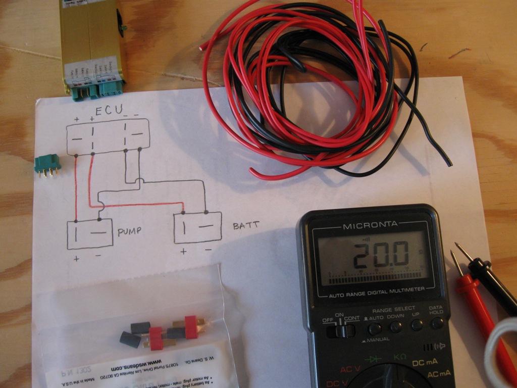

Thanks Fellas,
Check my work. This looks like how it is wired.

YepThats the way the pinouts on mine are. The two pump leads to the outside with plus on the left and the Bat leads in the two mid Pos with plus on the inside left. Thats with the Multiplex plug key up like you have it. Those two middle leads for the Bat, I wouldn't hurt for you to ohm them or I can do it on mine to find out if they are tapping the upper or lower pin on the multiplex. In fact on the harness (Which you don't have) I may have to do that for you if you can't trace those back to the ECU.

Chris, I checked my harness and On mine, the two mid wires for the ECU Bat are picking up both the upper and lower center Mutiplex pins.

You da man! Thanks. I'm treating the middle pairs like one pin each. In other words 4 wires to the plug as 1-2-2-1.

You got it. Like the red left bat wire on your drawing goes to the upper and lower pin. LIkewise, the right black wire from the Bat goes to the upper and lower as well. At least now thats the way it is on my harness. Rather than Ohming it out, I just pealed the shrink back and looked first hand. Make darn sure you put shrink wrap on each one to keep them Sep.
