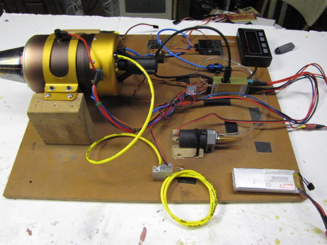

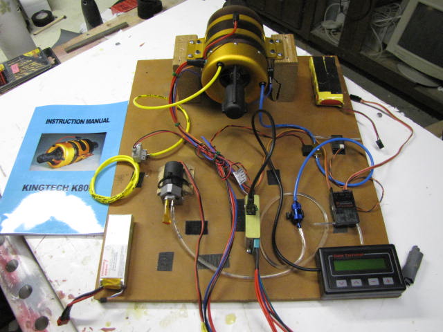

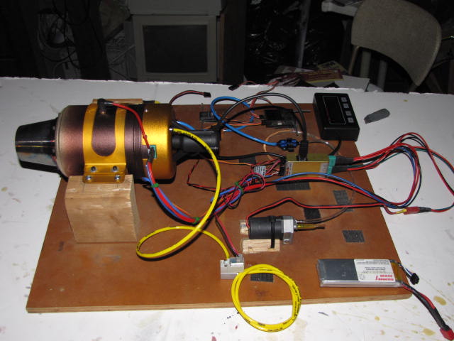

Hello Gents, proud owner of a K80E now,
Can someone please post a pic of a benched propane set up? I have manual and want to make sure I have everything ok.
Also running Futaba 2.4 if theres anything I need to worry about on set up?

Dblex
Here are a few pics of mine when I tested it. As far as the Futaba, I believe you have to reverse the Throttle in your Tx. That should be the only thing you need to do then learn the throttle according to the manual.

Great! I just finished mine like yours. And I did have to reverse the throttle because the settings wouldnt take. I did do one or two test start sequences and she spools up, and the gas valve clicks rapidly and shuts down on "BAD START"
Im assuming this is happening because it not only doesnt see the gas, but the manual says it shuts down on bad start after min RPM hasnt been reached in 2 seconds.
PLEASE tell me the gas electronic valve rapidly clicking is a check valve or something trying to stay open but isnt because of no gas. And that the RPM is because of no Gas as well????

Gas valve clicking fast during start up is normal. I'm actually suspecting you had too much gas pumped into the chamber, the hotter the ambient temperature the less gas is required for an ignition.
One of the most common fault on propane starting is too much propane.
Otherwise, check your glow, perhaps dial up the voltage a bit to ensure an ignition. There's no reason it won't light up for you.

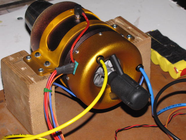

Old 08-20-2011 | 05:05 PM
  #608
Joined: Jan 2004
Posts: 491
From: Mt. Vernon, IL
Default RE: KingTech K-80
Barry
I think he means doing a dry start with no gas at all. Still perfectly normal for the gas valve to cycle. No gas = no ignition = no temp increase = bad start.
Old 08-20-2011 | 06:08 PM
  #609
Dblex's Avatar
My Feedback: (81)
Joined: Jul 2005
Posts: 692
From: Corpus Christi , TX

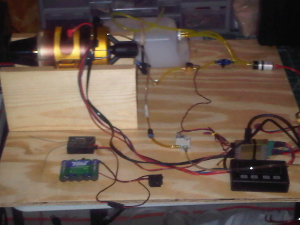

Well, after I dont know how many BAD STARTS, I finally got her to run! Had to crank up the glow to 2.2 and she lit up like a flare! Wow, let me tell you that at 8pm in a quiet neighborhood, THIS THING WAS FREAKIN LOUD! AWESOME AND LOUD! I swear this thing sound like it was in full afterburner and I think EVERYONE came out of their houses. I felt like I had to shut it down because of the people coming out.
I just dont remember my buddy's Jet Cat being this loud!
Man, I thought I shook bad doing 3D with a heli, this thing had me in the fetal position and excited all at once.
OF course I did it on my drive way, not my bench like the pic! LOL

Old 08-20-2011 | 08:17 PM
  #610
Dblex's Avatar
My Feedback: (81)
Joined: Jul 2005
Posts: 692
By the way, is there a way to adjust the LCD ont he data terminal? mine is kinda hard to see, like if the setting is too dark

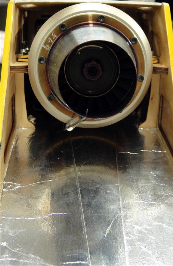

Finally got back on my Elan project and I need some advice on mounting the K-80. What is the recommended distance from the rear of the engine to the back edge of the fuselage? (see picture) Thanks for any help.

Old 08-27-2011 | 10:14 AM
John, that actually looks pretty good where you have it. Since there's no pipe, the distance is less crucial, just so you don't burn anything.

Old 08-27-2011 | 04:52 PM
  #615
Dblex's Avatar
My Feedback: (81)
Joined: Jul 2005
Posts: 692
Barry, I will give you a buzz. I tried 1.9 and she just wont fire. Slowly tried cranking her up 2.0, ect and she wouldnt light til 2.2
I will give you a call Monday. Im down to my last plug and I want to get her starting first try.

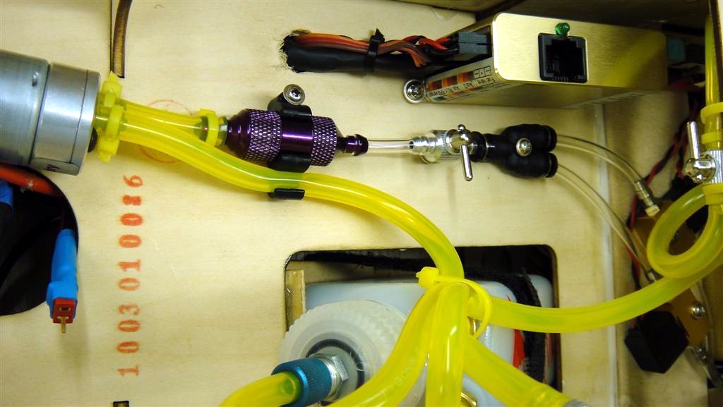

Old 09-21-2011 | 09:10 PM
  #616
BILLYDSRC's Avatar
Joined: Nov 2009
Posts: 564
From: AUSTINTOWN, OH

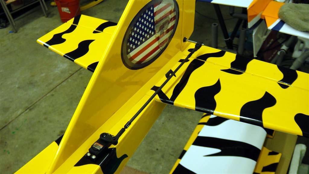

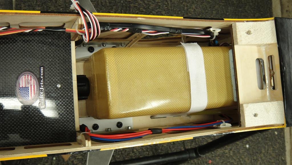

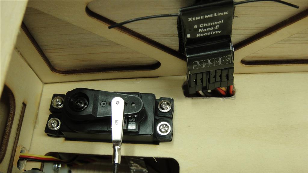

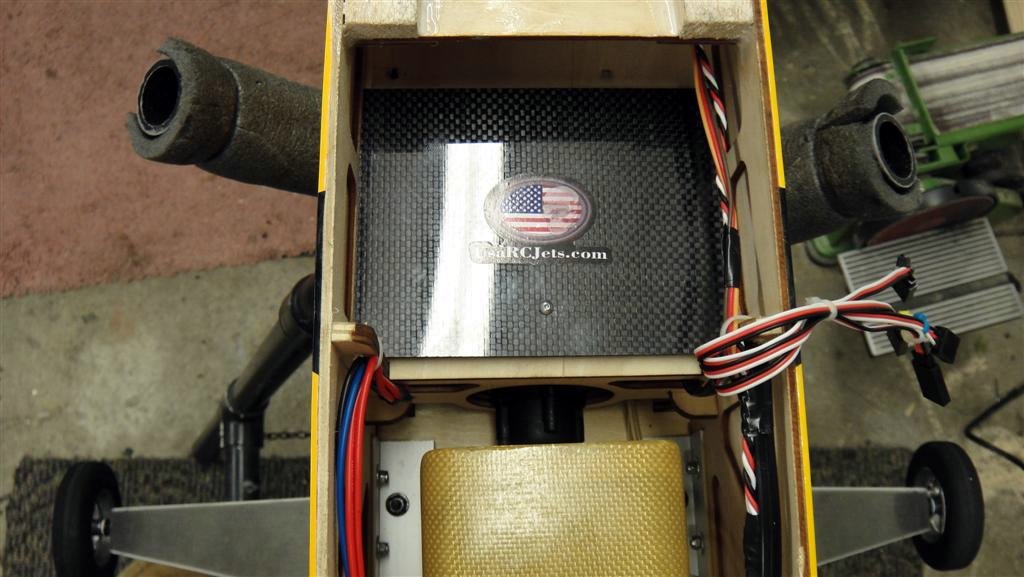

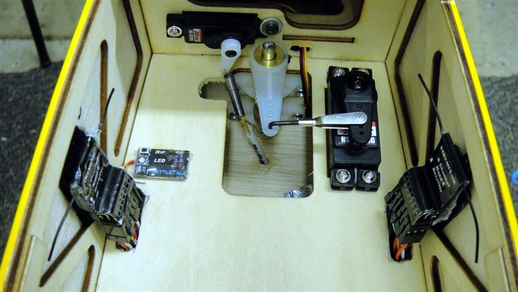

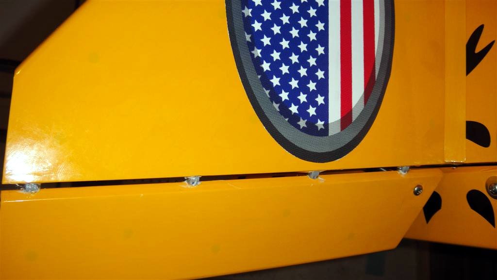

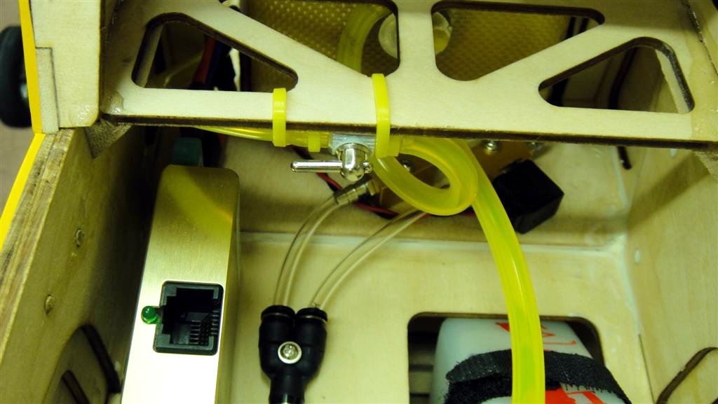

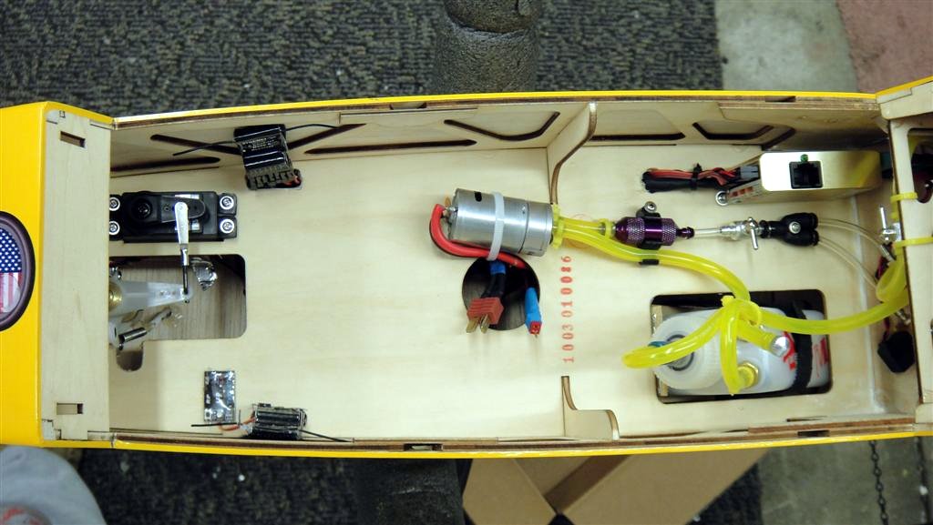

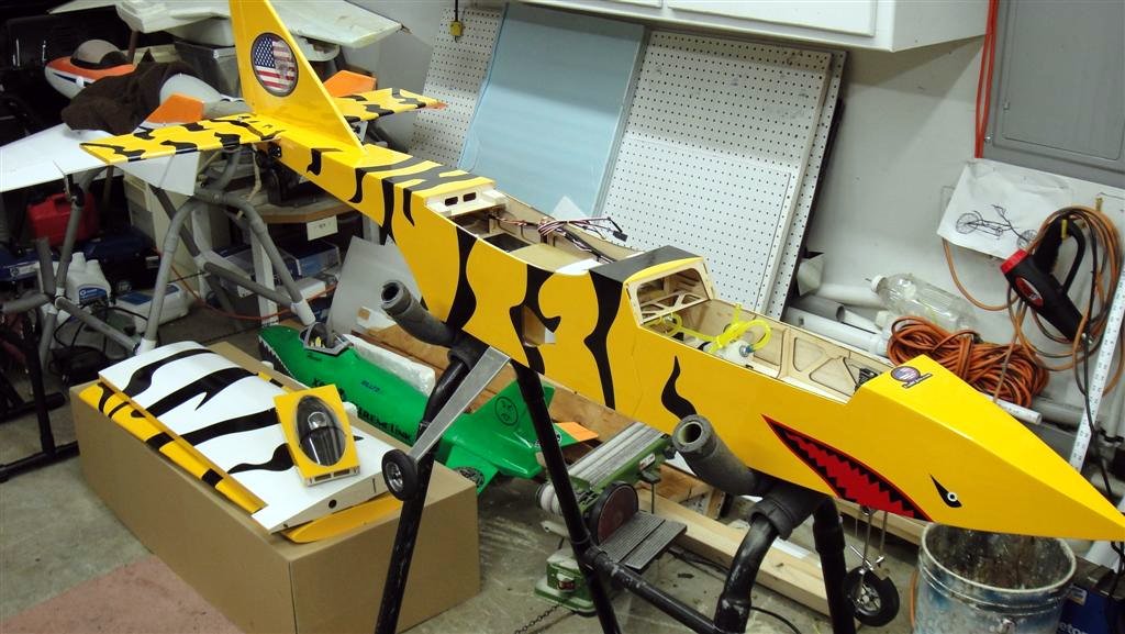

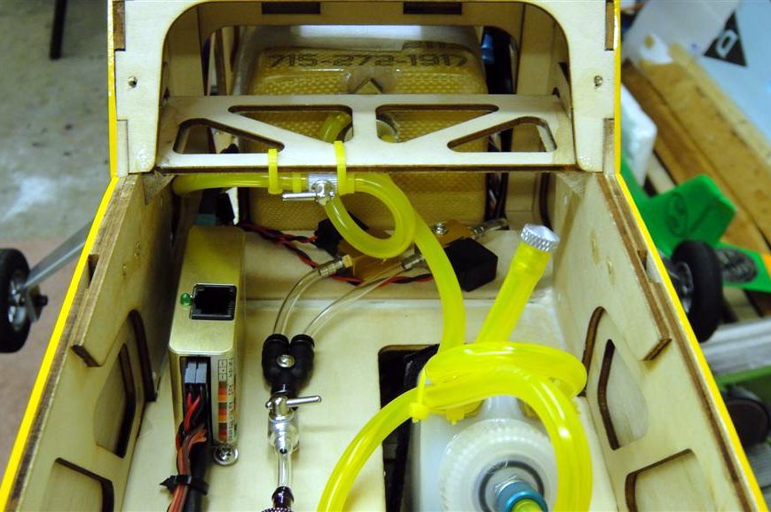

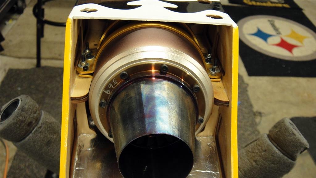

HI All, This is my First Turbine build. It is a Shockjet with a K-80. Joe L. is going to help me out with the programing on the K-80. Here are some pics of the build. Is there any pics of the flaps using Robarts hinges on the shockjet?
Thanks Billy D

  #618
causeitflies's Avatar
Posts: 2,452
Received 43 Likes on 33 Posts
From: EASTERN OHIO

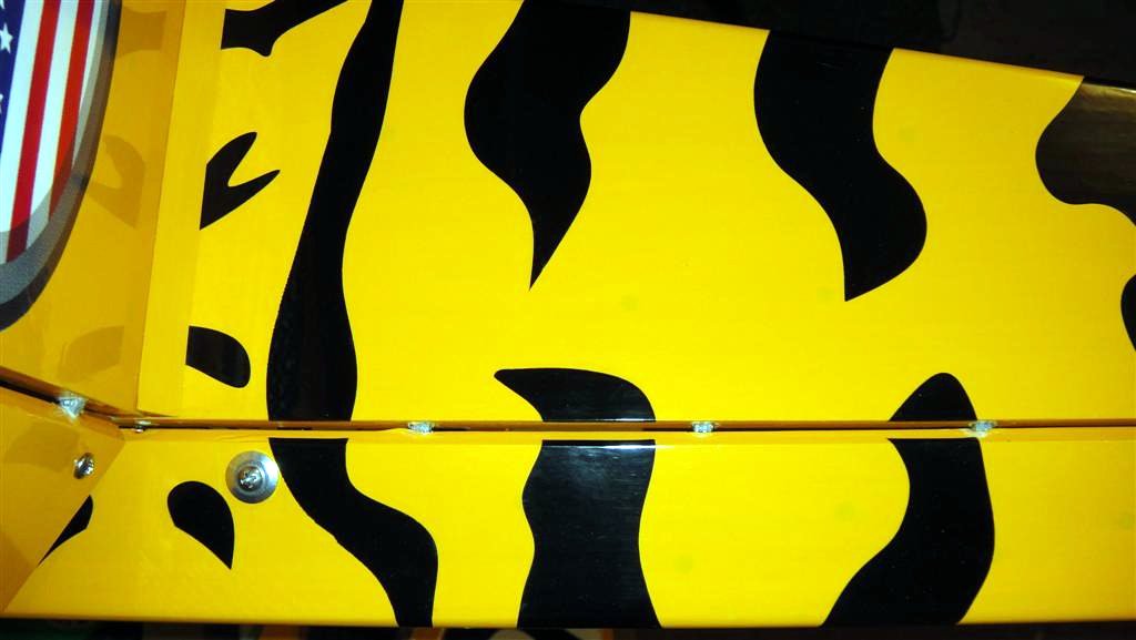

Hey Billy,
Get rid of the wire ties on the fuel system nipples and use safety wire double wrapped and twisted.
If you haven't glued the hinges yet, the surfaces need to be notched to eliminate the gaps.
Welcome to the turbine family [8D]
Old 09-22-2011 | 07:43 PM
  #619
Joined: Jan 2004
Posts: 491
Dblex
2 quick and easy things to try and solve your start problem. Make sure the glow plug coil is pulled out like page 18 of the manual. Also make sure no part of the plug element is touching the inside of the plug body. Change the gas percentage up or down 5 percent and try a start. Too much or not enough gas can also make your turbine very hard to start. Since you are cranking up the plug voltage so high I would tend to suspect you have too much gas. I have 2 K-80 turbines with just about 8 hours between them both are still on the plugs they came with. Never have had a failed start that wasn't something my fault.
Old 10-07-2011 | 08:50 AM

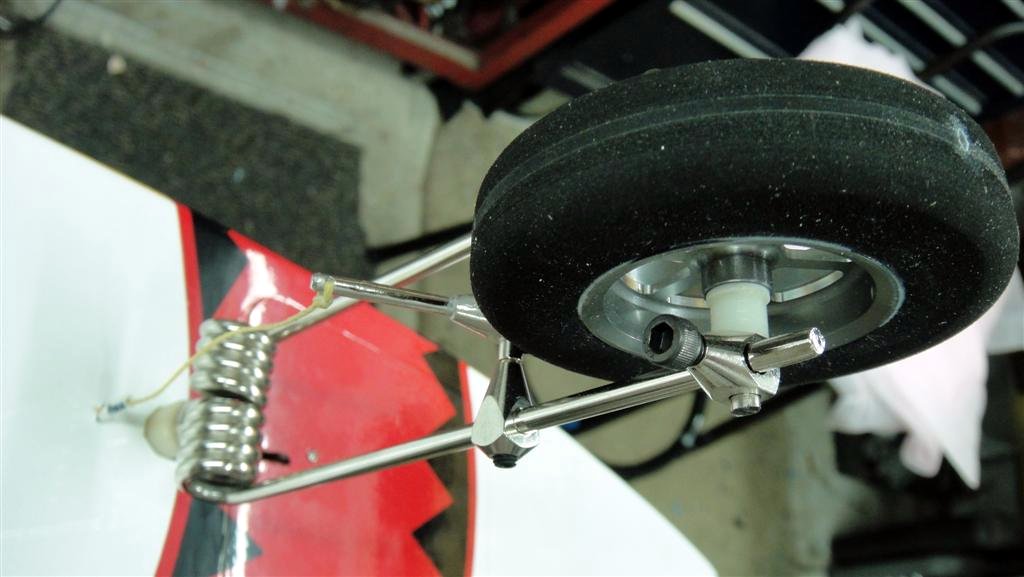

One question, where did you get the brake for your nose gear? I've been looking for one of these, save me $200 bucks, just need something simple that works.
Luke

ORIGINAL: BILLYDSRC
Thanks Billy D
I helped Billy D last week with his setup and learning on the K-80 and shock Jet. He Was signed off for his turbine waiver and he is now officially a Turbine Junkie. Welcome to the Family Billy. His friend and partner Doug was also signed off as well, welcome aboard Doug.
The Kero Start K-80 runs great. I have a propane start and it runs great as well
Joe Lewis
Kingtech K-80 and K-140
Owner.
