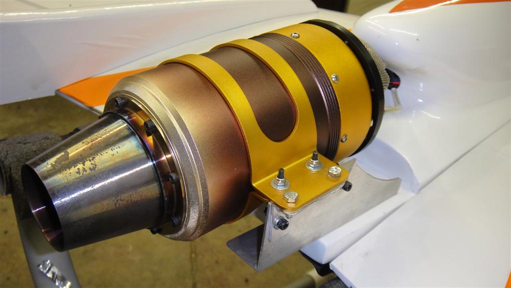

Well All, I just got my hands on the newest K-80f today!! I love the size of the new Xicoy ESU.... Going to try to get it installed for a remaiden tomorrow!! Joe L will be there to help set it up.... I'll post some video and pics of the flight. Thanks Berry!!! Billy D

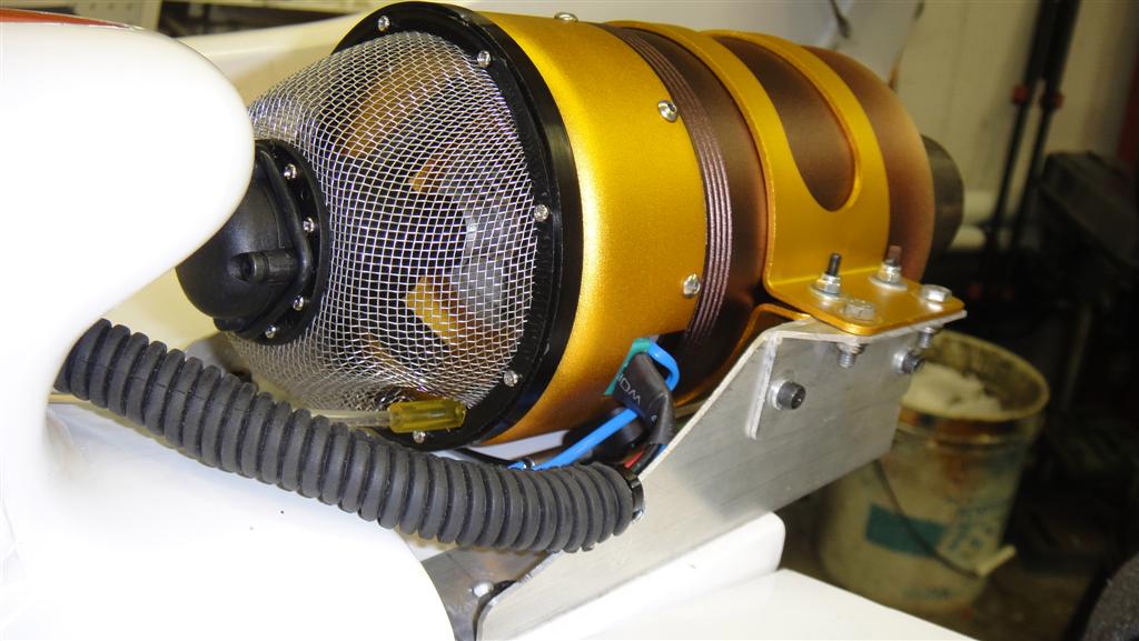

Going to remaiden it tomorrow am. I'll make a video of it. Here is a video of it with the EDF on her. Thanks Billy D

Default RE: KingTech K-80
ORIGINAL: BILLYDSRC

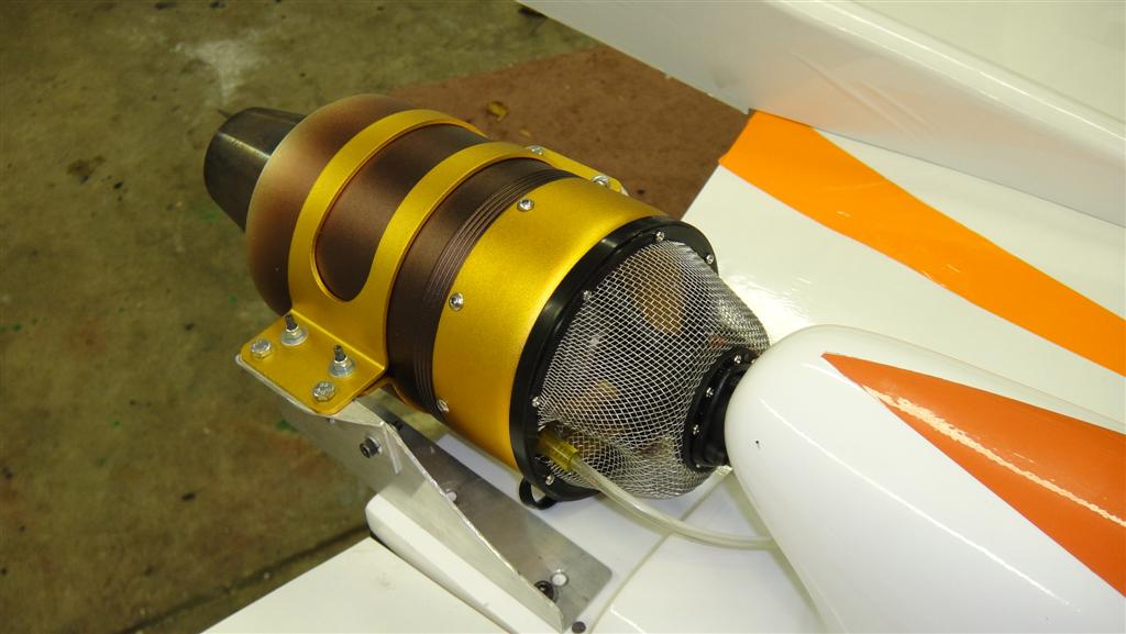

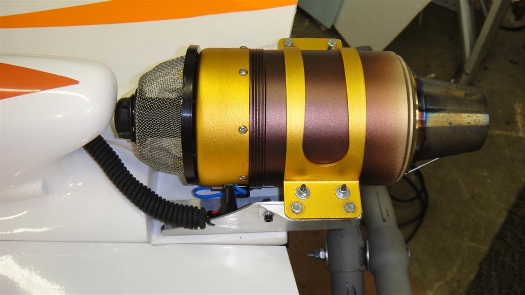

Here are some pics of my 1 day install! Sorry it's so messy. Will make it look good over the winter time. This falcon was a EDF. Going to remaiden it tomorrow am. I'll make a video of it. Here is a video of it with the EDF on her. Thanks Billy D
Isn't it a bit tail heavy? That K-80 is sitting way back.
Have fun on your re-maiden.
Not realy at all. When it was a EDF there was 4lb haging off the back of it. I just used a 5000mha lipo for my ESU batt and put it all the way in the noise. She was dead on 13 1\8 .... Out to the field i go....

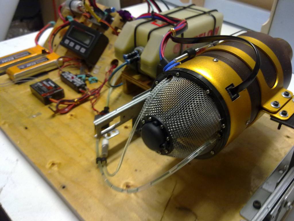

Hi friends:
I forgot the photos.

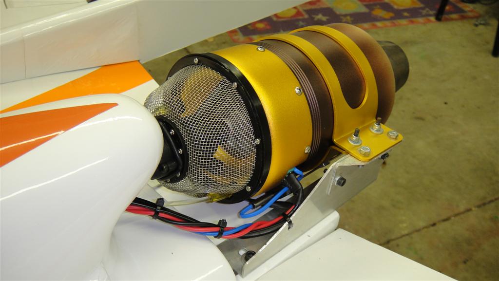

It went great! Tons and Tons of power..Making the video now and will post it later. Here are some more pics.
BILLDSRC, I noticed in your photos that you placed your fuel filter between your header tank and the fuel pump. Everything I have read said that the fuel filter should go after the fuel pump before the fuel solenoid, the thought being that the fuel pump can produce tiny debris that can clog the fuel solenoids.
Any thoughts here on the forum as to the proper placement of the fuel filter?

Tom, Your 100% right.. It was a fast install and i will fix that and i have vales coming in for it too. Thanks for the help Billy D
ORIGINAL: Tip22v
Regards,
Tom
