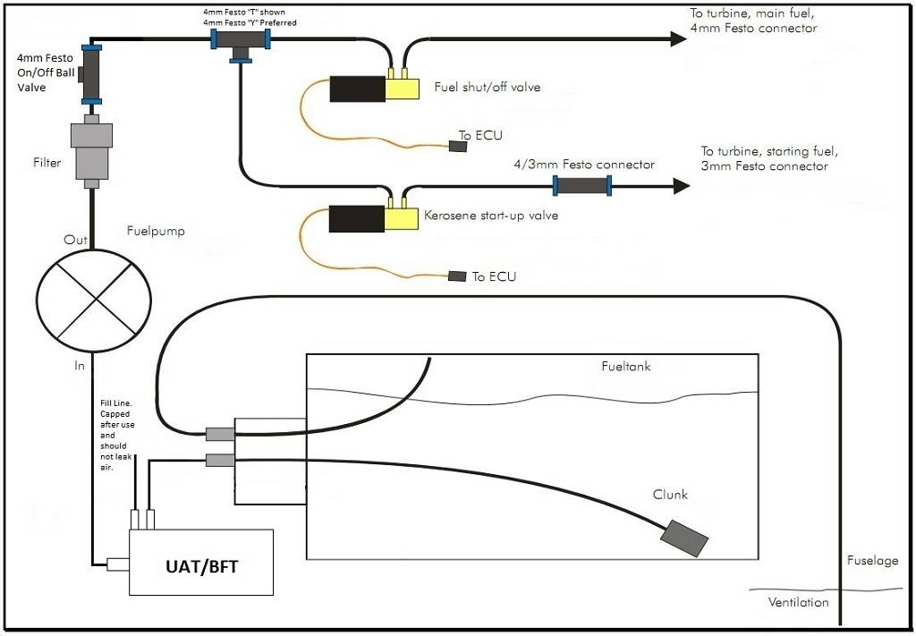

#652
ORIGINAL: jetflyr
I have found that the easiest way is to take a pair of fine-tipped needle nose pliers and put them inside the tubing, stretch, move it further in and stretch then slide it over the nipple. Simple, fast and you can't burn yourself.
Greg
ORIGINAL: Tip22v
SNIP>how do I get the 4mm tubing onto the fuel filter nipples that are much larger than 4mm? The manual says to heat up the ends of the tubing but that still seems like quite a stretch.
Regards,
Tom
Regards,
Tom
Greg
I'll second that! Works like a champ.
I refined the drawing a bit more to help with a little confusion
Mike

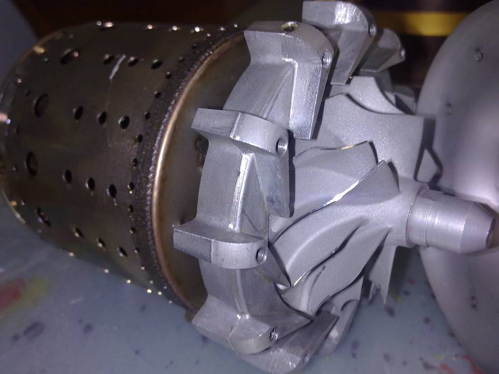

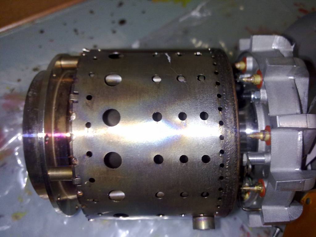

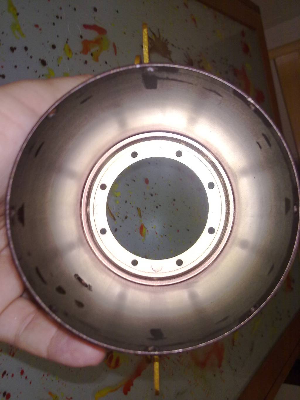

Hi friends:
Really this turbine a more cheap for some reason, but I am very happy with my new turbine, I told that JetsMunt is best because this turbine has pieces from molds and the Merlin is cnc mechanized, only for this reason, I do not want to offend anyone, it's just my opinion, I'm no scholar on the subject.
And please, do not laugh at my english, if you speak spanish forum and you do it wrong, I do not laugh.
I put more photos.
BR from Spain.
Carlos Márquez.

Molds were made in house with CNC machining at a much higher level of difficulty. The reason that the factory choose to invest in mold making is to facilitate production and cost effectiveness in the long run without compromising quality by casting.
Regards,
Barry

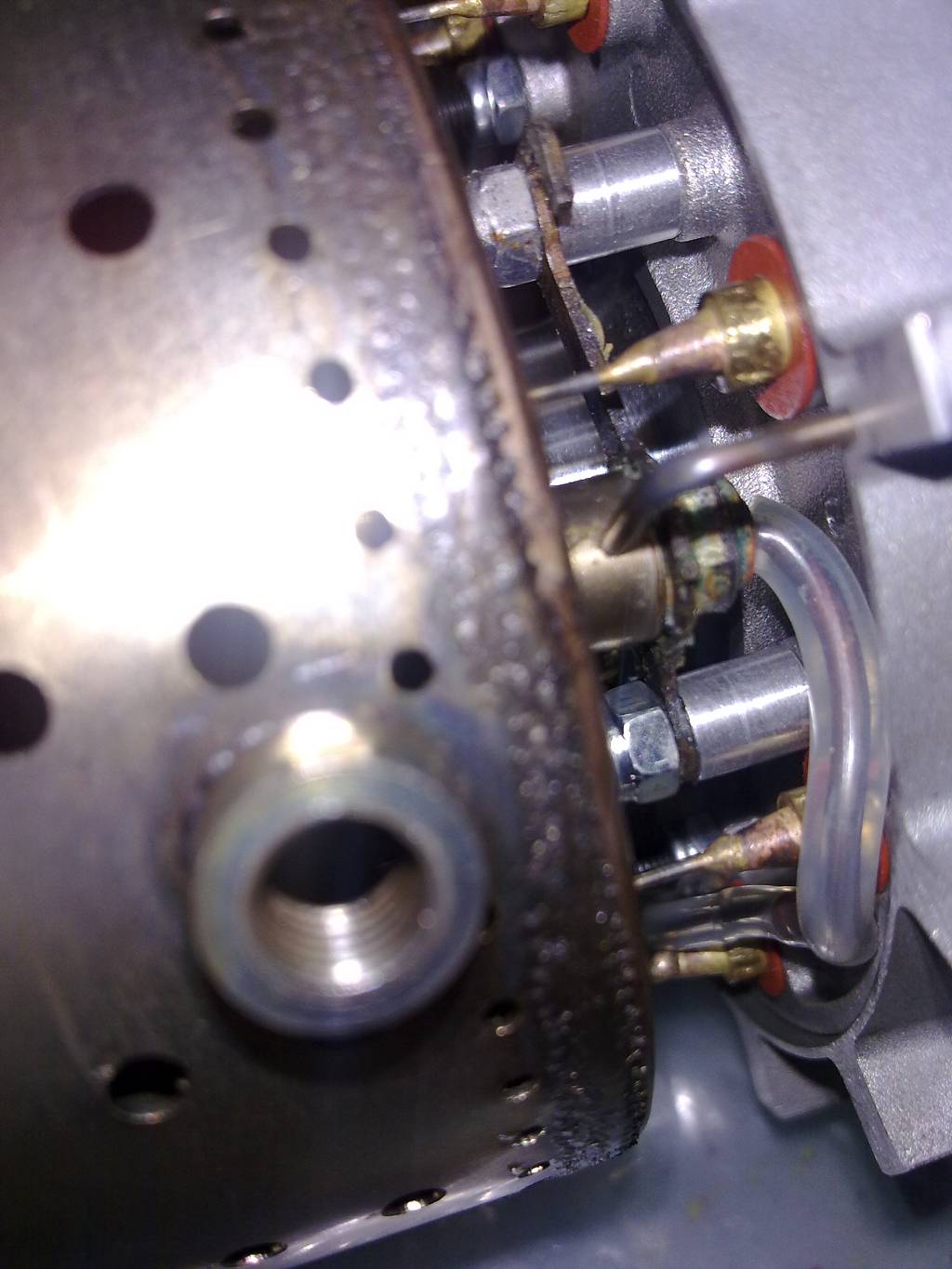

#670
Just got my K80f a couple weeks ago. The Fadec is different from the pictures in the manual. Can someone tell me which way to plug in (polarity) the fuel switch and the starting fuel switch? The Fadec I have is the one where the connectors are on on top rather than the side. The RPM sensor and thermocouple plug polarity was explained in the manual, but I could not find anything about the fuel switches.
Thanks for the help.
Tom
Tom

Hi Megafly, I'm very sorry about this problem. This occurs in a small percentage of 140 and 170s before the latest generation of shaft tunnel is implemented. This temporary binding is only during cool down, once in operating temperature it has absolutely no bearing to its operation and should clear up in time with more temperature fluctuation cycles. Just in case if you can not tolerate it, please have it sent back to the factory for an upgrade. Otherwise, you can count on a good discount on your next turbine if you could "deal" with it in case it's going in a boomerang where flicking the rotor isn't too much a problem. Subsequently, a free upgrade will be easily done during a maintenance service.
Barry
Barry
