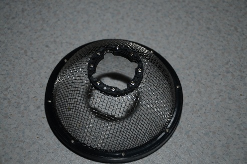

K80 & K140/K170 FOD's now available on our website along with good deals on Turbines

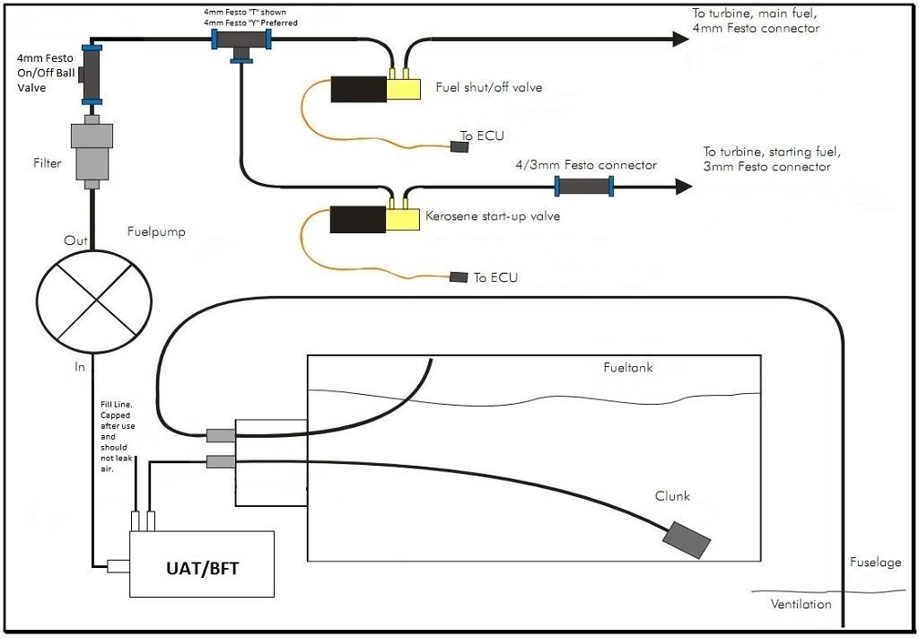

is the turbine fuelline 4mm from the pump to the turbine inlet?
Old 03-05-2012 | 09:27 AM
  #904
mtnflyer14's Avatar
Joined: Jan 2006
Posts: 530
From: Colorado Springs, CO
Default RE: KingTech K-80
The pressurized 'out' line from the pump is 4mm, which goes into a 'Y' and then to the two fuel solenoids. The 'fuel' solenoid continues the 4mm to provide fuel to the turbine; downstream from the start solenoid there is a 4mm to 3mm connector and the 3mm fuel line goes to the start connector in the turbine. I have tried to attach a plumbing diagram, but not sure that it worked..

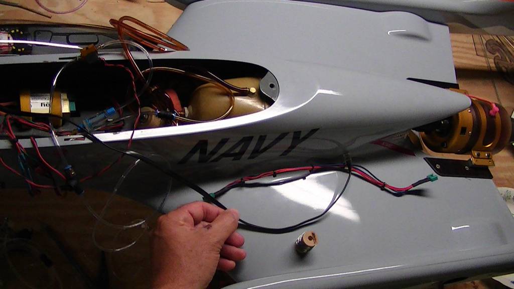

New to turbines, may have some stupid questions, but I can deal with being a n00b, been there enough times.
I'm installing a Kingtech 80 in my BVM Bobcat and I need to extend the MPX lead and the RPM & Temp lead, what is the best way to do this?
Thanks in advance,
Luke
Old 04-05-2012 | 08:37 AM
  #924
Joined: Apr 2006
Posts: 5,962
From: Enterprise, AL
ORIGINAL: dionysusbacchus
.......what is the best way to do this?
Luke, the best way is to move the FADEC and extend the radio and battery lead if necessary.
Old 04-05-2012 | 11:38 AM
  #925
dionysusbacchus's Avatar
My Feedback: (25)
Joined: Dec 2002
Posts: 2,490
From: McQueeney, TX
ORIGINAL: KC36330
Great, thanks. It looks like it would be easy to lengthen the MPX lead, can I do this so that it is the same length as the RPM & Temp lead? It's just way to short as it is, the FADEC would be hidden in the fuselage behind the canopy if I leave it as is.
