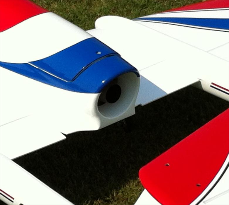

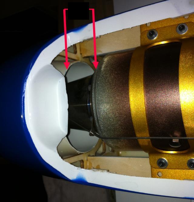

I'm putting the K-80F in a Boomerang Elan; any guidance on how far the exhaust tailcone should be from the end of the exhaust housing on the Elan? I searched the Elan thread and it doesn't look like anyone there has installed the K-80 in the Elan.

I mounted mine about two inches back from the rear edge of the shroud. So far, no burns or scorch marks on the fuse.

Thanks - I appreciate the pics! How does it fly with the K-80? I'm at 6500 feet msl here, but I think it will be okay.

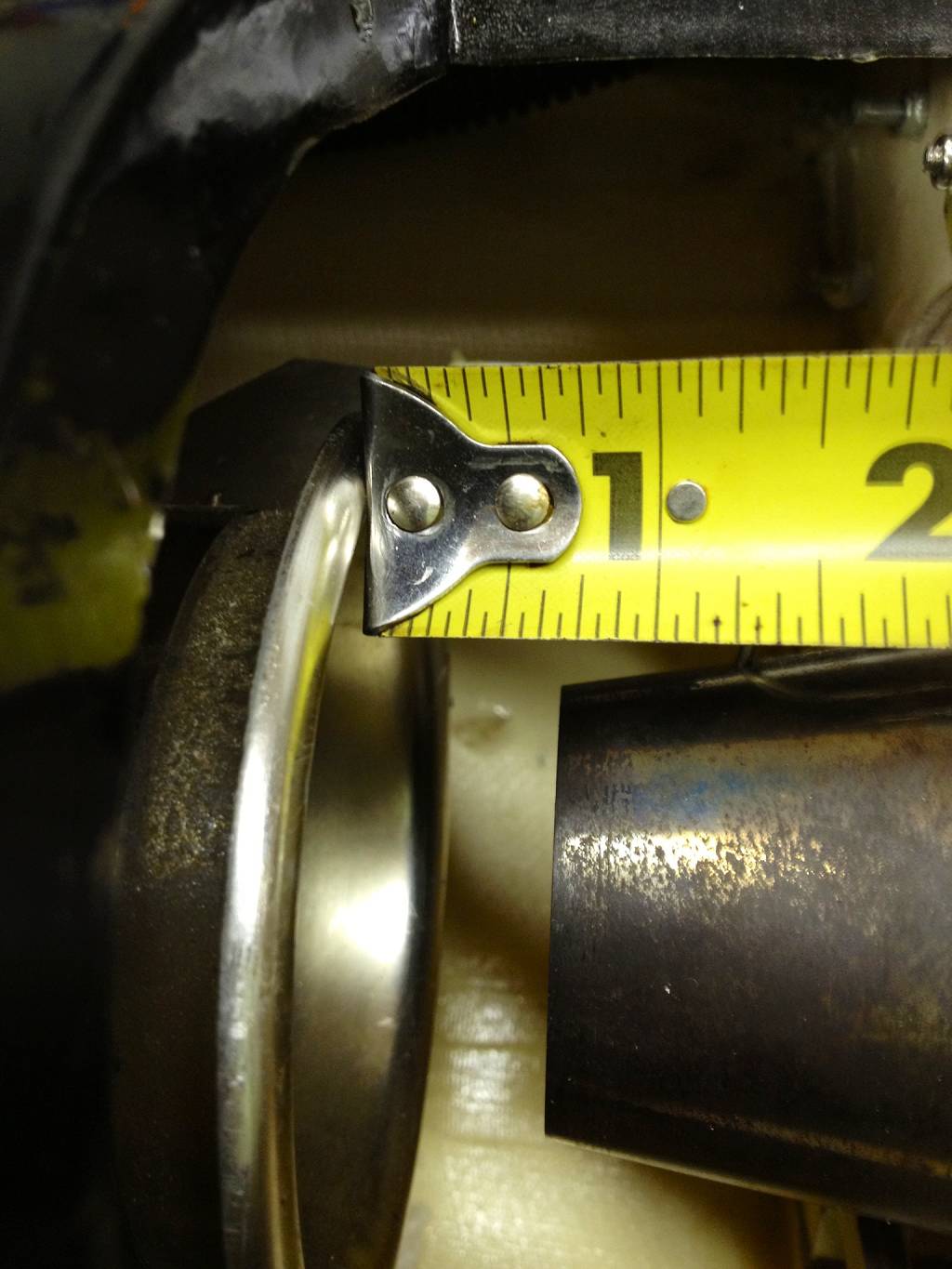

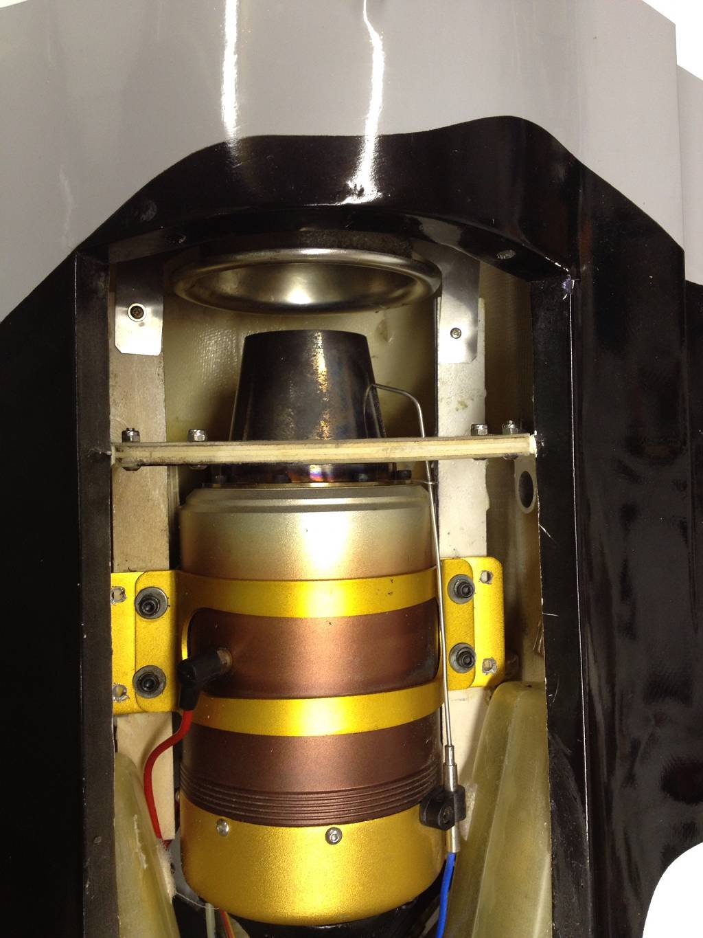

I am putting my K80 in a F-16 and this will be the first time I have run my K80 with a pipe, I currently have it mounted with about 3/4" separation between the mouth of the pipe and the tip of the Turbine... is that correct? See pictures and I appreciate any feedback

Barry may want to weigh in here, but I had about 3/4" from exhaust to bellmouth on my F-86 with no issues. If you look on page 38 of the new (updated Jan 2013) manuals (http://www.kingtechturbines.com/doc/manual.pdf) you will see that they recommend 20-30 mm (.8 to 1.2 "), so you are probably okay.

Thanks for bring it up Gus, but the dimensions from the manual is only a reference. b has over 5/8" from the bell mouth and I would say it should be just fine. I have seen 1/2" being cooler running, but perhaps has to do with the design of the pipe. Basically, once set up, you wanna run it on the ground at full throttle and take a look at the temperature. If it doesn't over temp on the ground, it would only get cooler in the air.
Regards,
