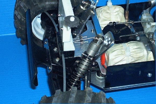

#26

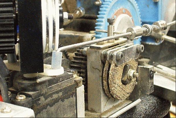

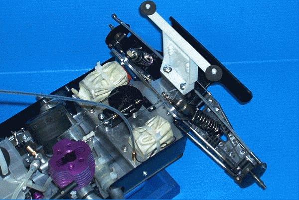

FACTORY REAR DISK BRAKE MODS...
The stock brake system works EXCELLENT as long as guys do the cheap and easy "throttle linkage mod" and for guys that want to try something diffrent you can double up with factory brake pads/disk or most 1/8scale brake disks like those from ofna kits othe others will work too.

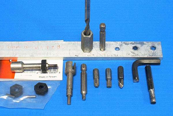

FACTORY FRONT WHEEL TO REAR MOUNT MOD...
For guys that have extra front wheels but need rears, take a 12mm headed bolt...(maybe even a smaller 11mm bolt might work and possibly be a tighter fit on the factory 12mm hex)..., heat it up with a small torch and quickly press it into the inside of the front wheel and quickily remove it, use a correct size aluminum tube as a spacer/insulator for the hot bolt as a guide.

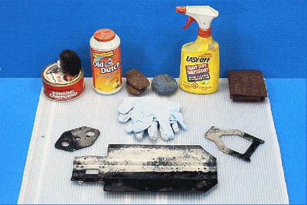

#29
FACTORY CHASSIS/PARTS DRESSUP MOD...
Use easyoff to strip the chassis, sos pads and some rubbing/polishing compound to clean it up, use gloves. The shock towers can be painted with most paints, all white nylon parts can be dyed with cheap one dollar clothing dyes to any color.

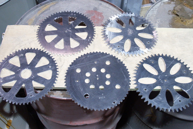

Back on topic, one of the last things I was playing with these kits was casting my own parts like gears, a arms and such. The shop I contract for casts many differnt things/parts and even has a cnc router table to make lots of cool things. I will try to get in the mood to finaly try and cast up a few NTK gears to see how they turn out this summer. Here are some pics of other gears we have cast up recently using rubber and silicon molds. There are so many diffrent kinds of good cold molding plastics and urethanes out now I am sure there are some that are good for making gears now. The silicon molds are also good for hot casting of some metals and nylons too, we have machined out some molds out of aluminum too for high production parts also ... I think some of you will get a real kick out of some of these pics...
I am sure I got a good few parts (I still got lots of goodies) I can sell off sooner or later once I hopefully get back into the hobby, it's a great family hobby but being single again it just does not have the same appeal to me right now so I am going to rebuild some my fullsize "out off date" mustangs this summer lol... beside I can't pick up women or go on a date with my r/c trucks, not even with my new current up to date high tech t maxx lol.

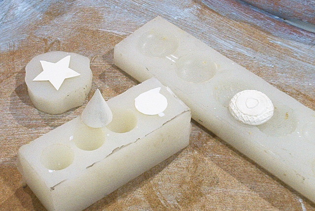

A while back I even played around with trying to make/copy my own body body bucks and parts so I could vacuform my own parts. I even went as far as buying my own little hobby mill/drill/lath combo machine to make some junk at home but now it's collecting dust like everything else lol. Here are also some pics of a aluminum mold which was used for cold poured urethane parts, also some gear sprockets we tryed cutting out on the router table for another project.

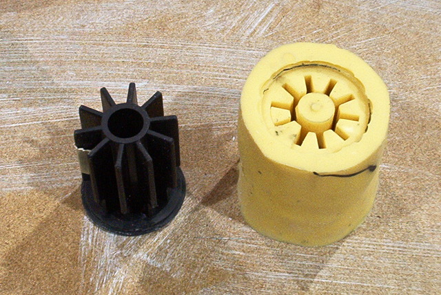

BTW, I remembered to take some tranny gears with me to the shop and made a few quick single rubber test molds, if they work out I should be able to pour some test gears monday night and will post some pics then.
#44
Here is a teaser pic of the ETK/NTK test ball diff gear rubber mold and gear I used, the mold release I used did not work well on this plastic so I am going to try another one but it looks like nice small detailed gears can be made with this stuff. Just got to put some more thought in the setup.

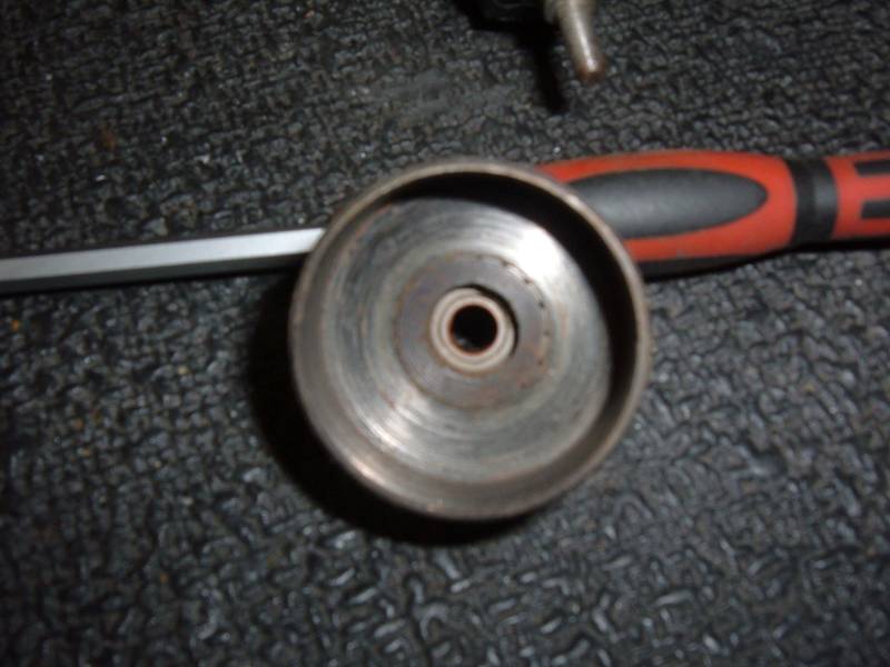

I am taking one of my ntk apart and took some pictures. If you could look at the clutch bell it looks like its breaking apart where spines are inside the bell I had never seen that before and the clutch has seen better days. Also can you tell me if the engine is the org one. It has the blue head and still has some compression also the pipe looks real strange to me I think I will change the engine and pipe. I also will change the brakes to make them work better. She needs some TLC and I am looking forward to spending some time doing it.

The clutch bells on all these kits are a two piece design, the gear teeth are pressed into the bell (this is why we do the bell trick), the clutch bells themselfs are alot bigger than most standard 8scale bells and most all standard 8scale clutch bells will fit inside a NTK one, the NTK bell offers more bite to the bigger teflon shoes but I believe even the standard 8scale 2 shoe teflon ones will work too with maybe a bit of a inside trim. With the two piece bell, gears/ratios can be changed, I have put on some 14 tooth gears on from the factory 17 tooth. Your shoes look worn some but look good/fine to use, a deeped spring grove can be filed/cut and the spring shortend a bit (1/8+) if needed no problem. The blue headed kits were the first batch/versions, the purple head kits were all later versions. the stock sport tune pipes have a long header going up inside the can, all the way up and stop at basicly the stinger, by shortening the can you can change the way/speed the exhaust waves come out the header hitting the end of the can. The first batch of pipes were all welded so they are hard to mod, the newer/later pipes use machined ends/parts and are easyer to mod. The factory rear brakes work excellent if they are setup with the modded throttle linkage (the factory setup is JUNK), if you want to try diffrent brake disks I will suggest the OFNA 8scale ones.
Some times guys have made the mistake of putting the plastic version electric ETK gears into the nitro NTK trannys which uses DELRIN molded gears, they both look the same black colored gears but are not, if you drop each gear seperatly on the concrete floor you will hear a diffrent sound/pitch as they hit the ground... delrin VS plastic.

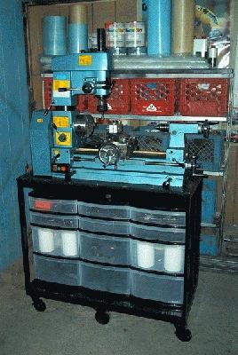

I do contract work in the film/entertainment/sports industry I work on/building things for Disney, movies, film sets, props, I am a bodyman by trade, like doing some mech and specialize in heavy collision and use to build custom cars/bikes on the side.
