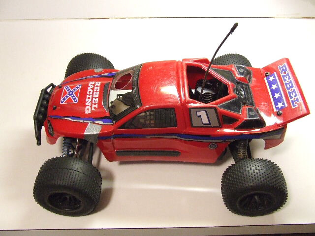

This is a picture before I put my TZ in but you can see my cooling holes. Yes I run a fuel filter but all so there is one in my fuel tank as well. I all so unless we have a heat that last longer then one tank of fuel blow off around my filter cap on my fuel tank with my air compressor before refueling.

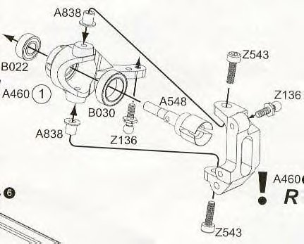

HI guys, i just recently bought a rtr mt2. went to my local track and promptly stripped out the bottom steering knuckle screws. so i bought the alum ones from new era along with the c hubs.
http://www.neweramodels.com/item.cgi?part_id=2635
http://www.neweramodels.com/item.cgi?part_id=2129
so im putting them on and i cant get them to work right, if i tighten down the 2 screws all the way i am unable to turn the steering knuckle. if i dont tighten them down all the way, the scews work themselves loose after just a few turns of the knuckle. im using blue locktite(threadlocker) and am using the two little "bushings" that were in the stock plastic hubs. am i missing something here? should i use some red threadlocker and leave it just a bit loose so that it actually turns? i am afraid that if i tighten them down all the way my servo will not be strong enough to make the wheels turn.
thanks for your help[sm=confused.gif]

Are you using the bushings that the screws go through? Do not use red loctite on RC trucks use blue red is way to strong for these small screws!

yes, i am using the stock metal bushings that go through the c hub. it allmost seems like they aren't quite long enough, i was thinking that bending the c hub together just a bit would fix it but i dont want to screw up my nice shiny $24 c hubs...

If they’re to short I do not see where bending is going to help. I can only guess since I do not have them in front of me but either I would try a new set of bushings or relive the C hubs a little. I have the alloy knuckles but am running the stock C hubs. I try to keep my MT as light as I can.

it seems as if there's a little too much room between the knuckle and the c hub, so if i bent the ends of the c closer together, there wouldnt be as much space. i was thinking either that, or stick a small washer of some sort in there.
when i tighten the screws down completly i cant turn the knuckle at all, if i dont tighten them down completly, they loosen up allmost imediately.
are the scerws supposed to pivot with the knuckle or stay put with the c hub?

Should be the same for Alum.

thats exactly how i have them setup. im stumped...

They should turn with the knuckle in the c-hub they are like bushings. If you bent the c-hub then where you put the bushings will no longer be parallel with each other. A washer sounds like it should work if you can get them in there. The reason I suggested new bushing is I have seen the ends get smashed from over tighten and this would make the bushing shorter.
