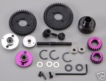

Yeh that 2 speed is what I run in my truck. YOU WILL NOT WANT TO USE THE CLUTCH BELL THEY GIVE YOU.
I think those stock purple pinion gears are 18/22 which is pretty high up there. Also the stock spurs are 47/43 I believe.

I run this CB
http://www2.towerhobbies.com/cgi-bin...?&I=LXM729&P=7
and I run either 52/49 or 49/46 gearing with the .18 CV-R.
If you do want to use that clutch bell that comes with the 2 speed you will probably have to get the gold pinions which I think are 17/21 and probably have to run 52/49 spurs. I'm not sure the slots in the chassis are big enough to let you adjust the gear mesh though. I'm also not sure how much acceleration you will have. Top end will be crazy though if the motor has enough umph to get it up there.
Also a warning, the 2 speed has no slipper. When your clutch shoes are expanded and connected to the clutch bell EVERYTHING is connected. Just take that into consideration if you go off road or jump it.

#8967
The gearing it comes with will probably be to much gearing for that motor. It won't have much acceleration and won't be able to get to its max rpm. It comes with a 18/22 cb. Most everyone is using a 13/16 cb. That is a HUGE difference in gearing.
