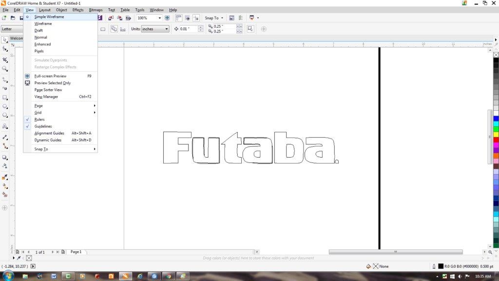

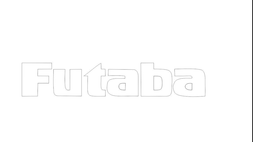

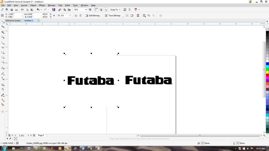

Here's an overview of how to take an image off the internet and convert it to a vector file to send to the plotter. Keep in mind a JPEG image must be converted before we can send it to the plotter.
The first thing I did was Google "Futaba" and just right click and hit "Copy" on the image I wanted. I then open Corel Draw and "Paste" the image.
The next step is to hit "bitmap", then "Outline Trace, then "Detail Logo".
This will now create a vector file from your JPEG image.
The original image and the vector file are displayed side by side. I just drag the original JPEG off to the side to work on the vector image. After the image is converted they will need to be cleaned up. This is a very simple image and won't require a lot, but some take some time to clean up.
When we zoom in on the image, we can see some raged edges and extra lines that need to be removed.
You can see the rough edges and lines that need to be removed even clearer when we zoom in closer.
I use the "Virtual Segment Delete" tool to remove the unwanted lines with just a few clicks. I now use the "Shape" tool to highlight the nodes. When we convert a file, it will have extra nodes that need to be removed. All that is needed to remove them it to double click them and they are gone.
You can see the lines of the image are not all straight. We just click on the node and little arrows will come up. All we have to do is maneuver the arrows to smooth out the lines.
The image is now ready to send to the plotter.
This whole process took about five minutes, but it was a very simple conversion.

OK you owe me! I spent about an hour downloading the trial program that you did to see if it is different from mine and it looks the same.
The important thing is you need to copy a JPEG. You might just do what I did and Google Futaba and then click the "Images
tab in Google. Just find one of the basic Futaba logos and right click and hit Copy. Now pull up a new "desktop" in Corel (File/New). When you have the desktop up on Corel, just right click and hit Paste.
Now that you have a JPEG on the desktop, go to Bitmaps at the top menu. Go down to Outline Trace and then hit click on High Quality Image.
If you don't have a JPEG on your Corel desktop, Outline Trace will not be available.

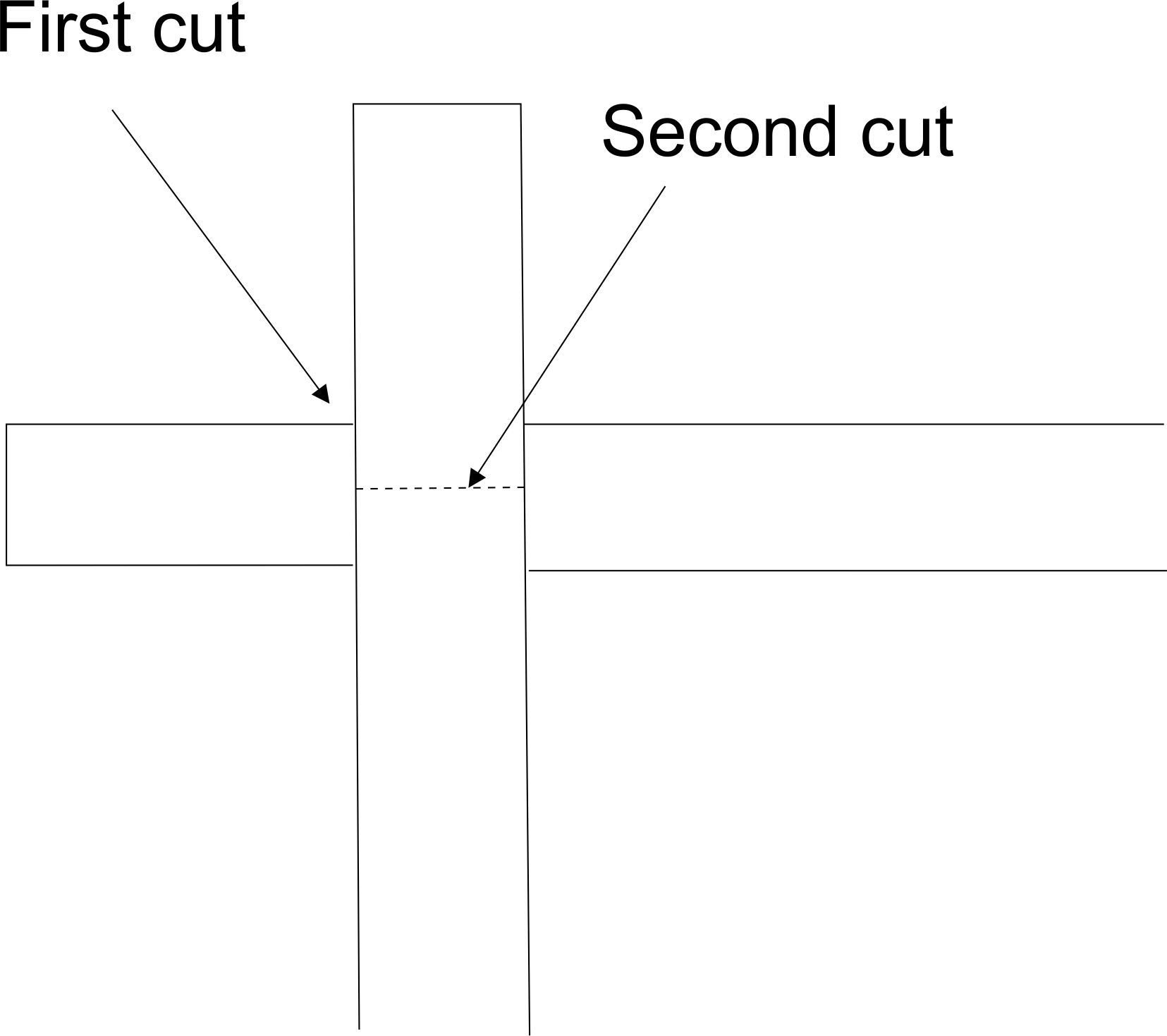

Here is a great tip on how to get clean outside corners when masking. A lot of guys really struggle getting a clean cut. This is what you want the final cuts to look like.
Here is how to do it. The first cut is on the tape on the bottom of the overlap. Just cut against the top tape. The second cut is over the top of the underlying tape. Here it is:
Here is another one.

OK on cutting the tape. Good question. I am testing you guys to see if you are reading this stuff!
What I do is use a new number 11 or a razor blade and just score the surface of the tape very lightly two or three times. Then you just hold the blade in place and pull up the tape into the blade if that makes sense? In other words don't slice all the way trough the tape. Do the same on the other cut. That being said, we are working on very fragile surface and we are going to get flaws and dings. The car and motor cycle guys don't have the same issues. I may be working over a bipe wing for fifteen to twenty hours total and stuff happens. I am kind of at the point now, that if it's a big ding or it bugs me too much I fix it, but the little micro stuff, no way. The reality is, you are going to be the only one that sees it. I have said it before, you better do this stuff for you, because, no one else cares (or very few do). I probably spend about thee to four hours fixing little stuff on a bipe wing and I could probably spend twice that and still have flaws.

I copy and pasted this JR logo and converted it in about 10 seconds.
The bottom one is the converted vector file and you can see it needs to be cleaned up a bit.
