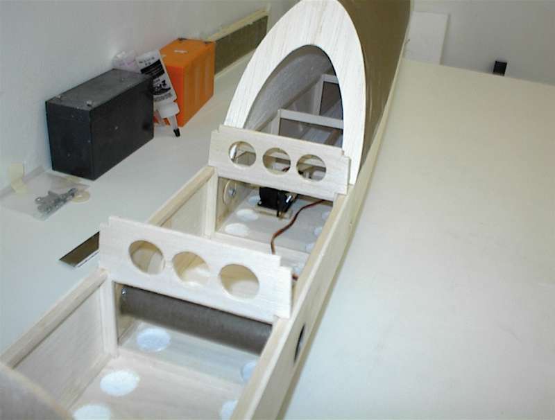

I'm installing the elevator and rudder servos behind F-4 and the battery also. It is rather tight to get to the elevator servo in there, but I will need the weight back there.

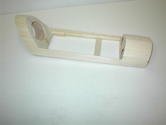

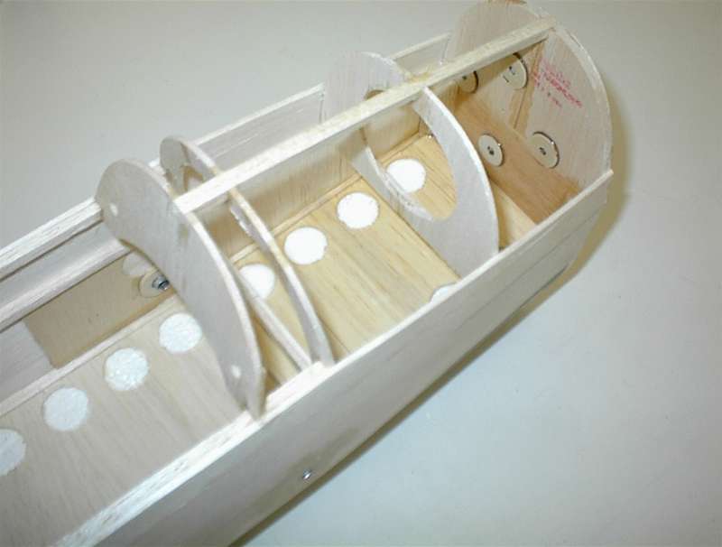

To get the curve right at the front end I'm using Mike's advise to add one more former between F1 and F2.

Just for comparison and to know how much it would weight I also cut the front end from foam, but then it is a straight line.
Weighted 18 gr

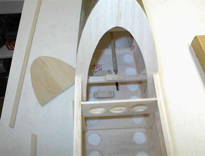

The frame for the canopy is almost finished. Now I just have to sheet the front end and get the plane ready for covering.

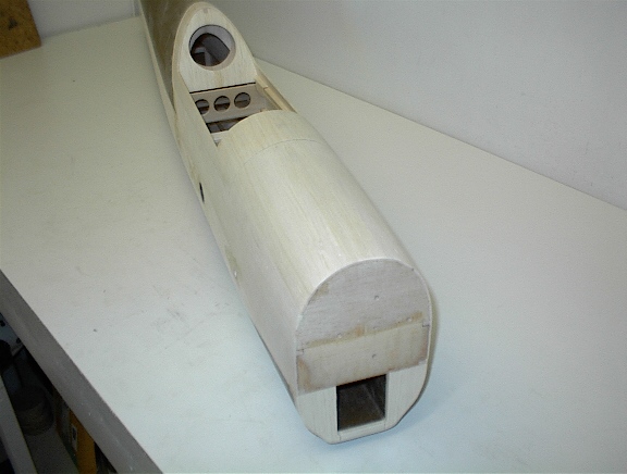

I have sheeted the rest of the fuselage.
