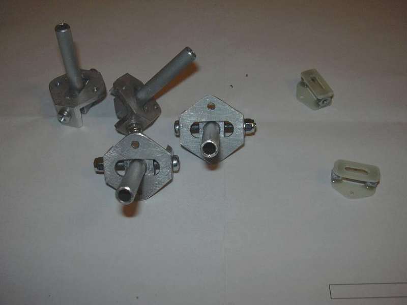

I'm ready with planking the fuselage bottom side. I made wing and stab adjusters, and hyde mount and special engine mounting are in progress.

Just trowing my spoon into soup as well... Ata, why not shave a couple of grams from your hyde mount:
Picture tells more that my limited english can tell:
edit: here is my "hyde" for 160FX and similar version bolted on Syn 90 ARC (I´ll try this without nose-ring, rubber is same on both)

Hello Jatik,
my engine has rear intake and a Walbro carb, so I had to make such a big metal frame. But there is a good thing what I liked, the engine will be well mountable, you can see 3 bolts in easily reachable position. The hyde mount is lightened out (plywood), I think the whole assembly has up to 10-15 gramms overweight only.

Jó estét kivánok,
Yes if your Aluminium part is 50 gr. then hyde part must be around 68 gr.
Petrol engine ... are you putting in ZDZ40RE or MVVS ?
Szia!
Szia!

My engine is like the first, but methanol version. Rear intake rear exhaust, ~750g, with different Walbro carb.
I glued the tube sockets into the fuse and mounted the homemade wing adjusters. The vertical stab glued on too, and I started planking fuselage upper rear section.

I finished setting up the adjusters. The fuse rear is planked, it needs a lot of sanding. Before I apply the second sheeting of wing I should make the wing retainer hooks. Could somebody give me any idea how should I make them?
