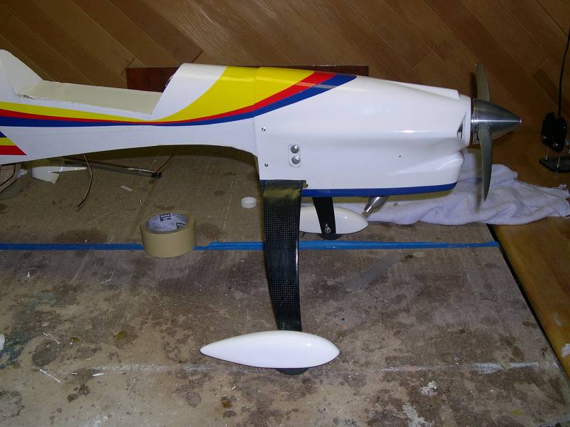

Here are some pics of the LG and my work so far. Let me know if you are interested in the LG

I think I am getting the hang of this, more

Looking good jap101 - where did you get the LG?

One of the guys in my club has some sort of connection with someone who manufactures them. I will try to contact him today and find out how to purchase them.
I used the stock tank that came with the kit

Looks like the LG is mounted backwards.

Hey Barye
Actually I noticed that the LG might be mounted backwards also, but since I already drilled the holes and it makes no difference which way it mounts ( it not angled in either direction) I thought I would leave it. But, now that you noticed it I might change it.

Lets take a vote, change or not to change the LG
