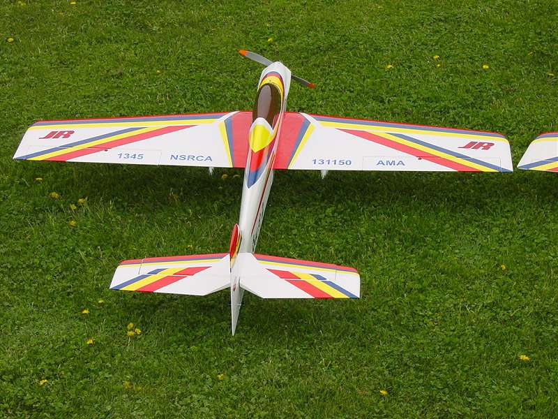

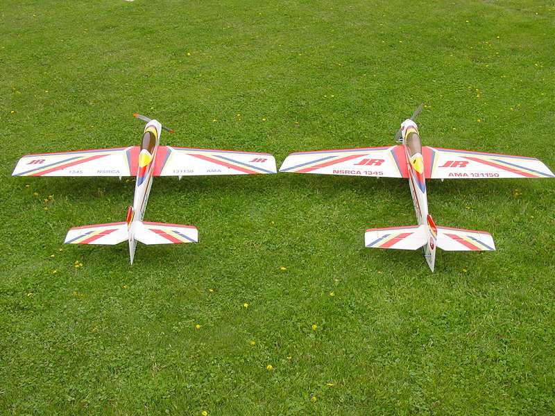

Got them both out at the field today. Put # 2 son on the buddy box after a 3 year lay-off. Within minutes he was doing KE's and reverse KE's. A bit of a strain on the buudy box finger but he had a blast.
Here are some side-by side pics etc...

Old 04-29-2005 | 11:20 PM
  #95
Eric.Henderson's Avatar
Joined: Sep 2003
Posts: 1,413
From: HENDERSON, NV
Default RE: NEW QUEST
couple more
