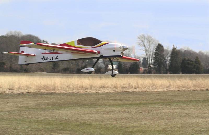

Almost finished. I put a ST 90 in it with the head at the 7 oclock position that makes the muffler
centered on the bottom. Put the rudder and elevator servos all the way up front. used a carbon fiber arrow shaft for an elevotor pushrod, the throttle servo is on the motor mount. the battery is up against the fire wall. the receiver is on top of the fuel tank compartment. I moved the motor out to 140 mm. but it should all work. It looks likes it going to be right at 8lb. So it looks like it will be a good intermediate/pattern trainer for me.

I finial finished the pane, it balance at about 175mm back from the leading edge of the wing and that is with a heavy brass prop nut under the spinner. so I went out early this morning to break in the motor and fly before the wind pick up. It was about 10-15kts and a cross wind,it seem like it was dropping so I tried a flight, and would you know it, the wind pick up.
The ST90 ran real good and pulled the plane around quit nice. From 1/2 throttle pulled to straight up and added full throttle and the plane just when straight up. I don't think it is enough motor to do all the 3d stuff I see people do. But the combo is just great for me, and it flys just like I wanted it to, a perfect intermediate plane. I cannot figure out how to get my D/R on rudder to work on my JR radio so I only used a little Rudder deflection, but it was enough to do a very nice knife both upwind and downwind. I did one of those thing where you add full down and let the tail flip over the top. It worked. I am very happy
