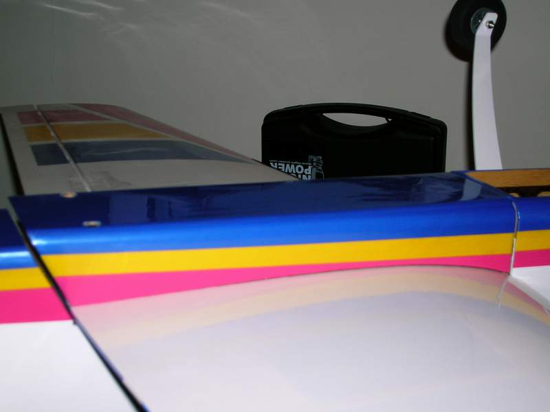

Anyway back to the Oxalys discussion. One of my ailerons has some warp, I had the same problem with my H9 Showtime. I'm a bit unlucky with ARFs lately. Anyway I'll see what I can do with it tomorrow.
Here's is a photo prior to assembly.
Rgrds,
Nick

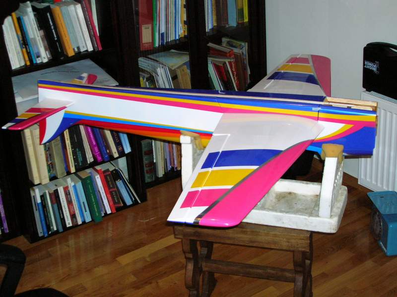

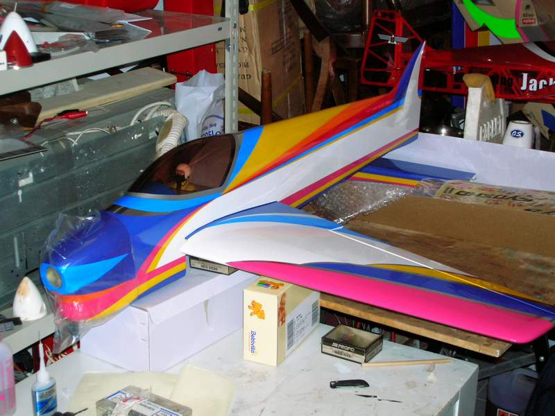

Yes I'm getting there
. Hope to finish it soon. Here are some photos of my progress. This fuselage is pretty wide. Seems that modern pattern designs have very wide fuselages. Fin is not located very high with respect to the fuselage axis, this must be related to roll or pitch coupling may be. Just compare with my Robber Saphir I 60 on top of the photo, no comparison in the design philosophy.
Can someone give us an explanation of this design tendency?
Rgrds,
Nick

Here are some photos of the belly, you may have some problems with your manifold , have a look at the 2nd photo. You propably have to reconstruct this part in order your manifold to pass through.
