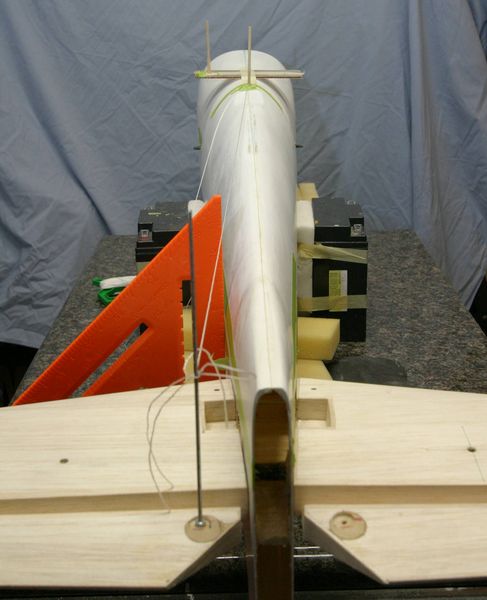

I wanted to share a technique I came up with to help determine where the exit holes should be on the fuse.
In pattern planes I’ve installed three pull-pull rudders and one pull-pull elevator. I’ve been able to reliably determine where the exit holes should be top to bottom, using a similar method to Troy’s above, however, I can never reliably determine where the exit holes should be in the front to back dimension. Above Troy demonstrates a method he uses with a ruler and eyeballs. Well, for some reason I can do this five times in a row and get three to four different results. This has to do with the angle at which I look at the ruler in reference to the fuse.
So I got to thinking, how can I make sure I’m looking at the correct angle? There’s got to be some way to measure this.
That’s when I realized that a string between the two end points, elevated above the fuse, and a square was the solution.
Hopefully the pictures below will be sufficient to explain the technique.
Keith B

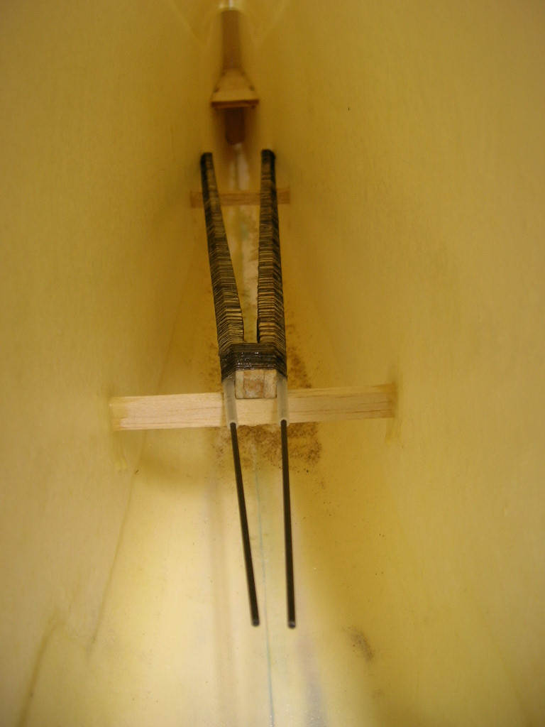

They do bend slightly, right at the hollow rod, but only very slightly. All you need to overlap the 2 pushrods with the hollow rod that connects to the servo is about 1", thats it... The trick for me to keeping it smooth was to set it up so that the point at which the pushrods exit the clear tube is several (maybe 4-6") inches back from the servo arm. That way there is 3-5" of clearance for the pushrods to slide without hitting the curved portion right at the joint.

Ooooooooh no not that one!!!! My support was crooked if you look close!. I went back in and fixed it since then....
Let me qualify my statement and stress that ...
the point closest to the joint of the three rods that actaully travels into the plastic guide tubes must be STRAIGHT!
If there is any bend at all in the portion that slides in the guide tubes it will bind up some. Just take your time and think it though and it will be fine... If a dummy like me can do it,,, anyone can do it![8D] If you get it just right the pushrods will slide as freely through the tubes as they do when you pull them out of the bag and test fit them..
I go through it in my Genesis build thread and explain my personal experience installing the DEPS. I got a lot of help from Troy and some other folks that really helped me to get it right...

Nope, I just used a heavy sewing thread. I think kevlar would be ok but it would be overkill. Once I had it all laced up and ready I just lightly went over the wrapping with thin CA to secure everything in place.
Actually the pushrods were arrow straight except for right at the head end near the servo arm where it all came together..... but that support that is holding the two pushrods up,,, yuk! It was about 1/2" lower on one side than the other,, but I fixed it.

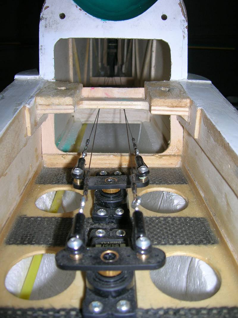

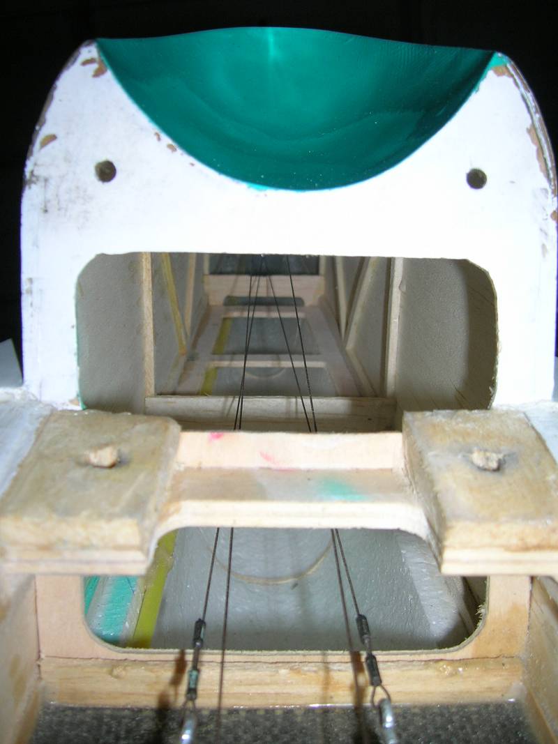

Yes, you cross wires on the rudder setup. It allows you to get the exit holes further back in the fuse. Think about you rudder servo sitting in the tray. Draw two mental pictures. One from the left side of the rudder to the left side of the servo arm. And then draw it from the right side of the servo arm. You will see the difference and it should make sense.
I have had no problems with the wires touching and I was using control line cable. Now I use a fishing line called sevenstrand. 90# coated stainless steel. They have easy to us connectors and also a special crimper for them.
If you don't want the wires to touch mount the servo on its side and have a little different exit hole heights.

Here's a pic or two of the crossed cables.
