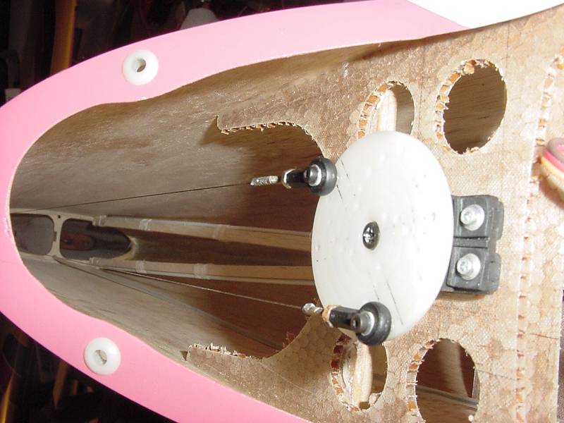

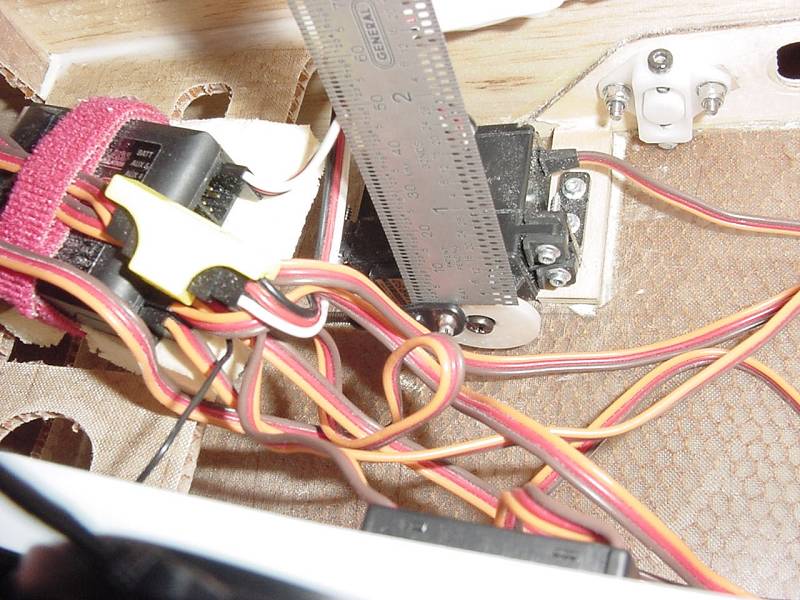

Step #1 Mount your stab, elevator control horns, elevator hinges, and Elevator servo with the control horn. Everything must be mounted up and ready to go. Use masking tape to hole elevators in trail at zero with stabs.

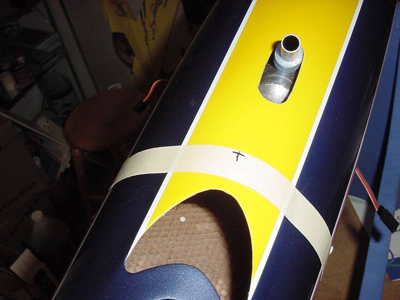

Step #2 we are going to project the servo horn location to the side of the fuse.
a) using masking tape and eye ball the tape in place vertically on the side of the fuse. Use the edge of the tape as your straight line.
b) Measure the depth from a fixed point to the servo connection. Not the servo arm screw but where you will connect to the servo wheel. In the photo my system is already installed to show you what it will look like.
c) transfer this depth measurement to the masking tape and I place a horizontal segment of tape to help this marker. You can use more masking tape, and a sharpie thin tip marker....Or you can play it a little loose and use the intersections of the tape as your cross hair.

Step #3 Use the straight edge to run from this side cross hair point to the elevator control horn. Make the line go directly through the elevator horn clevis hole.
Use masking tape on the side of the fuse at the rear to mark this line. I start about 10 to 12 inches ahead of the stab and go to the tail post. This insures I have the right spot covered with tape. As before you can put the tape down and then draw a sharpie line on it or use the tapes edge as your straight line. I use the tapes edge.

Step #4 is the tricky eye ball part. You need to project the servo wheel connection point onto the belly of the plane. My models have the servo mounted so that the elevator connection point is in the middle of the fuse with the servo on its side. There are lots of mounting options to get the servo on its side. Some guys use aluminum angle and cut it out for the servo on one side...The bolt the servo to the angle and then bolt the angle into the model. I use some fancy BVM aileron servo mounts.
I carry the vertical tape line around to the belly of the fuse and mark the middle of the belly location.
Then sue your straight edge to project the "V" or the angle the pushrod will have with the side of the fuse. This is where you may need a helper...Or maybe not. I eye ball from above where the intersection of the ruler and the fuse side is at the rear and I mark it with my sharpie pen.
I then use a dremel cordless tool and a small bit to make a hole in the fuse side.
NOTE: since the fuse is painted here is where you can screw up your paint. Put masking tape over every place you are going to cut. Make a small thin slot first. Then test fit.
Note#2: I no longer attach the 1/4" balsa sticks to each other. Nor do I wrap the entire length of the sticks anymore. This is overkill. I just lay the sticks with tubes attached into the fuse and span the gap.
Using a small rat tail file open the slots up to accept the pushrod inside its sleeve. This is why the teflon sleeves work good in this application is the O.D. of the sleeve is smaller. Basically if it is binding up the length of the slot needs to be enlarged.
Also you will need to file at an angle like the pushrod will be exiting to get the taper on the slot correct.
